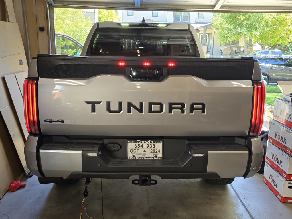

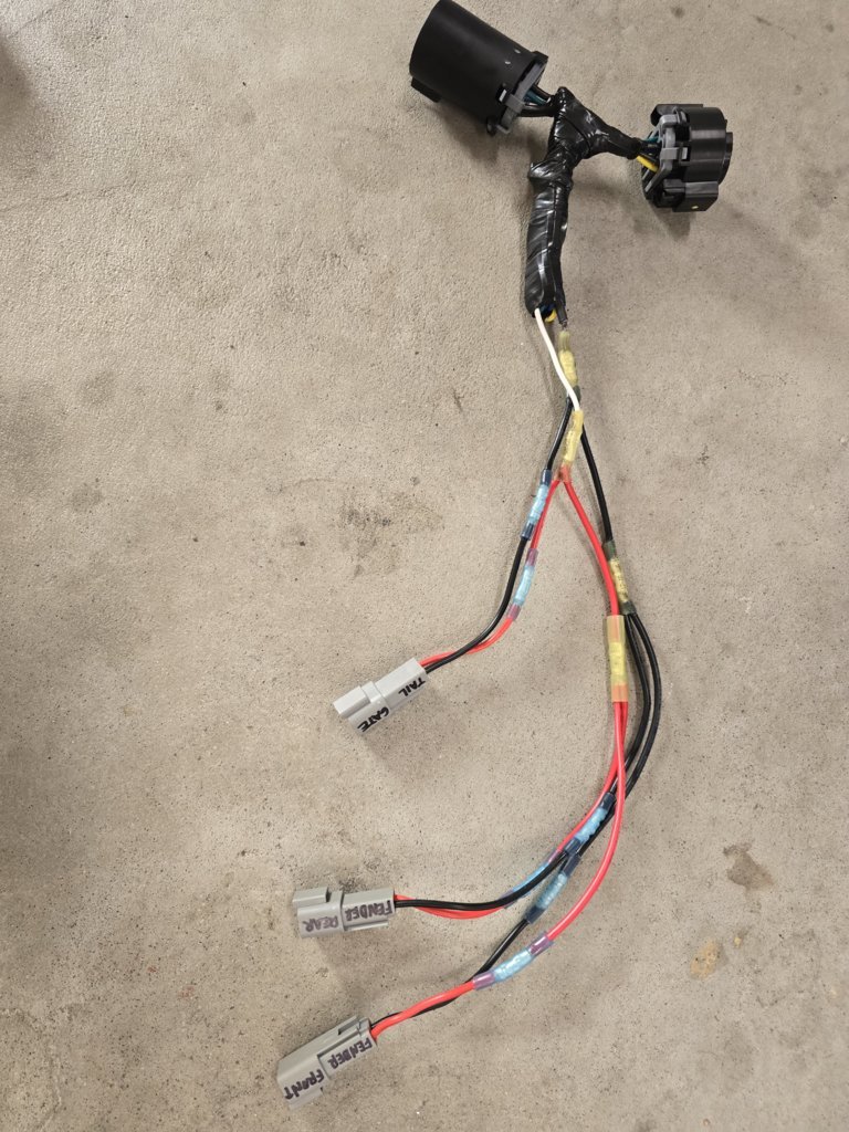

  12. Sep 12, 2024 at 6:38 PM
    joshua32
    joshua32 New Member
    Sep 11, 2024
    #122770
    63
    2024 Celestial Silver Platinum HV TRD OR
    Haha! I'll take a stab. When I installed mine, I used the Rave harness and ran the wire on the inside of the tailgate to the wire loom between the tailgate and the bed. The pass through connector on the tailgate and the bed comes apart. I don't have pictures of it but can take some if absolutely needed. I ran my wires through there, closed the pass through back up, then tied into the 7-pin harness on the backside with a 7-pin T adapter to add a 5-pin trailer connection. I used the brown and white wire for the marker lights and ground.
