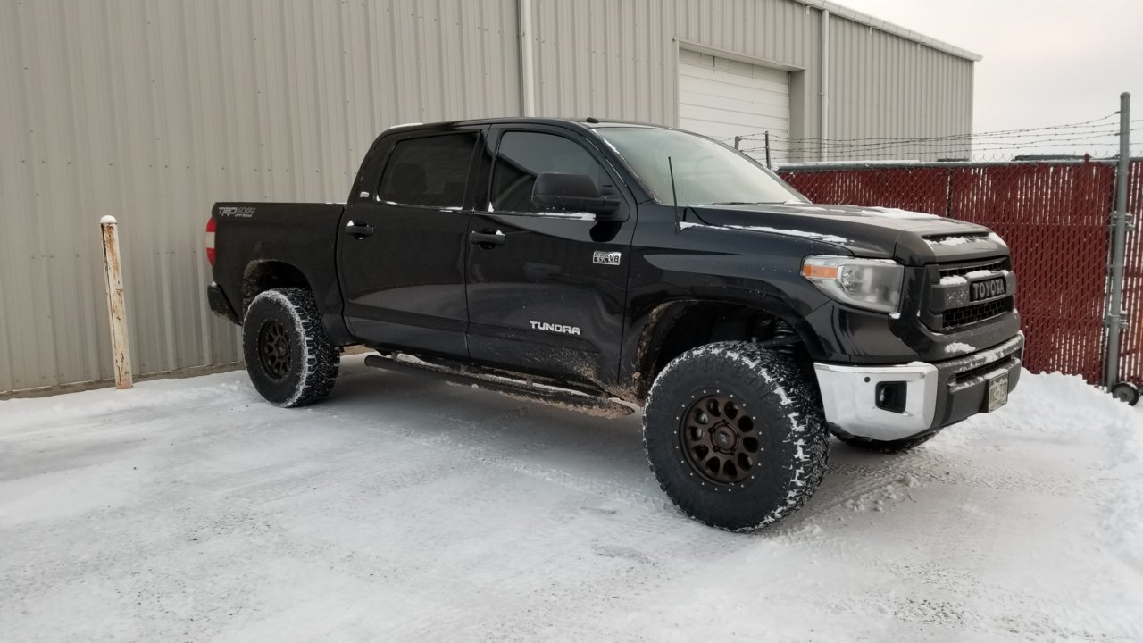

    I'm on ToyTec Boss up front and back with ToyTec shackles set to the middle. I'm considering raising it to the top setting as my truck looks like it MIGHT be a little lower in the back. It's so close, it is hard for my eyes to tell. I believe the middle is 1" and the top is 1.5" if memory serves...
    T-Rex266 likes this.
  9. Mar 14, 2018 at 7:36 PM
    2010bigdog
    2010bigdog New Member
    Mar 10, 2018
    #13453
    1,434
    Chuck
    Chicago
    2018 MGM SR5 TRD
    can you post a picture of your truck?

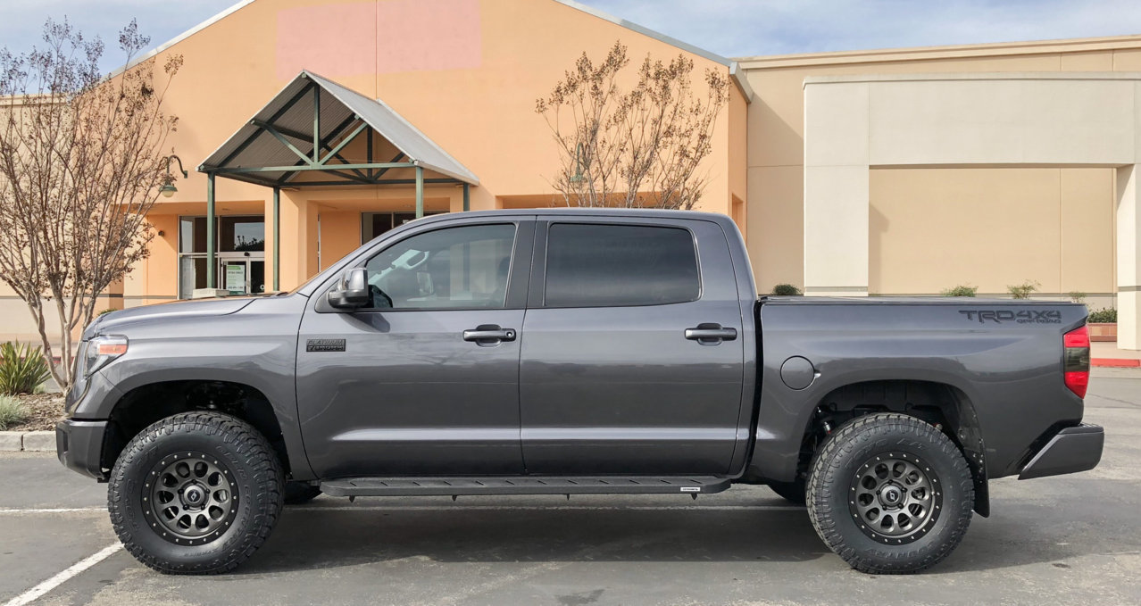

    Coach builder +3 shackles. Nets about 1.5-1.75” of lift.
    I’m at 3/1.5 lift with my setup.

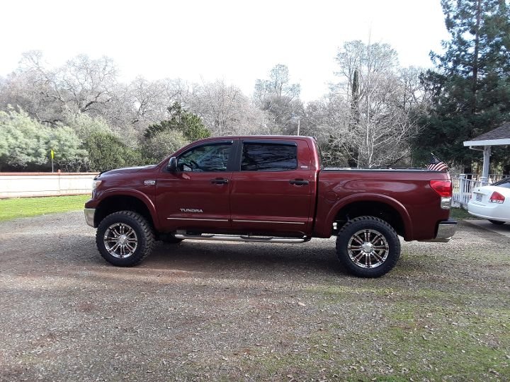

    fabtech 6'' lift with dirt logic coil overs. 20''wheels 35'' tires. dual flow master exhaust, K&N intake, rear air bags.
    tundra.jpg I had the same prob with mine, sat a tad low in the rear, went round and round with the best way to level it. for me it was air bags. its level, rides real nice and helps when I pull the trailer. best all around set up for me, under a 100 bucks for 2,500 lb bags.
