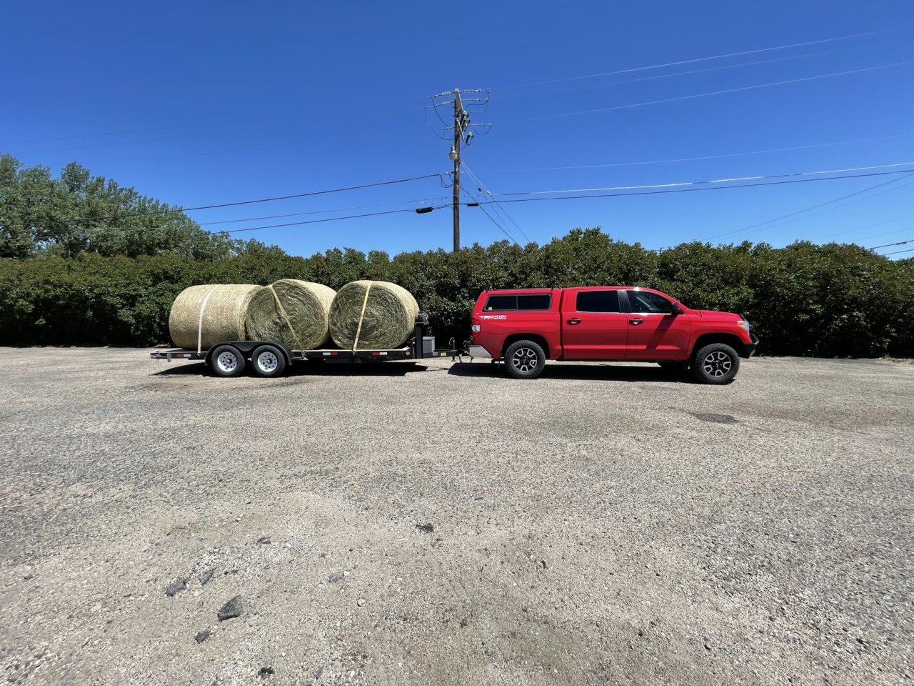

    I tow fairly often. Anywhere between 1500lbs to 8200lbs. As far as rear end mods I only have Toytec rear shackles on the lower setting and Toytec IFP shocks.
    Weight distributing hitch is out of the question. Three different trailers.
    I am considering airbags for towing. My only concern is even with Daystar cradles are they still worth a shit for off roading? I feel like there could be issues when stuffing the tire clear up in the wheel well. Educate me.
    Here’s the roughly 8000lb load.

    Are the Toytec shocks the same extended length as stock? If they are, you’ll be fine w/out cradles if you’re running minimum pressure in the rough stuff.
