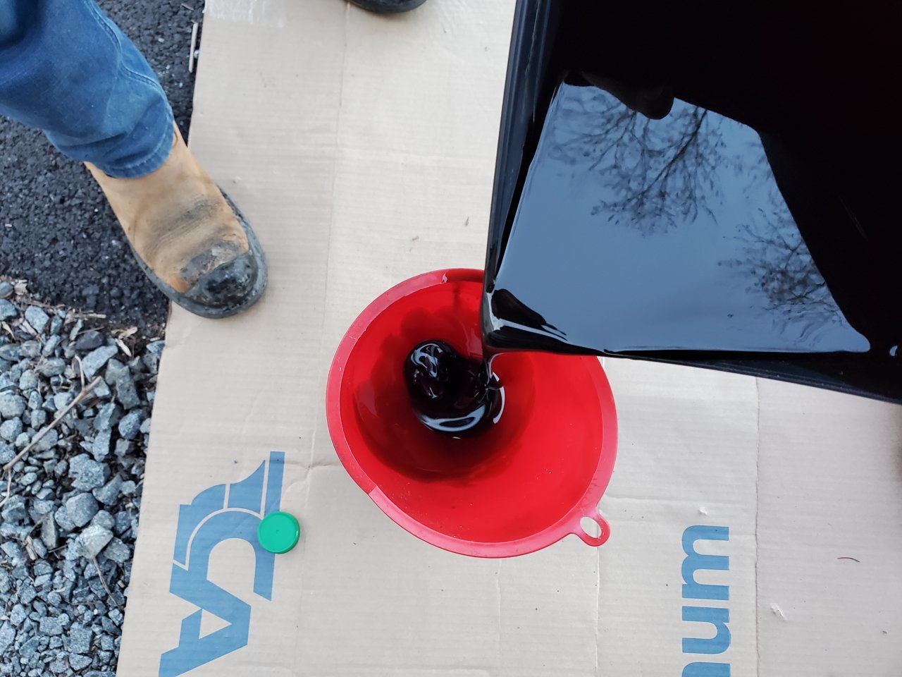

    So...I just purchased the Tundra with about 8.5k miles on the ODO. The Carfax said the truck was just serviced by the dealership (no clue what they actually did). So I just got some AMSOIL goodies from @lewi3069 and decided just to switch over to the good stuff. Well I was absolutely amazed at how black the motor oil was. Currently, the truck has 9.5k miles and by the looks of the oil I am assuming it hadn't been changed yet. SO here's a picture. What do you guys think?
    Does this oil look consistent for having 9.5k miles of use?

    That looks about like mine after 5k or so. Toyota recommends 10k oil changes. The dealership service could have been the free tire rotation at 5k. I’m assuming yours is not a ffv.

    Yep you assumed correctly it is not a FFV. Okay, I was just super surprised and don't recall my oil in my Tacoma to look like that. I guess we'll see what the next change looks like with AMSOIL syn + filter.

    This could dangerously spiral into another 10k really? Thread....lol
    While the questionable oil is dark, the 10k synthetic oil and filter rotation is perfectly fine.
    Look at all the million mile Tundra service records that were posted online. Two separate trucks.
    No harm in earlier changes or Amsoil either...just saying.
    Good call in changing it though.

    Looks a bit dark to me. Makes me wonder what was in it.

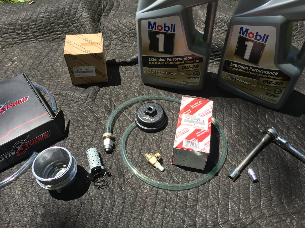

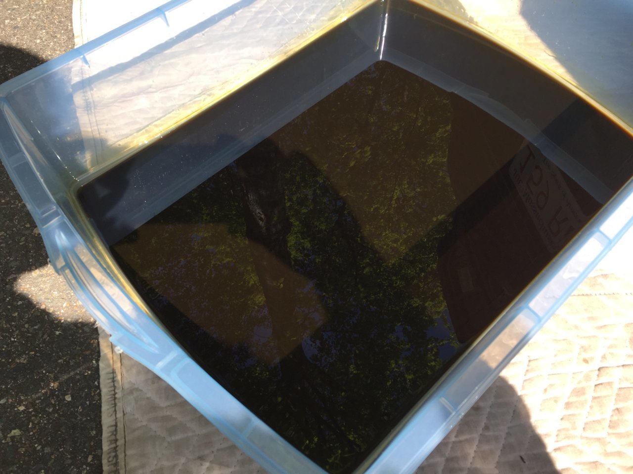

    This is what my oil looked like at 700 miles when I did the first change after break-in. Pretty black for relatively new oil. So probably hard to tell how many miles on the oil by just looking at it.

    I’m guessing an oil analysis is far more indicative of the remaining quality of your oil than is the visual appearance, unless you have antifreeze in it.

    After 700 miles?? Wow now that I wouldn't have seen coming...I suppose it makes a lot more sense for mine to be that dark if it hadn't been changed yet at all.

    Color means nothing.. Oil is a lubricant and a conveyor of dirt to the filter, so if it discolors, its doing what is was intended to do.

    Wow so here's the oil analysis. I thought they'd email me but turns out it was on me to look it up. Only thing the oil showed was a little higher silicon level...maybe others out there can read into it more than I can.

    Silicon is dirt intrusion, leaky air filter or the like. TBN is 5.2 and everything else is ok, still a useable and viable lubricant.
