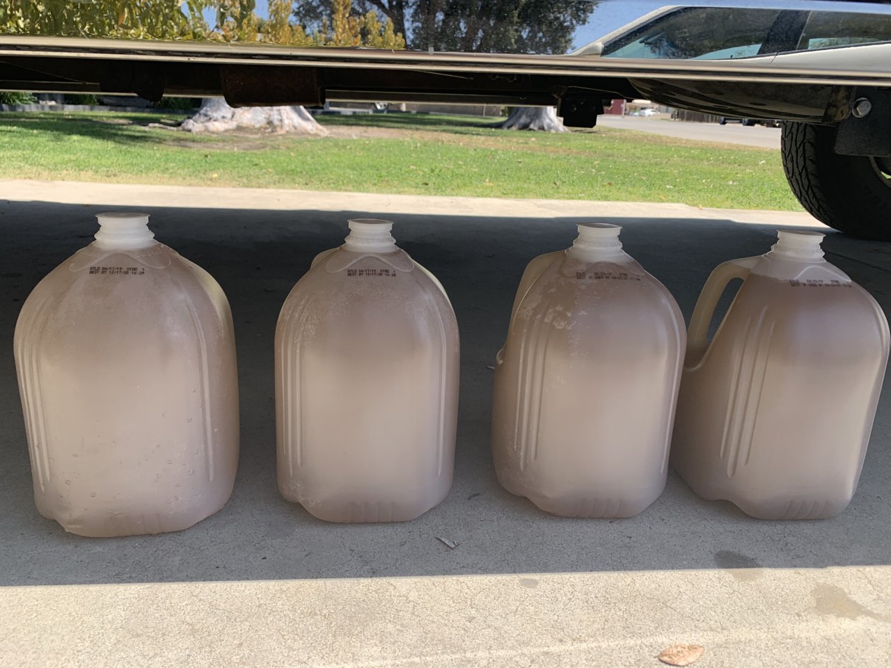

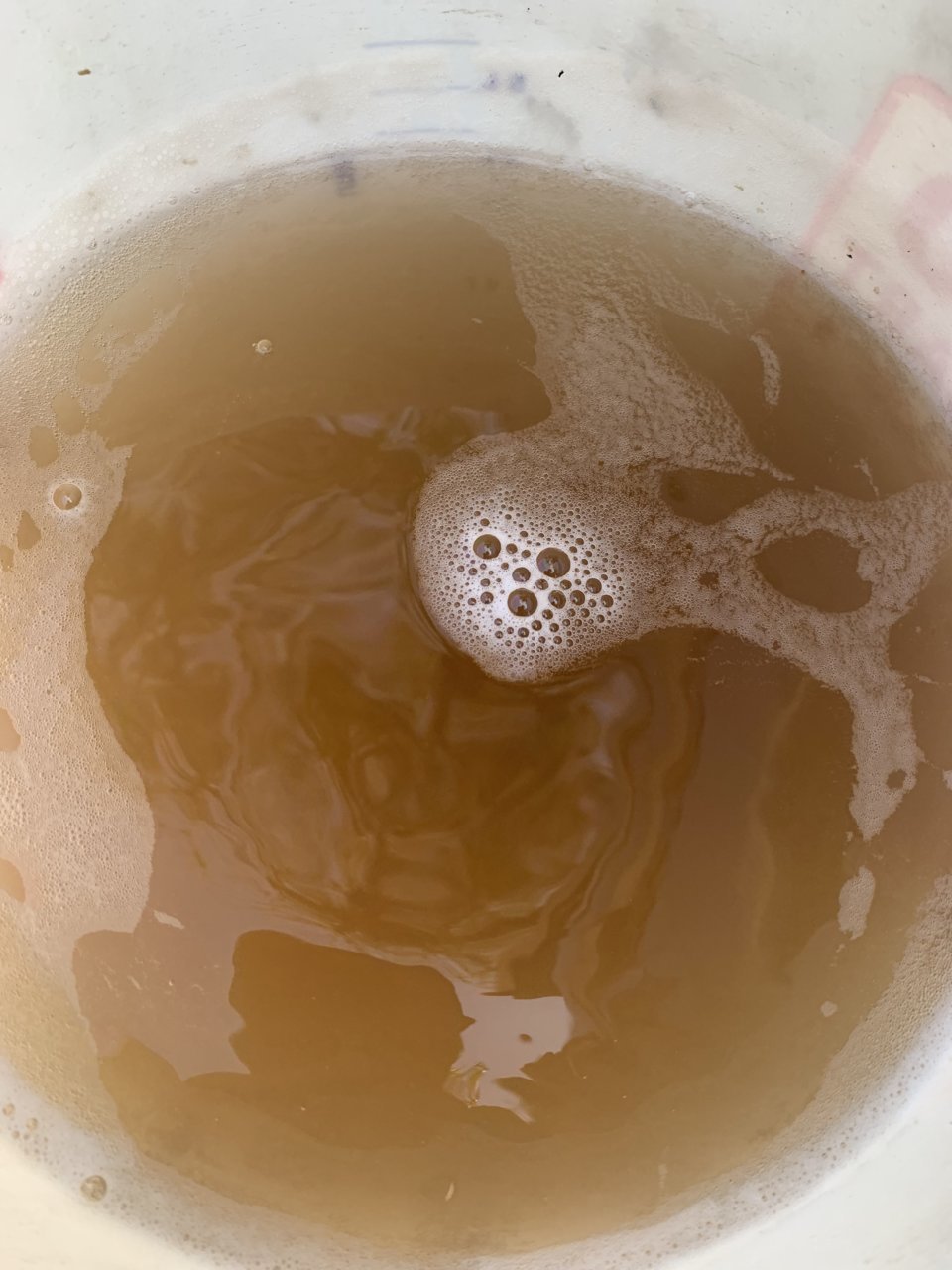

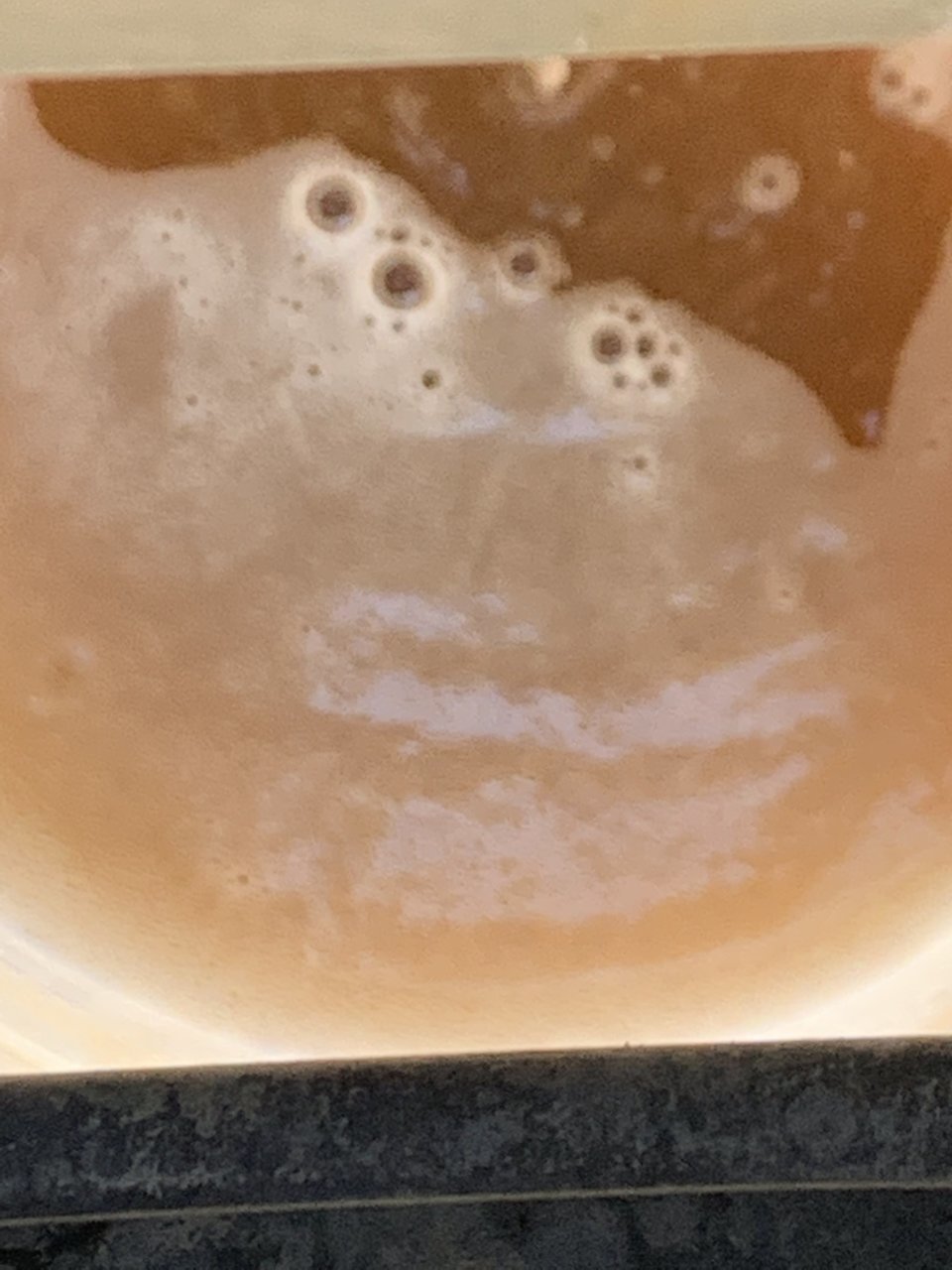

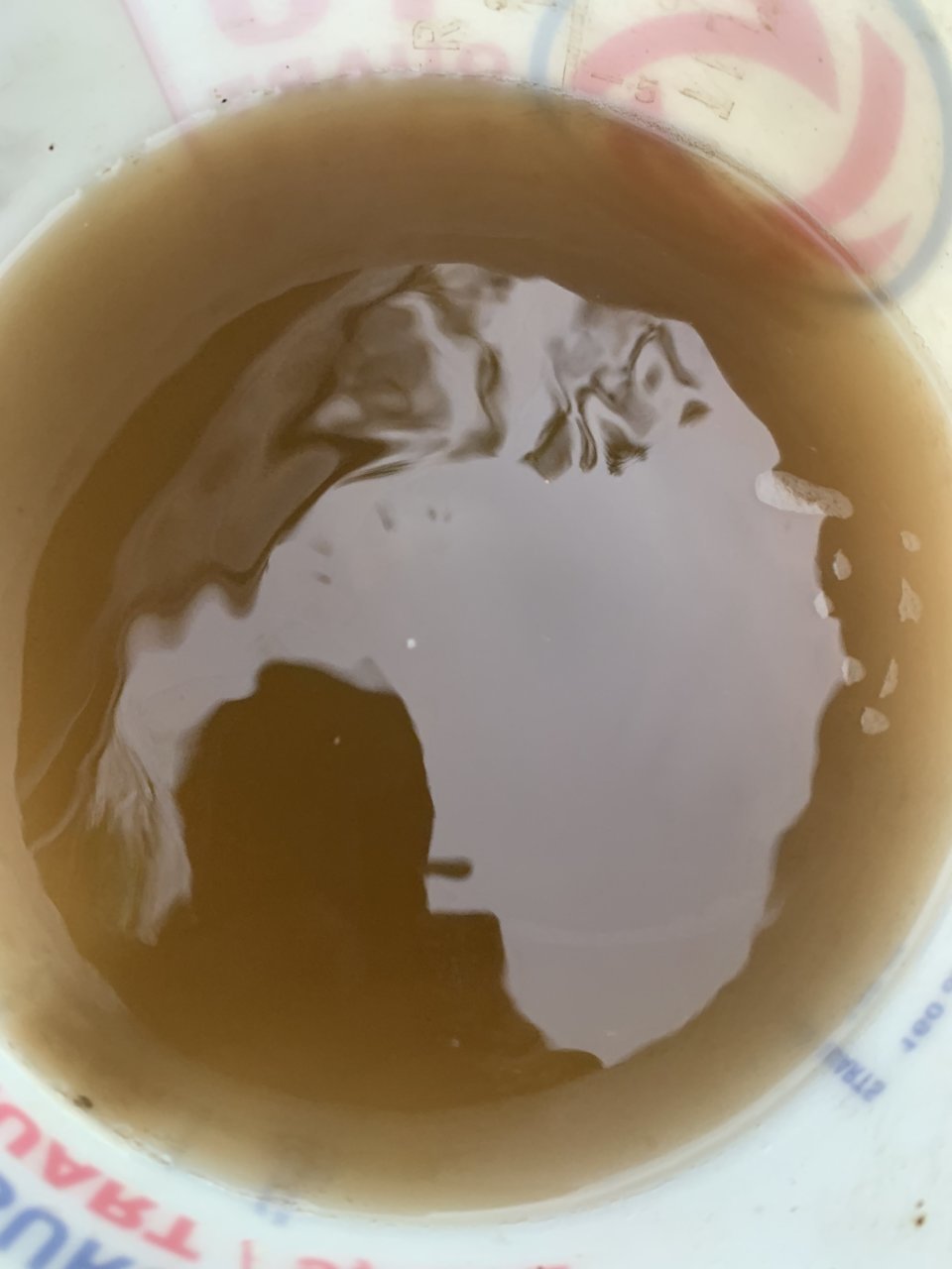

    So.
    The original owner only used water in his cooling system. I decided to flush it. Using A flush chemical, and letting it soak. I drained the first that included the flush.
    Has ran distilled water through it 5 times. Each time letting it run to operating temp then running the heater. Drain refill , and repeat.
    The water is starting to come out cleaner, but is still pretty nasty.D6A57E46-C1A3-4266-8FE4-0EB5EA99B5EF.jpg6E3DFC3A-8616-4D09-A0D1-282D89A93F6C.jpg7CE5F9B3-F316-4A2B-ACBC-7B08AA4D33E5.jpg1FB46ABC-9A2B-4F7A-9956-47F89D9949D7.jpg23A7B3C6-3A5D-4BA8-92CD-F1D66121CB8C.jpg

    Right the jug in the pic on the far left is from my 5th flush. Pretty close
