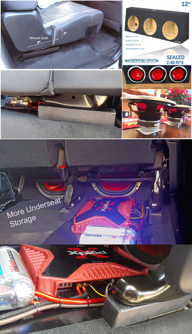

    There was so much room in the rear I could sacrifice a couple inches here an there.
    I raised the seat off the floor 2 inches and pushed it forward 3 inches. That gave me space for 3 standard sized subwoofers of 7" in depth. Still far more head and leg room left than a double cab.
    I used 2" square tube of .12" thickness and the existing bolts as mounting points.
    1200 watts Hits like a train!

    Yup,,, I like it!!!!:)

    Yes! I had thought to move the seats forward but didn't think to raise them, great idea.

    I just removed the rear seats. I never used them anyhow. And it gives you loads of room to work with.
