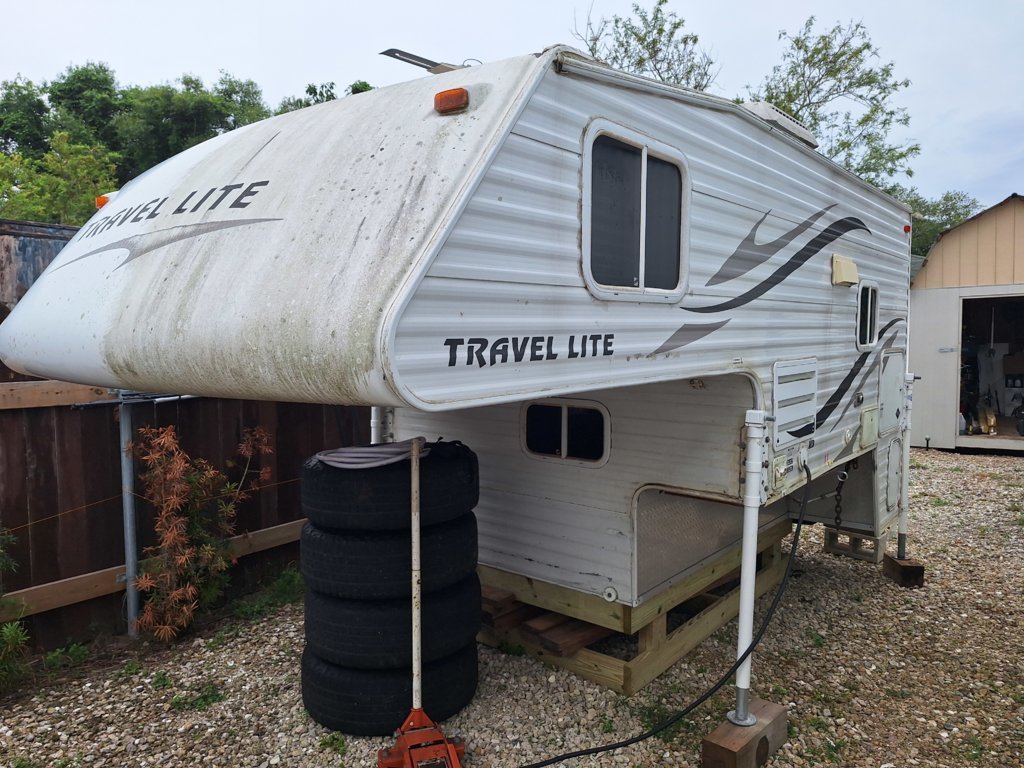

    Stupid? yes. Insane? maybe. Definitely an embarassment to my wife. In a month we're taking a two week roadtrip to Canada for our honeymoon.
    Instead of doing the logical choice of taking my car and booking airbnbs that we usually do, I've decided to take a dilapidated truck camper I overpaid $2500 for and shoving it in the back of my equally shitty Toyota.
    But I'm not a complete dummy. Both need work before we hit the road. :laughing:
    On the way home from digging it out of it's grave in some old fart's backyard.

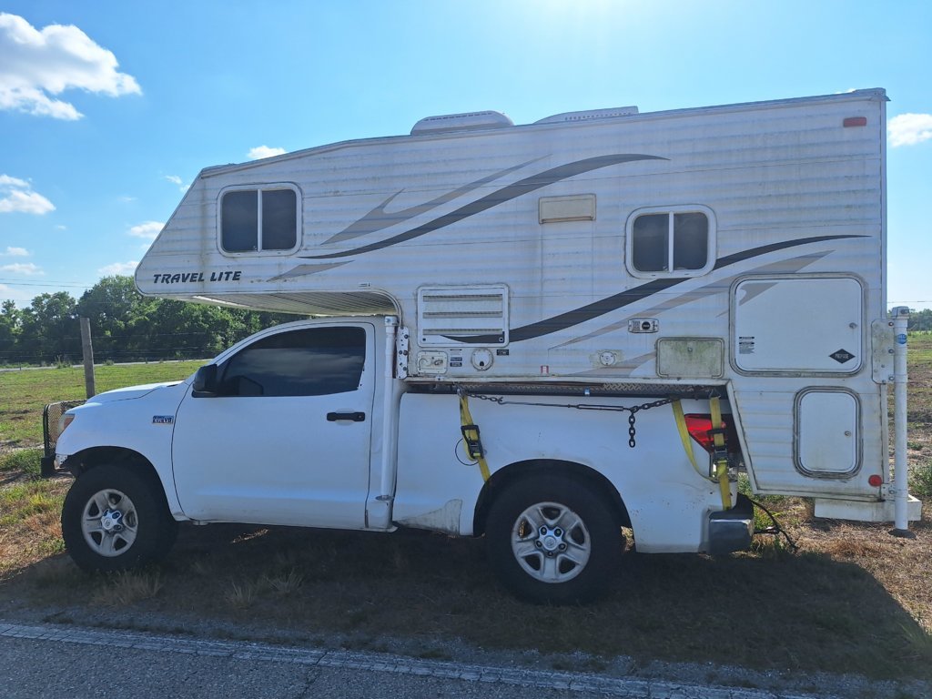

    Look at this beauty. A 2010 Travel Lite 890 SBRX for a 6.5ft bed. Queen mattress and a wet bath. Surprisingly everything still works as far as i can tell after sitting for 4 years, so it' ll probably stop working the day we leave.

    Seriously. That thing weighs like 2500# loaded.

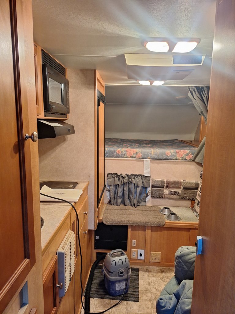

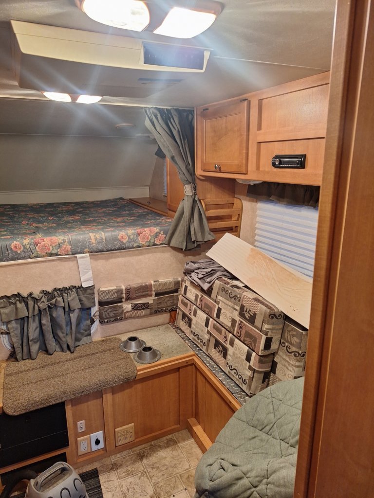

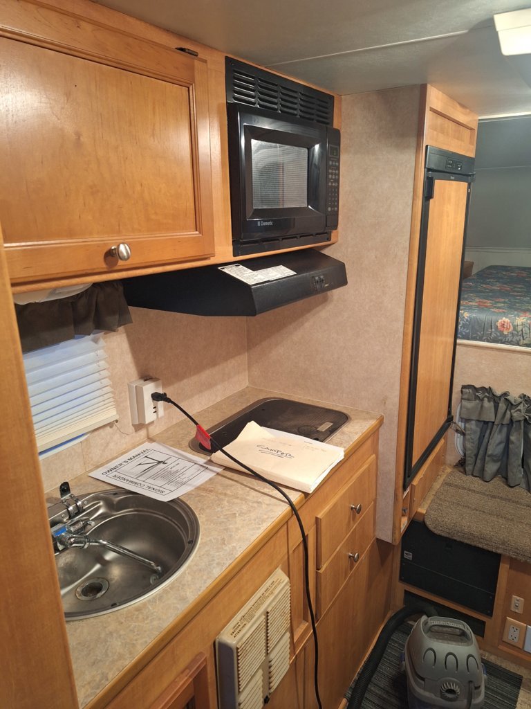

    Inside isn't bad actually, but i'll be cutting holes to fix some of the rot.
    Just needed a cleaning and i swapped in LED bulbs. Powerwashed the cushions and mattress.

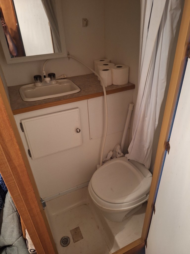

    Sure you got enough TP?

    That's for the first time he gets hit with a stern cross-wind, or overtaken by an 18-wheeler.

    Sticker says 2000 loaded.
    I have a set of airbags, a sway bar, and rear wheel bearings waiting to get installed when my add a leaf finally shows up.
    Front end already got new wheel bearings and a set of brakes yesterday

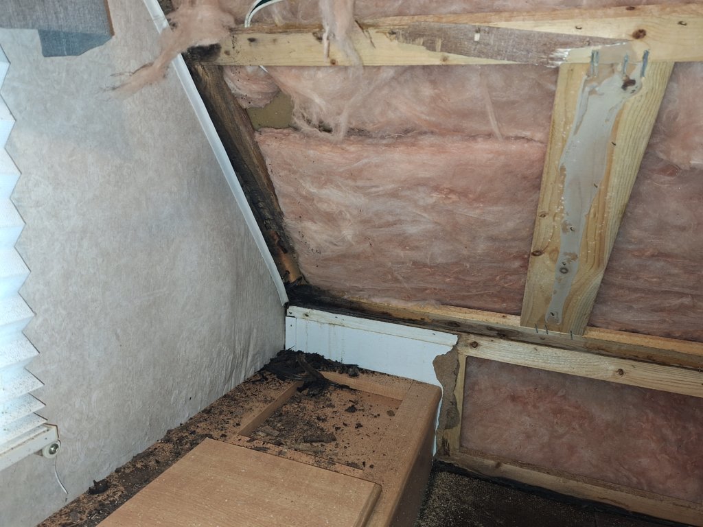

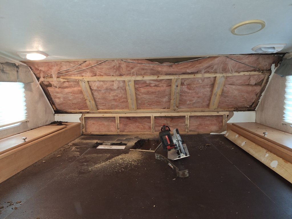

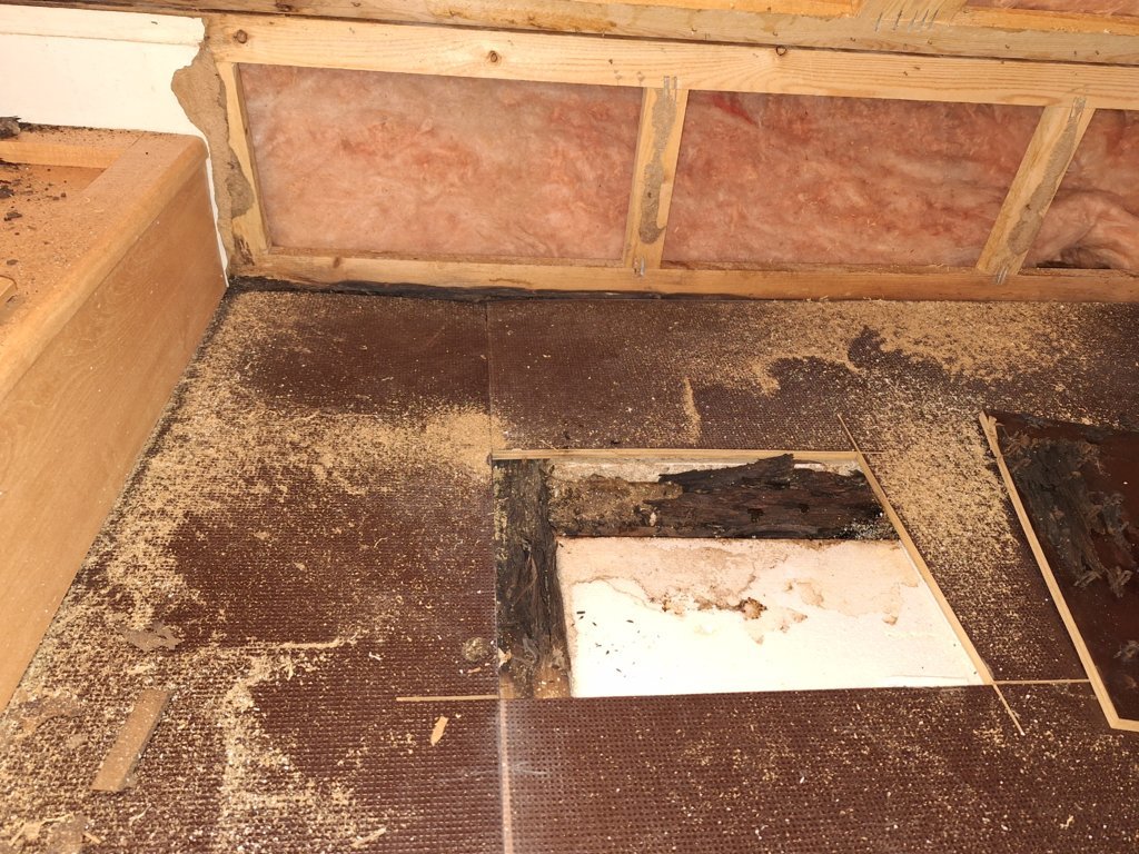

    I removed the stupid TV antenna, replaced the poop vent cap, gutter spouts, and put 2 coats of sealer on the roof. I also glued a drain pipe for the a/c unit to the roof so it drains over the side instead of on the roof.
    Inside i started cutting holes in the hose. It has a 1" bow in the sleeping area. Not looking good.

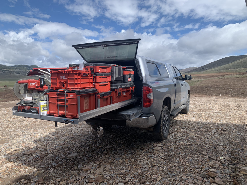

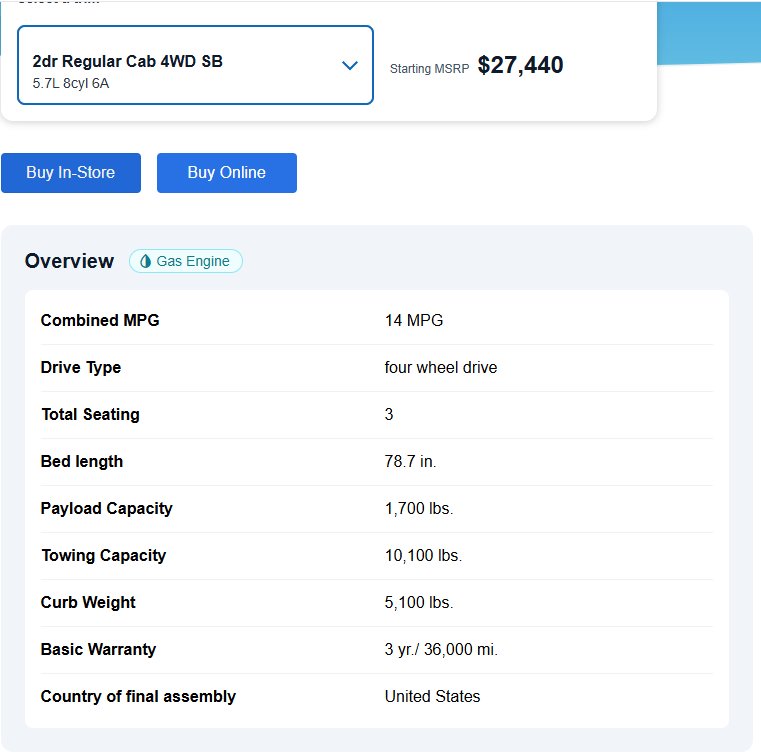

    That's all? Pffft... my truck would still be under payload (no, I'm not being sarcastic...). Scaled at 5060 LBS with me in the truck, full tank of gas. GVW 7150.
    I've heard about this. Not saying it doesn't exist, but haven't found it yet. From what I've seen, that usually comes from the off-road desert crowd that like to find suspension limits...? I have lots of miles on '13 with this setup; same as the '21. Under payload easy peasy, not even close to rear axle gross max.
    Hahahah. Not quite... Pretty sure that camper alone weighs more than camper and truck above combined. Plus, he said he's headed to Canadia, not BajaLand. We all know that Dodge owner was sending it off road, not puttering down the paved highway :D
  28. Jun 1, 2025 at 10:47 PM
    #28
    33,404
    18" TRD Off Road Wheels

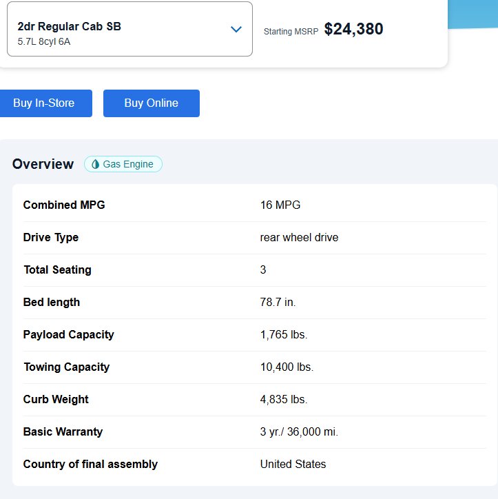

    7150 - 5060 = 2090 supposed payload, for a dry camper of 1900 lbs. You, and everything in or on the truck and camper weigh less than 190 lbs? Doubtful, so you would be over payload.
    He drove down unpaved roads. He wasn't baja-ing a dually 3500. It's also not the size of that camper compared to OP's camper, it's the proportional weight. The ram was something like 40-50% over payload. Edmunds shows the payload of a 2007 regular cab short bed with the 5.7 at a max of 1765 for a 2WD or 1700 lbs for a 4x4. We all know that the brochure numbers are optimistic, but let's pretend they are accurate.
    1765 payload - 1900 dry camper = -135....
    So the absolutely best case fantasy scenario starts this combo off 135 lbs. over payload before driver, passenger, mods, or any kind of camping stuff gets added on. Again, going with fantasy and optimism, lets say you can get on the road with a combined weight of 300 lbs. of people, 50 lbs for their combined luggage and items for a two week trip, 15 lbs of essentials in the camper, plus airbags and sway bar for say another 25 lbs. This is no water, nothing super heavy or extra, and ignoring the bumper and winch.
    135 + 300 + 50 + 15 + 25 = 525 lbs over the 1765 best case payload. That's about 30% over payload on an unboxed frame that flexes a lot.
    Can you do it and think you're fine for a long time just like the Ram did? Sure, but if you try to say that this isn't overloading the truck and causing excess wear and tear that could very believably lead to a similar catastrophic failure as the Ram, well then you're just delusional. And that's with the magical payload numbers and taking nothing but essentials with you.
