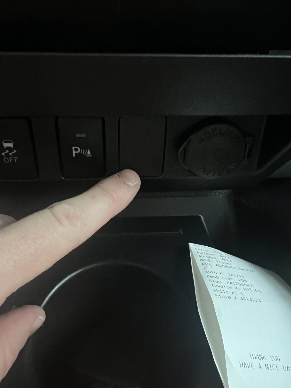

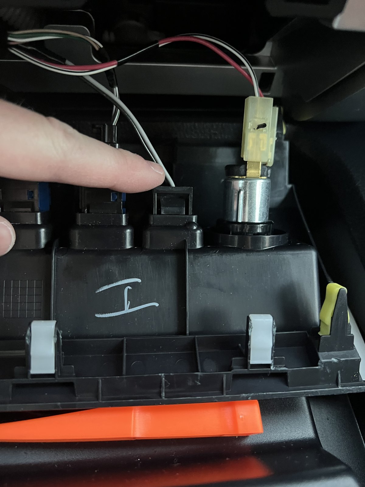

    Was a busy weekend so I just got back to it. I slapped the new ports in and everything works fine.
    Question though…what switch is supposed to be here? It’s prewired. Is it something I can just buy and slap in?
  8. Nov 13, 2023 at 1:55 PM
    AZBoatHauler
    Aug 13, 2019
    #34576
    9,067
    So.Arizona
    Glass breakage sensor.
    rmorse[QUOTED][OP] likes this.
