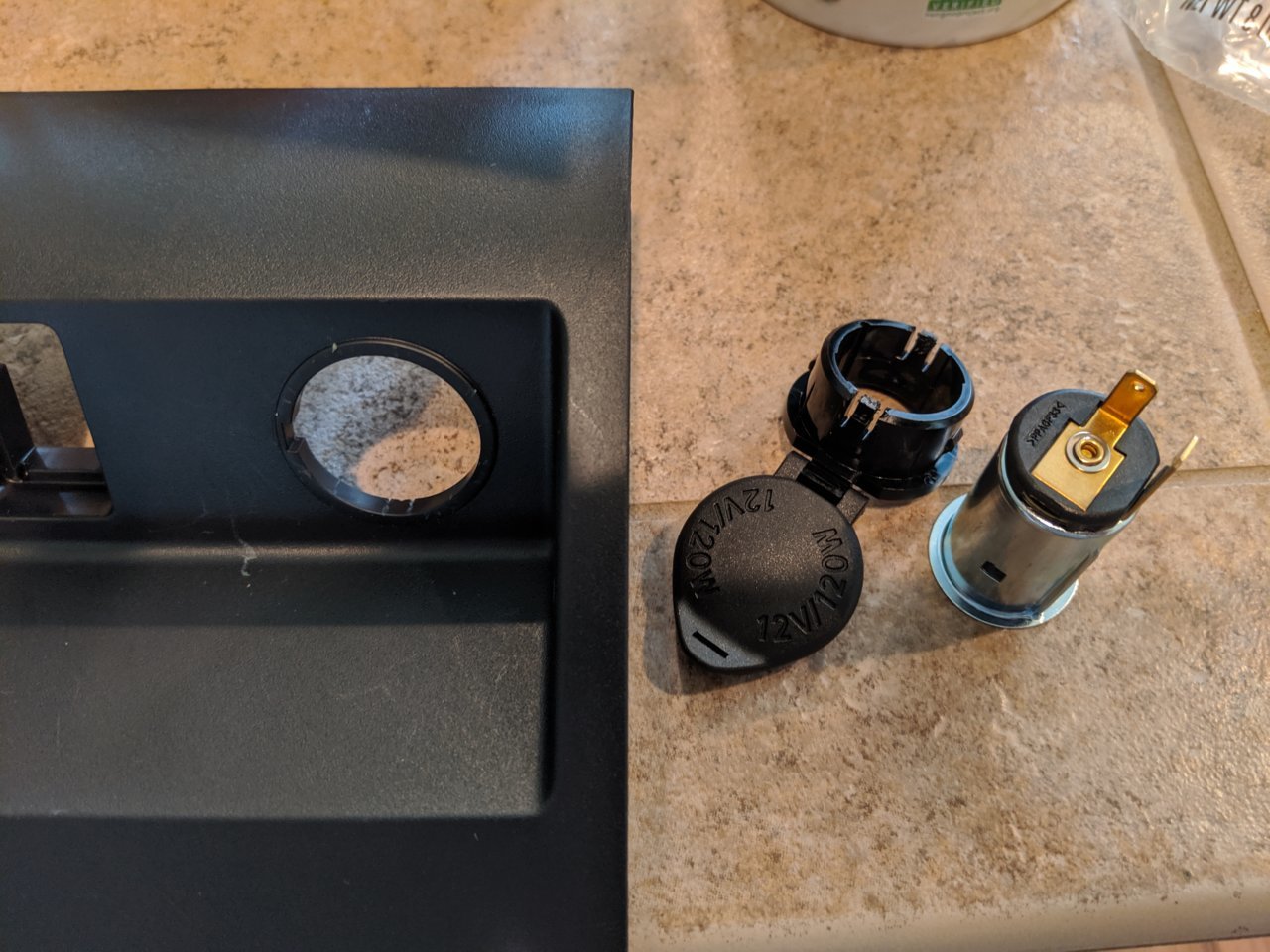

    I took off the panel and removed them from the backside by pushing little tabs in the cig housing first then remove the cover it’s a 2 piece set up. I have no more cig ports on mine I made them all USB even the back seat center council

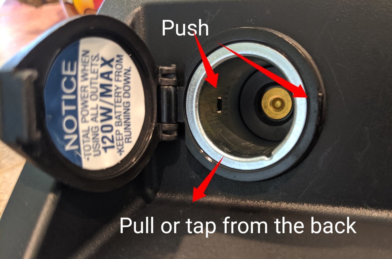

    I tried pushing the little black tabs.. maybe pull harder? It didn't budge

    I did the little metal tabs first so you can slide out the cig lighter then u do the black tabs to remove the black housing with the little door cover

    Got it! It was just stubborn. Had to really push hard on the tabs, then pull the metal ring out. I tapped it with a knife to persuade it out.

    Like this.. mystery solved
