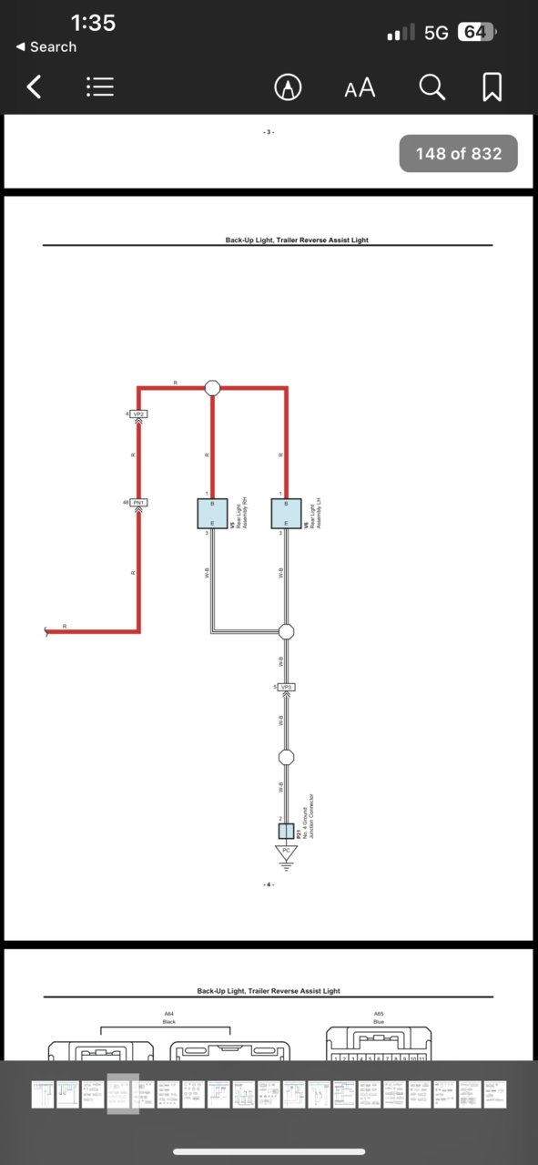

    Is it the white black stripe wire or the red wire that provides power to the reverse lights? 2969609B-FA5C-431B-9E14-74B87A3AE5F6.jpg

    Red side is power. The upside down pyramid at the end of the white line is the symbol for ground.
    If you go back a page and follow the red wire it will eventually go to power.
