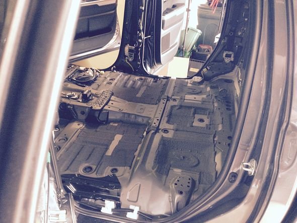

    There are few plugged access holes under the back seat.
    You're probably going to have to pull the seat and carpet to really know what is under there..
    This is my DC, your CM will be different.
    638DCE44-F47A-440E-998C-AD18A99A9987_zps_4a554f264d3bdc3982ba32bfe175c43d79ce1dea.jpg
    I ran my wiring for cargo/bed lights and amp step lights in the access hole on the floor in front of the driver and passenger seats..
    Good luck..

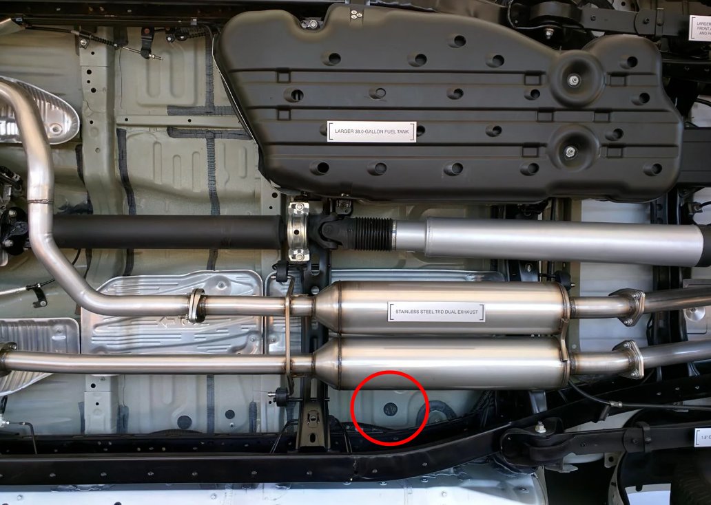

    I ran power for a 120 outlet through this circled grommet under the rear passenger seat from an inverter in my bed. I pulled the rear passenger seat the trim from the door sill, and folded the carpet out of the way. Only takes 15-20mins if you know what you are doing. A little longer for your first attempt.
