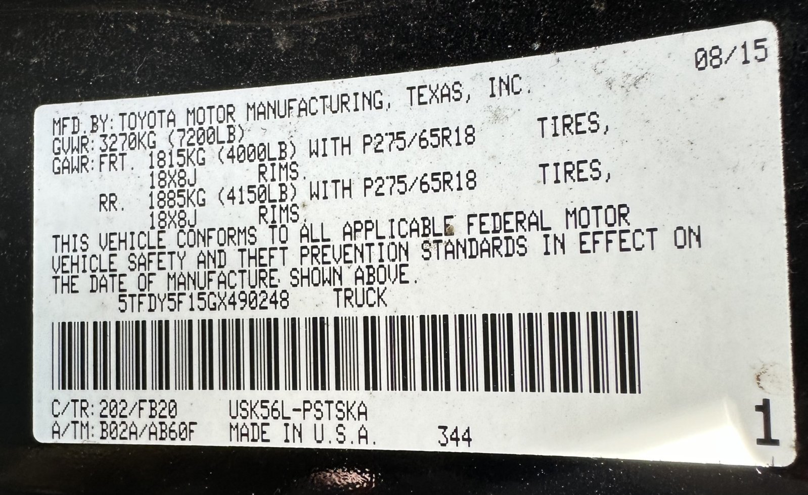

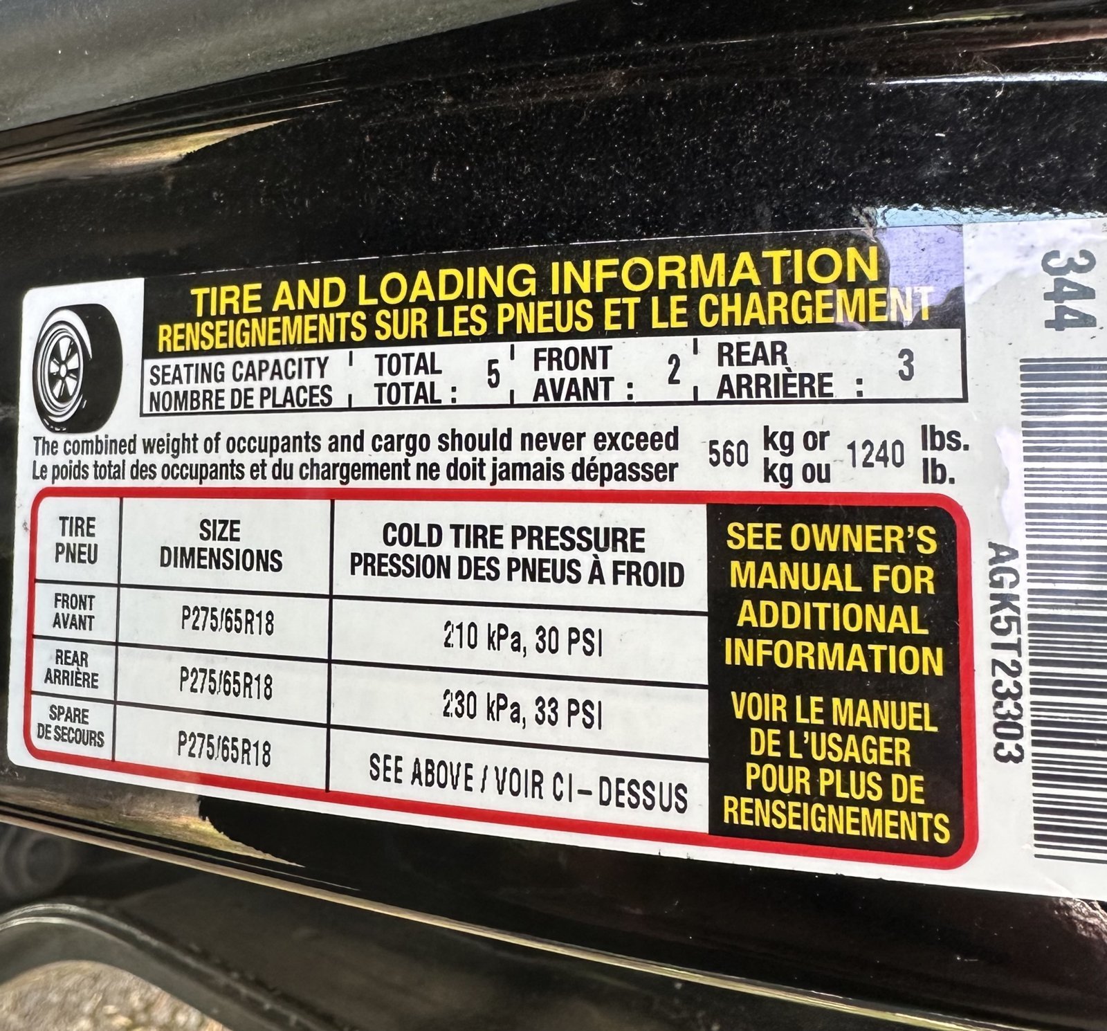

    Hello, I have been reading all the threads I can, but still so confused on hitch weight.
    We have a 2016 Tundra Crewmax. Here are the stickers from our truck.
    I believe we can tow 10,000 lbs, but I am so confused in how to figure out hitch weight.

    So your total payload is 1240lbs, as indicated on the top right of the yellow sticker. so anything you add to the truck will decrease that number. If you add 100lbs worth of running boards you’ll be down to 1140 lbs. Or, if you add 4 250lb linebackers, you would would only have 240lbs of payload left. The hitch weight counts against payload in the same way. So if you have 1215lb hitch weight you have 25lbs left of vehicle payload. The other trailer with 1075lb hitch weight leaves you with 165lbs of payload.
    The trailers you’re looking at would subtract nearly all of your payload so you couldn’t put anything else in the truck, not even a passenger and be within your payload numbers.

    Hmm, okay. Apparently, we have been exceeding it with our current trailer by a couple of hundreds of pounds.
    I had no clue it was so little considering it has extra tow stuff on it.
    That is frustrating.
