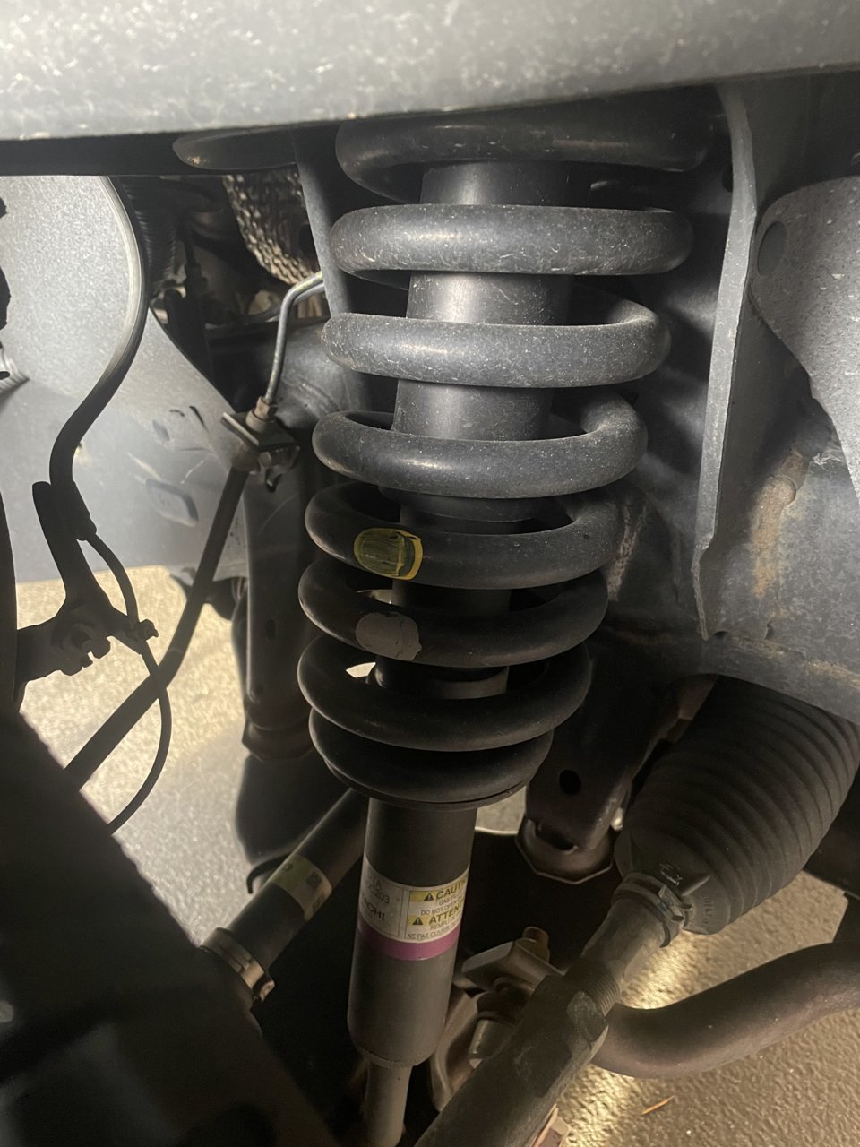

    My passenger side step rusted out on me, which is weird because the truck is only a 19, and I took mine off. I suspect these were put on used before I bought it. So I just realized how damn tall this thing is. What's the stock height, say from the ground to the door sill, or to the wheel well? I measured mine and it's 21", 37", 39.5" for the door sill, the bottom of the wheel well in the center on the front and then the back.

    In your profile photo your truck appears to be stock height. If you post a photo of your front strut assembly/control arm we can give you a definitive answer though!

    Looks stock to me, but I’m no expert.

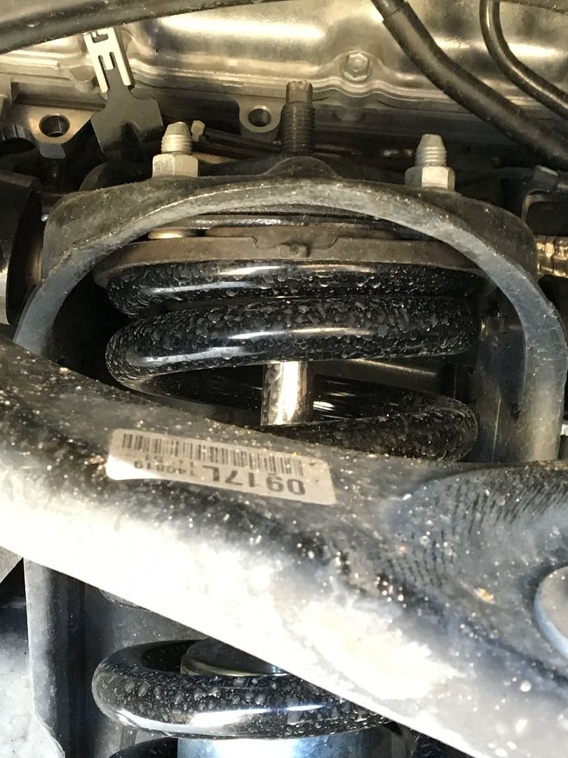

    I have a note on my phone of measurements before I did my lift/level.
    Tundra stock body height
    Front left 36.5
    Rear left 38.6
    Front right 36.25
    Rear right 38.75
    @r1ch999999 that sure looks like a stock black stock.
    If you had any spacers or shims they would be on the top of the shock.
    I have a 1/4 Coachbiulder shim that increases the lift by 1/2 inch on top of my 6112s.
    You can barely see it above the shock..
    12E57596-8F7D-4C02-84F3-B12D1190EFC9_zps_0c6105629648d271ed54ddacf8adf2d65912d358.jpg
    r1ch999999[OP] likes this.
