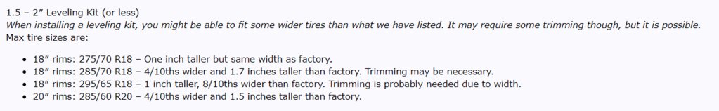

    I drive a 2014 SR5 Crewmax and I just installed the Eibach Stage 1 kit which gave a 2 inch lift in the front and leveled out my truck. I'm looking to get new tires, and if possible would like to go a bit bigger with the new lift. I currently run a size P275/55R20, with fuel wheels.
    I'm not a huge car guy and am still learning. Just wondering what you all would recommend on size if wanting to go for a tire that looks and fits the truck a bit better now.

    This thread has tire sizes for both stock and with lifts: Largest tire you can run stock for all generations | Toyota Tundra Forum (tundras.com)
    Good place to start on sizing ideas. Use this tool to compare any potential size tires to your current to give an idea of size/profile differences: Beyond that if you narrow it down to a size, search the forum for that size to see posts of people running that size and how it looks. Best of luck!
