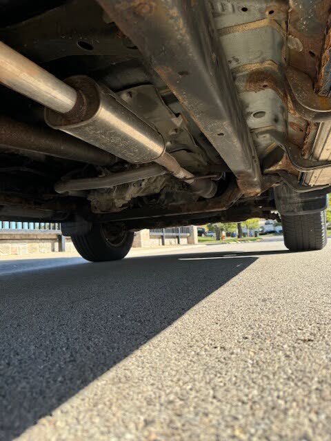

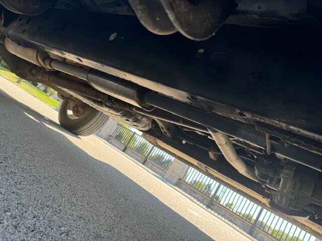

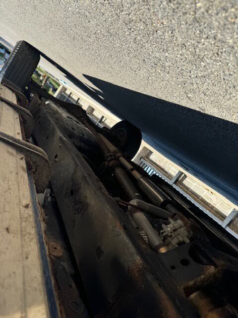

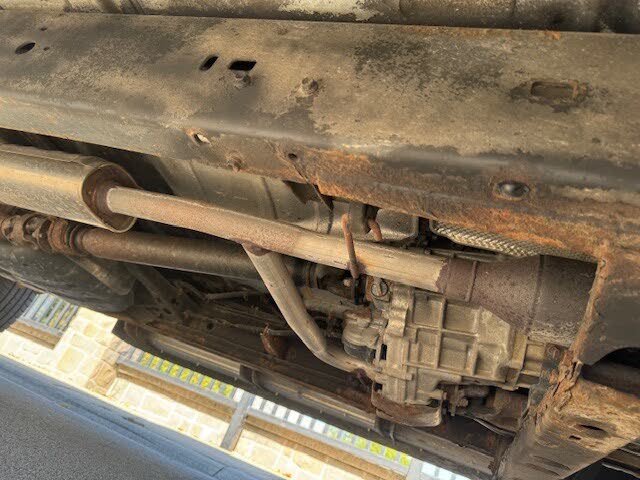

    I’m shopping for my first Tundra. I’m not familiar with much other than that they last forever. I’m eyeing this one, its maintenance records are decent and the timing belt was done in 2021/ 30k miles ago. It looks extremely well taken care of. But it’s the rust that I’m unsure on. I’ve seen a lot and called about a lot that have had frame repairs. To me it doesn’t look too bad but I’m also not knowledgeable of all the parts under a truck so maybe there’s something too rusted that I’m not catching. What’s yawls opinion? Good to go or stay away? I’m about a 7-8 hour drive from it, so that’s why I’m asking for help here. IMG_7247.jpg IMG_7246.jpg IMG_7247.jpg IMG_7246.jpg

    Someone has been doing some coverup, and that last picture, the crossmember is literally falling apart. Walk away dude.

    Yeah, that last picture was the most concerning for me. Smh, I ain’t ever gonna find a truck in my price range it seems like. Thanks for the advice. I guess that’s why they dropped the price another 2k today.

    I’d be concerned. There’s not enough resolution in the pics to see everything you need and for certain areas like the crossmember, the boxed section up front and the evidence of rot behind the rocker panels have me concerned. Probably not worth the trip if you don’t know what you’re looking at and how to treat it.

    Yeah I’m gonna stay away from it. I’ve got a few more I have to call about because no pictures were posted underneath. Hopefully I’ll be posting back this weekend with a new to me 1st gen

    It was apparently rust-proofed in past. Would need to do it once again.

    Glad you passed on it. That transmission crossmember is scary looking. That, and the frame looked pretty well "pooched" in the rear close to the muffler (where the reinforcement plates are).
