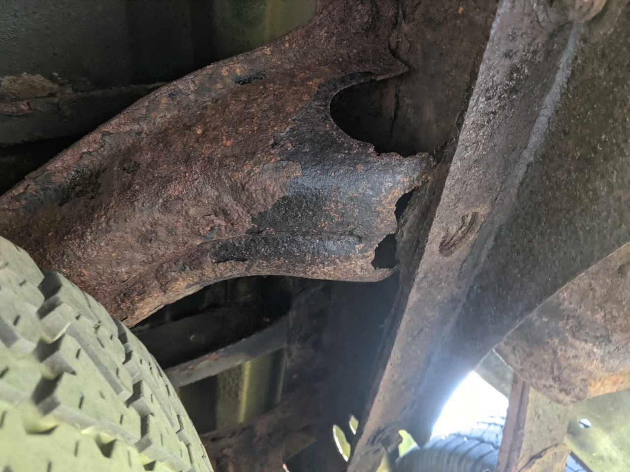

    I recently bought a 2003 Tundra. Went to the mechanic who refused to service the truck due to frame rust. Mechanic claim the truck is unsafe to drive. I'm on the west coast, truck is from out east, so the mechanic has likely never seen the such severity of rust.
    No recalls available. What should I do?

    Is the rust bad? Yes. Unsafe? Hard to tell. The crossmember looks like an issue. How’s it up front where the boxed section of frame resides?
    Also, go around the vehicle and hit the frame with a small hammer to see if it’s compromised in the questionable areas.

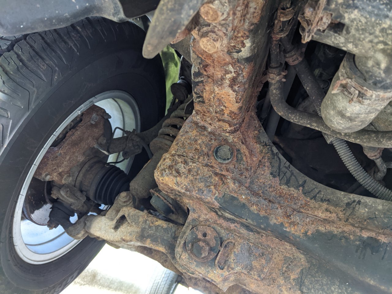

    Here are some pictures of the front section. Haven't tried hammer for soft spots or anything yet.
    I'm in Canada, checked for recalls online also called Toyota corp, no recalls available.

    That is too bad for me to consider driving. I would be afraid something would let loose at highway speed, hauling or towing.

    That looks pretty bad, I’d bust out a wire wheel and chipping hammer on various parts of that frame to double check but IMO it looks like a lost cause.

    That frame is overcooked. Was clearly left in the oven too long.

    shes done... not unsafe yet.. but its a mater of time before it is.

    I am on the other side of the coin. From the pictures you posted, I would say it is surface scale. My '13 4Runner looked like this. Passed dealer inspection. I brushed and scraped and do a fluidfilm application every summer now. Have fun with those LCA bolts.
