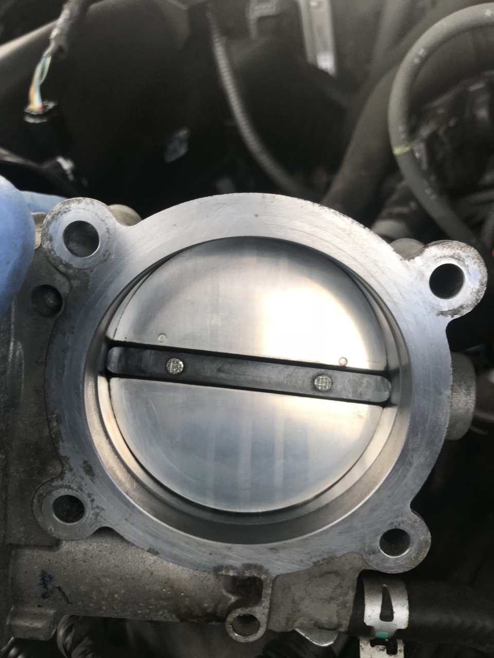

    Cleaned the throttle body and MAS today. Definitely looked like the throttle body needed some love, hard to tell if the MAS was dirty or not, but figured it wouldn’t hurt to do. It seems to be idling a touch high now, but throttle response is noticeably quicker. 3798E999-16A6-4320-84C4-517BC4086F77.jpg0D54FA27-5B07-4208-990D-2F75A38BD1E9.jpg

    I thought I remembered reading that when you mess with the throttlebody you need to do some type of relearn procedure. Hopefully someone will chime in. Or Google it and add tundras.com at the end of your search question.

    Thanks man, that's news to me so I'll see if I can find something.

    Just found Nor7's writeup and he says "The truck will eventually re-program Throttle Body position but for more instant effect, remove battery cable to let computer reset." A few other online blurbs essentially say the same thing about Tundras, so I think it's fine.

    Ok, seems like cleaning the throttle body has really changed the way it's driving - crisper throttle action, and it's not shifting nearly as rough as it was before cleaning it. Let me know if the above photos look like normal gunk for 80k or not, but I'm thinking that the previous owner let this truck idle quite a bit as it has a remote start, block heater plug-in, and spent most of its life in Alaska. Armchair mechanic'ing for sure with this theory, but I'm thinking excessive idling along with babying the truck has resulted in carbon buildup throughout the system, which may be the reason it's getting such sh!tty gas mileage. Any suggestions on other areas I should service? New plugs? Injector cleaner or service?

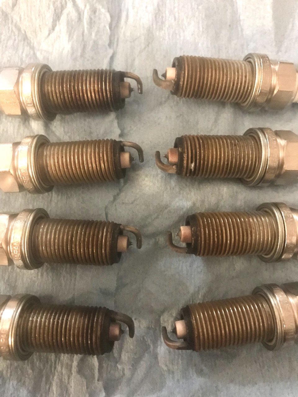

    22F6A2BF-4E48-42E1-88BF-02F6293B766A.jpg Changed the plugs today. Anyone good at spark plug diagnostics? My amateur eye thinks it was a good call not to wait for another 40k to swap them out at the suggested 120k, but I’m curious if these just look like normal wear or not.

    They ain't look too bad. Little Browning on the insulator. Never hurts to change them early though.

    I agree too. I think I'll go with those OEM plugs at some point. I've got 83.3K miles now at 10 years old. Might be time to do the same and see how they look. "303z, I'm curious if your mpg will improve. Even a little is good."

    The spark plugs show only a change in mileage if they're really bad, but it's good prevention for unburnt fuel. Having a clean burn certainly helps in the overall longevity of the vehicle.

    One thing you don't want is even one plug totally fouled up for sure. The onboard computer does a great job of keeping the fuel/air mixture ratio up to snuff.

    Thanks for the thoughts on the plugs, guys. After swapping those out, cleaning the throttle body, and running Sea Foam through a vacuum line, I ended up with 17.6mpg with a bit more city driving and more mountainous highway driving. Hard to say what did the most good, but happy it made a difference, regardless.
