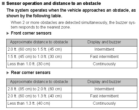

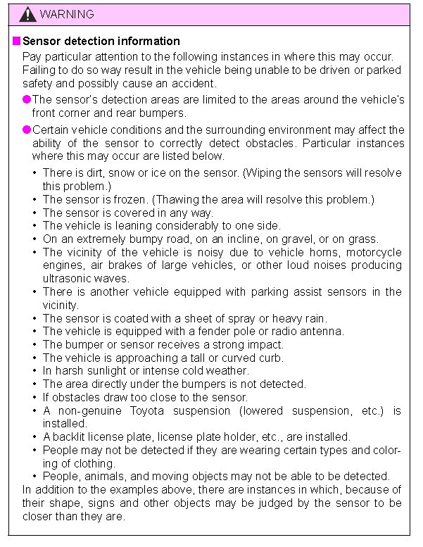

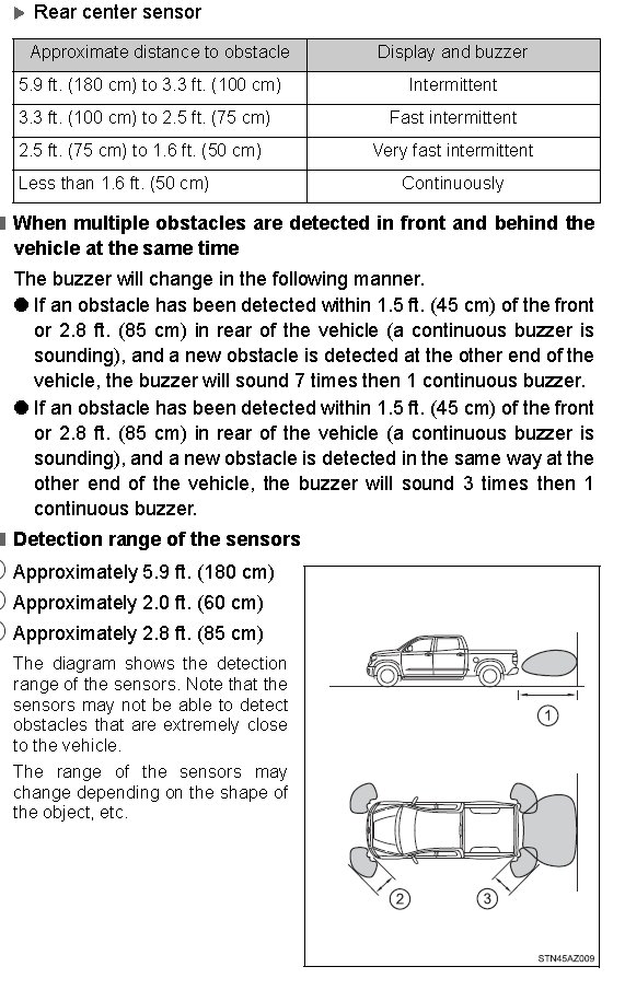

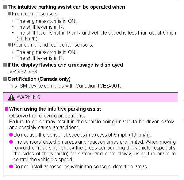

    The objects also need to be detected by two or more sensors (it says two objects, but they mean two sensors). P298 of the manual covers the "Intuitive Parking Assist"
    bkdelux[OP] likes this.
