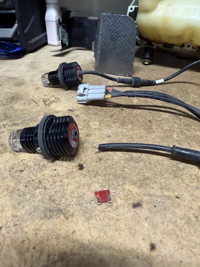

    Just want to throw a bit of knowledge out there. I’ve had my HotShot Off-Road Hot Tails kit for 3/4 years now. A co-worker came up to me and told me that I’d didn’t have any tail lights and only one brake light worked.

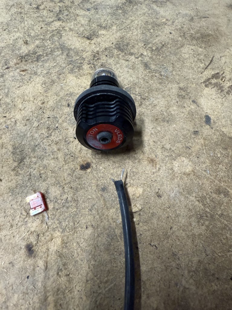

    Diagnosed it just now to find the wiring corroded away. I’ve only started to drive my truck full time in the past 18 months and live in the salt belt so take that for what it is.
    Found this wire completely corroded away and it blew my fuse for the tail lights in the process. Luckily I’m a pack rat and keep my old sockets and bulbs.
    I’d say if you have them, just make sure you have them tied up well and check them.

    First time I've seen that. That looks to be more of an issue with the Vled bulb then the actual HotTails portion of the kit.
    But that is still good advice, it is important to check harnesses and wires especially ones that were added not by the factory

    Well... THAT's a first! At least the first failure that we've had that popped the tail light fuse. My guess is that the wiring somehow walked out, and then grounded to cause a short. Even though you're technically out of the warranty window for the bulb(s) I'm happy to replace it. Shoot me a PM with what all (at least visually) is amiss, and we'll start there.
