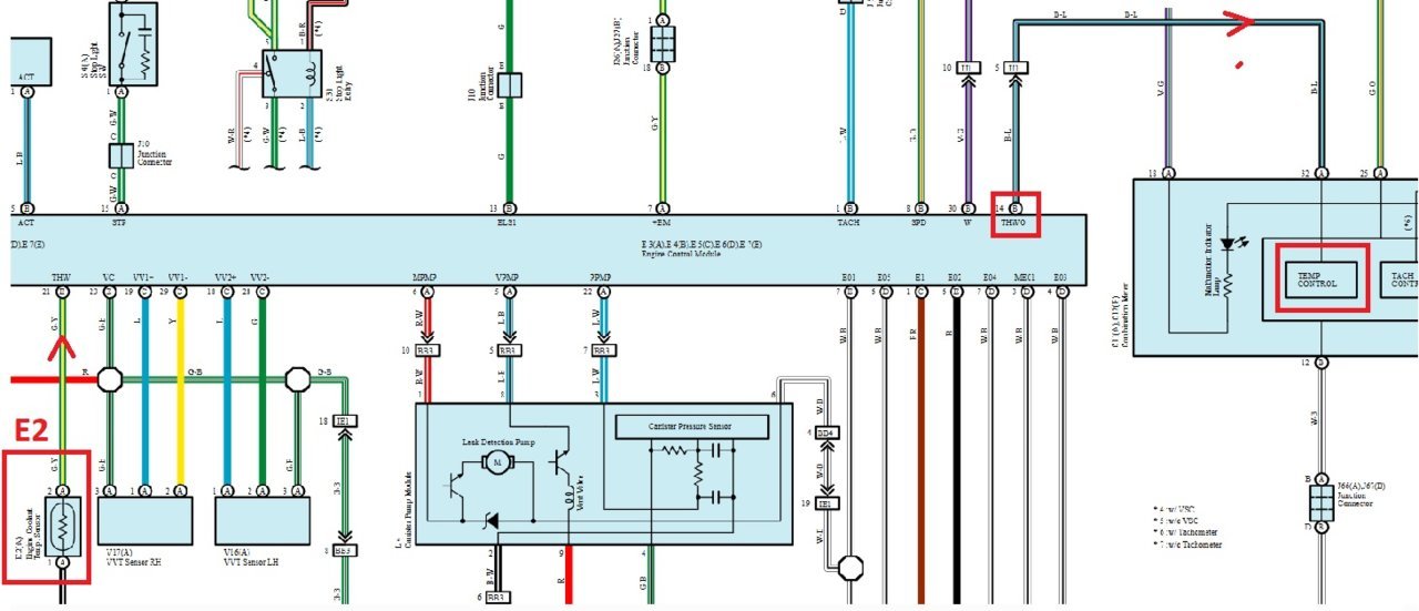

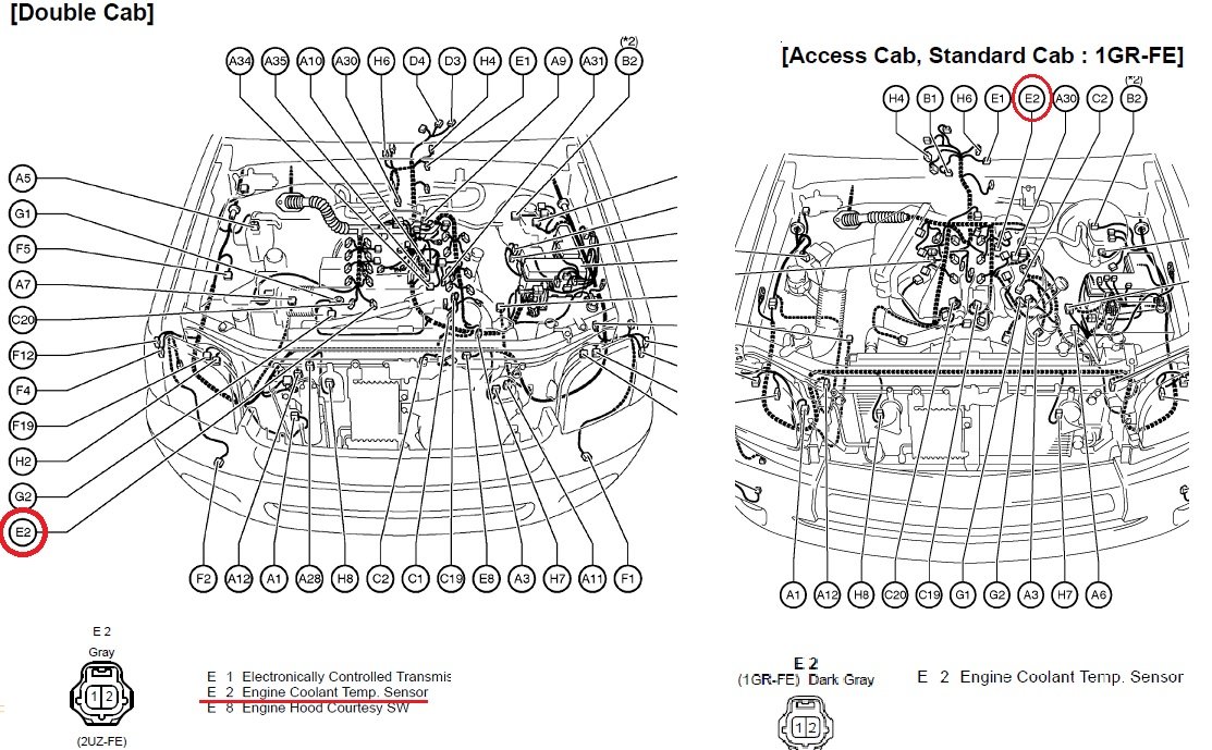

    Important to note,they changed up for the 05 and 06. They still have the coolant temp sensor and indeed it is Gray(2UZ) and Dark Gray(1GR) that feeds the ECU.
    The sensor for the 2UZ is indeed on passenger side, close to TB but on the 1GR it's located driver side back of eng area.
    Where they got squirrely in the 05/06 for the combination meter temp gauge is they feed a signal(THWO) to that Temp Control gauge from the ECU that was derived from the E2 Temp Sensor thus doing away with the green connector for Temp Sender used on past years 00-04.

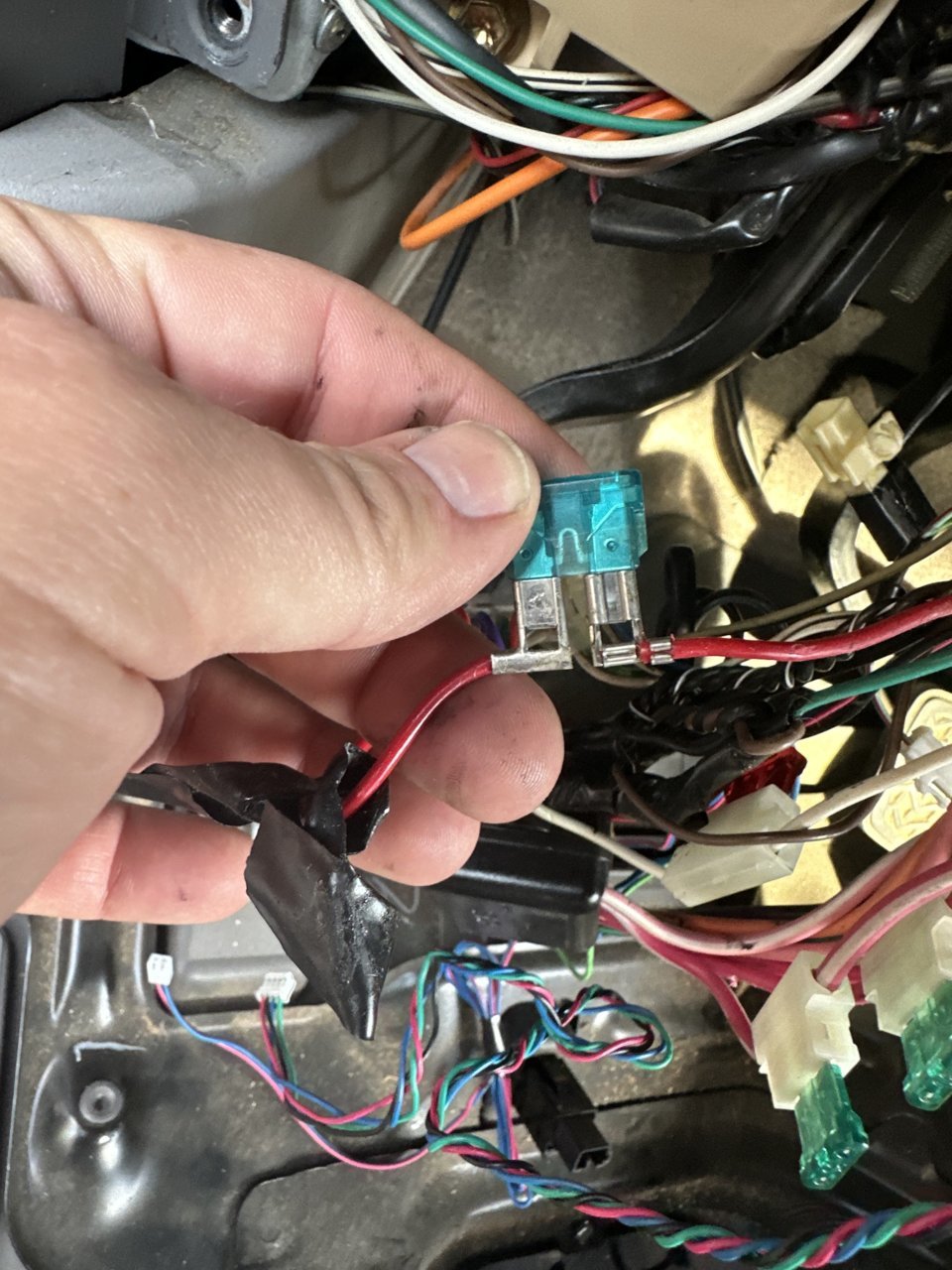

    does your truck have an aftermarket alarm system??
  14. Sep 23, 2023 at 6:48 PM
    wtfnow06tundra
    wtfnow06tundra [OP] New Member
    Sep 22, 2023
    #104298
    5
    Larry
    2006 Tundra sr5
    It did I have removed it from the truck. It was definitely half assed put in. I also noted some damage to the starter relay so I replaced it as well. I am lost!!!
