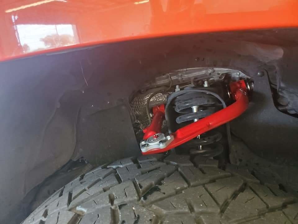

    So. Had this JBA uppers installed the other day. And of course, an alignment was done. On my way home, the truck drive straight, but steering wheel was off to the right by a hair. But since my tire wear is not even, I can live with it for now. Now for the bad. When I went to make a u turn, I heard a terrible knocking sound, and also felt it on the steering wheel. Every time lock the wheel to either side, it makes the same terrible noise, and it didn't do that before. I have bilstein 6112 with a 3" lift up front for about a year. Just now added the UCA s. Has anyone had a similar experience? I'm going back to the shop Monday. Hopefully it's an easy fix.

    Rubbing on your skid plate?

    No. Skid plate already trimmed. All the rubbing issues were taken care of a year ago when I did the lift. All I did now was upper control arm upgrade.

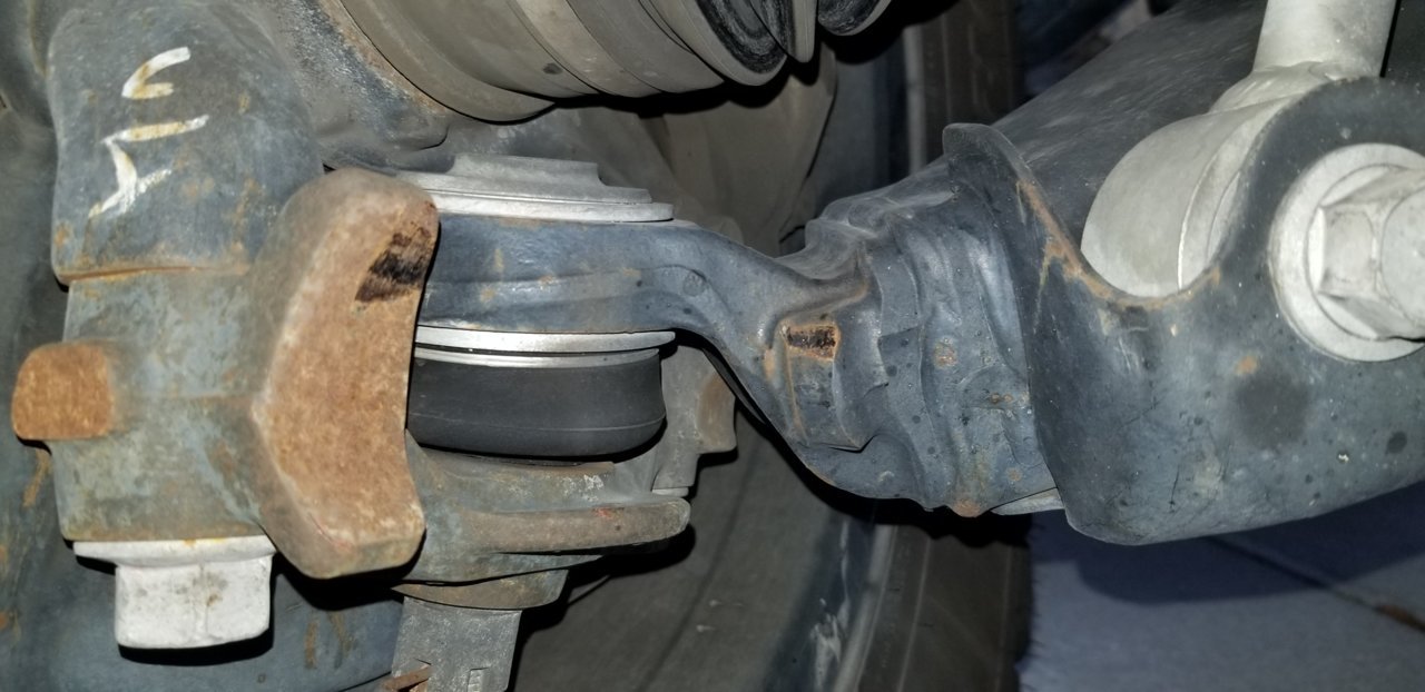

    Noise is back, every now and then, and I think I found the problem.

    If it happens at full lock which I think is what your symptom is then grease the steering stops! Cheap and easy fix :thumbsup:

    Yeah. That's my next step!
