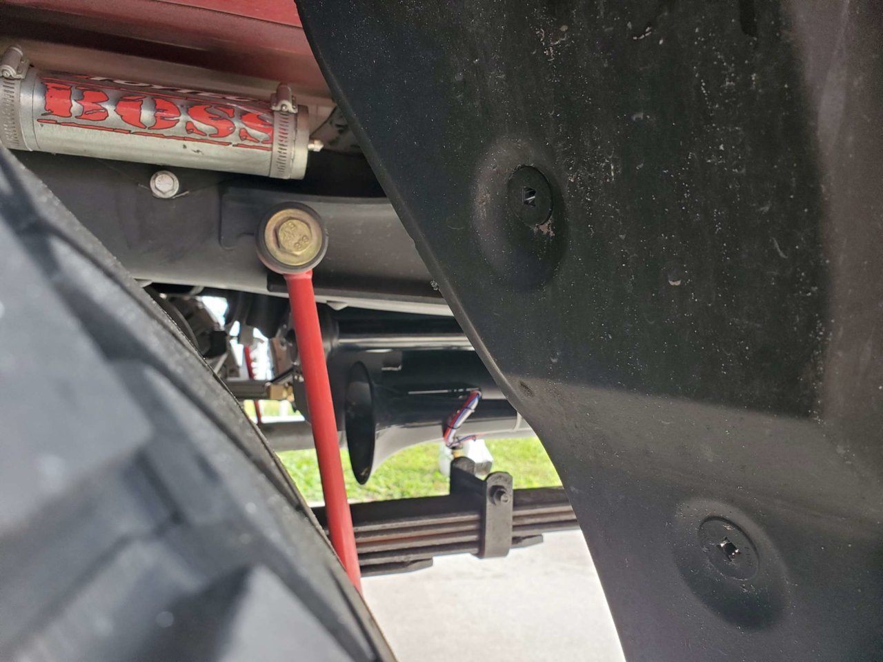

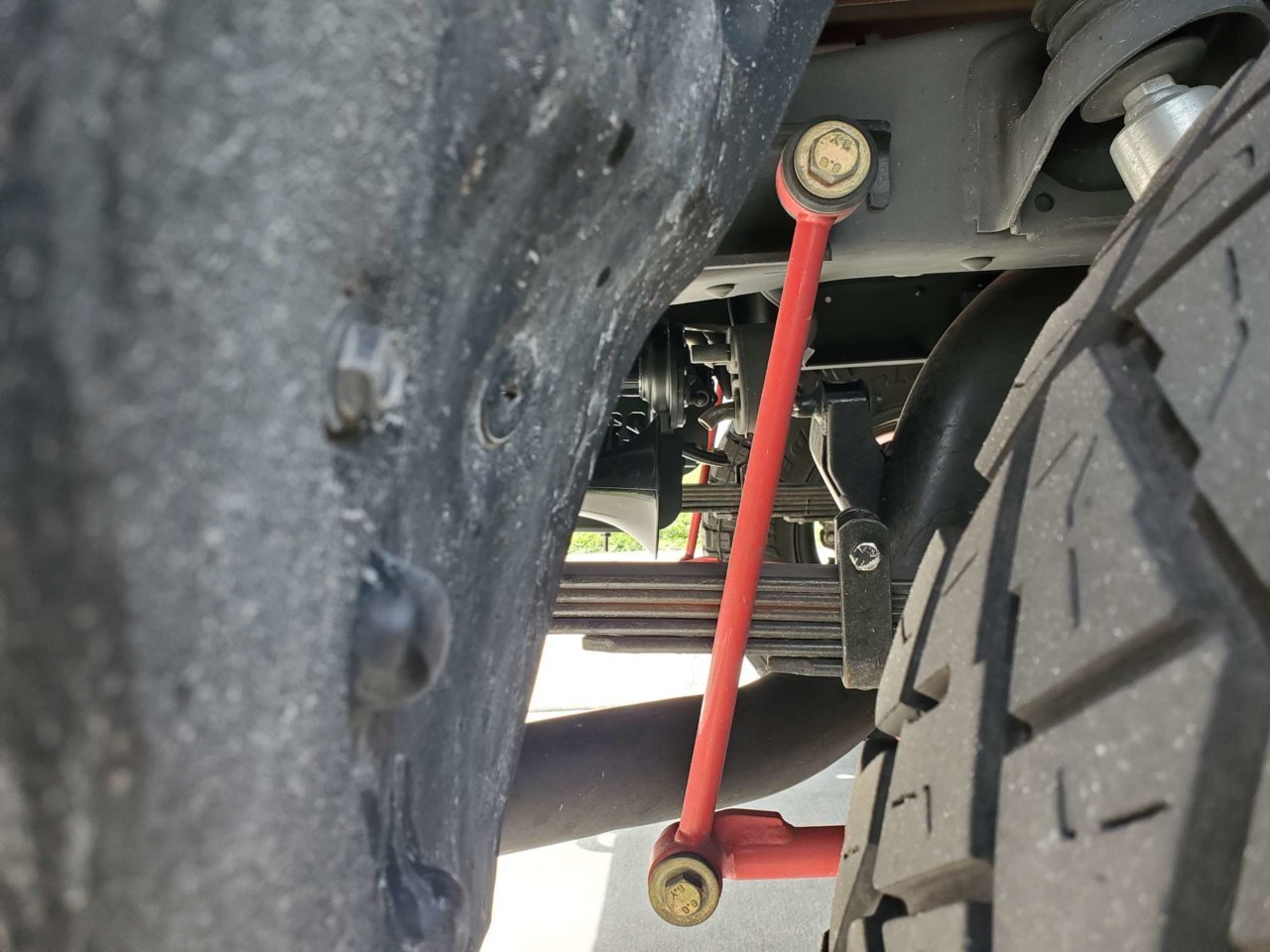

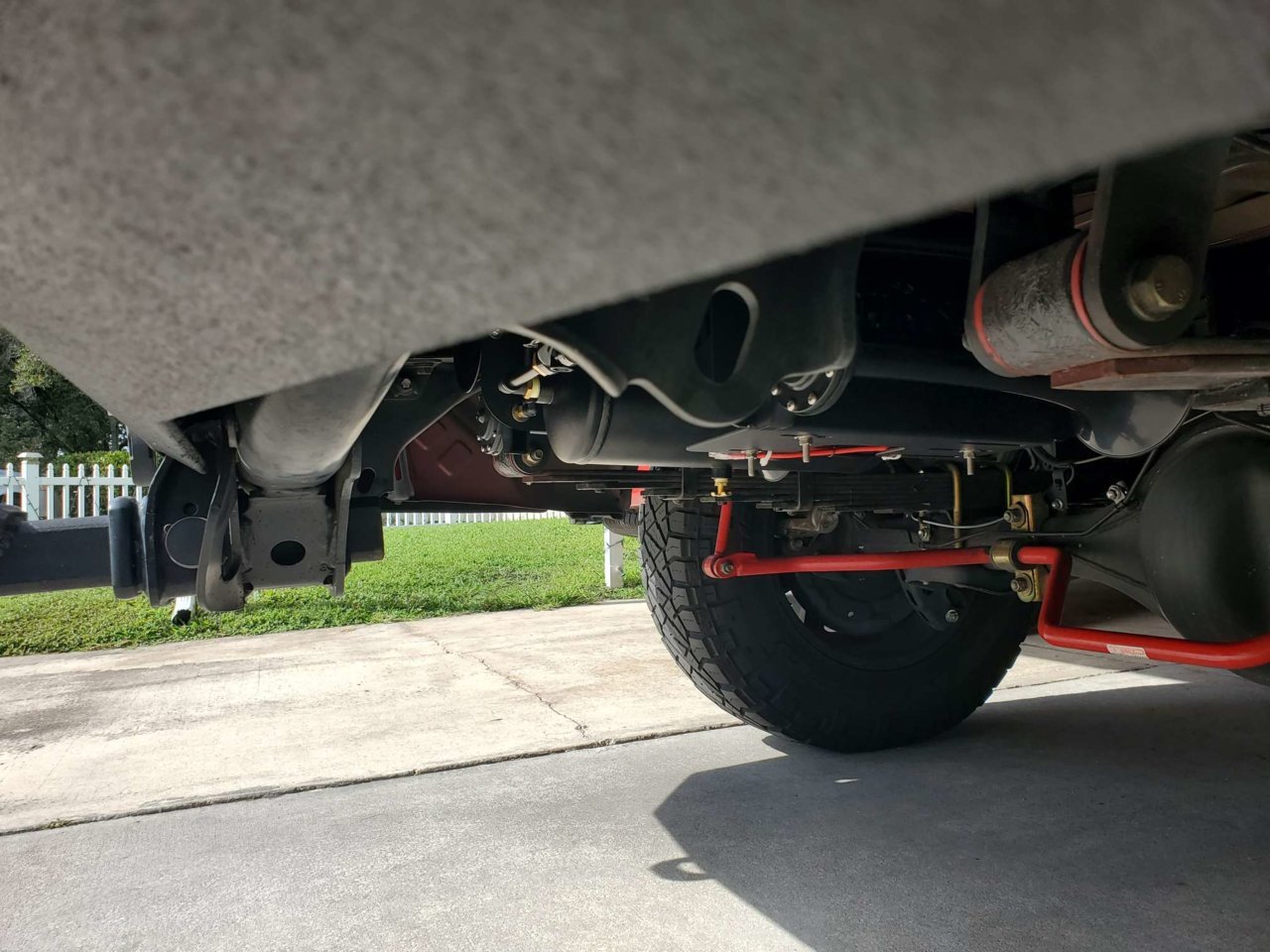

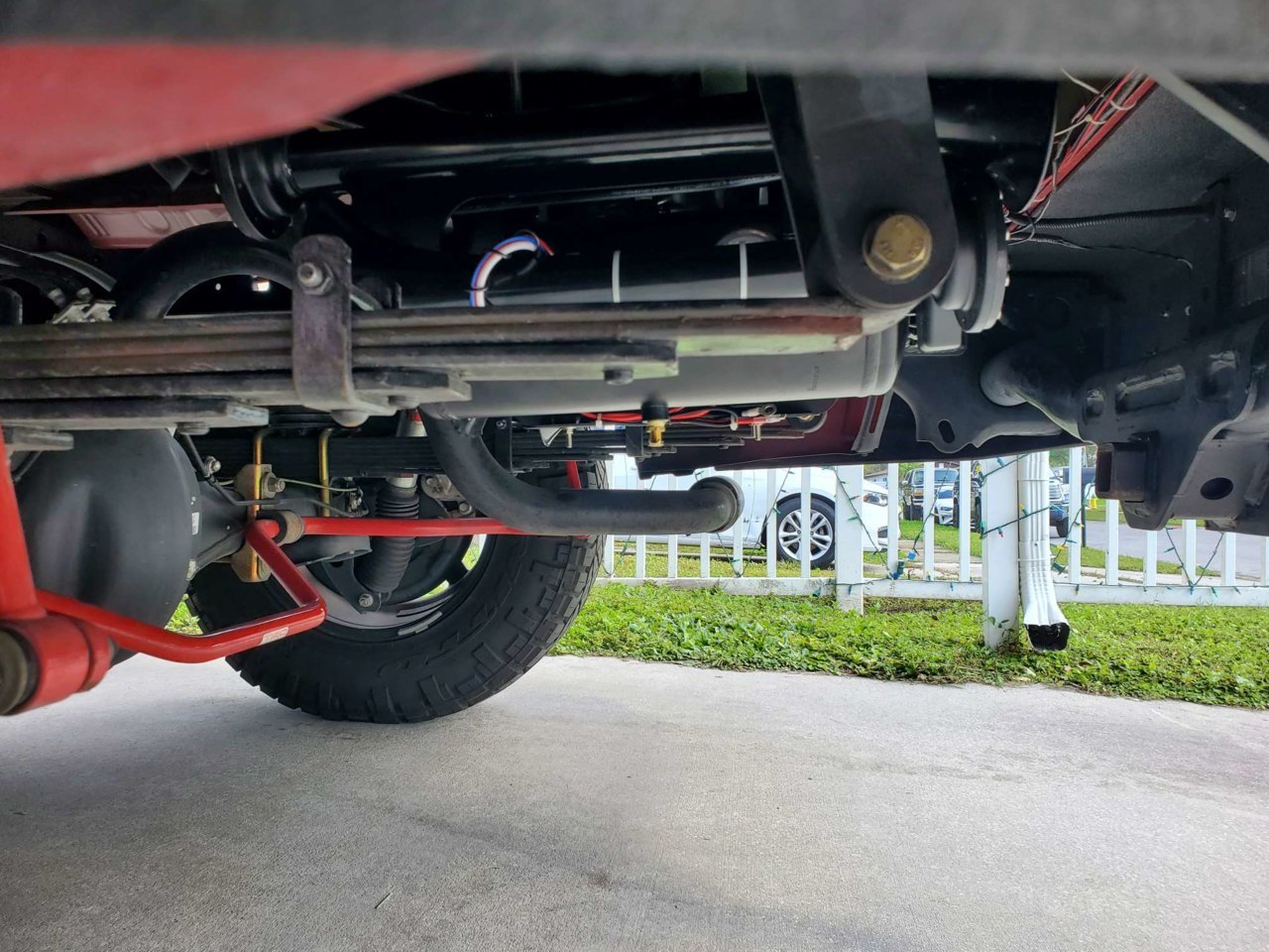

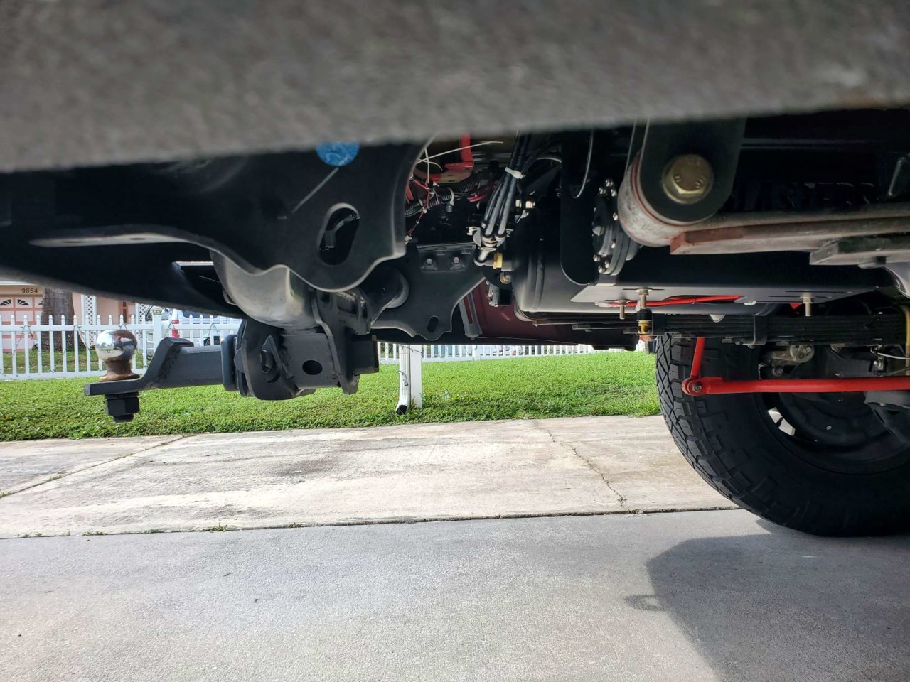

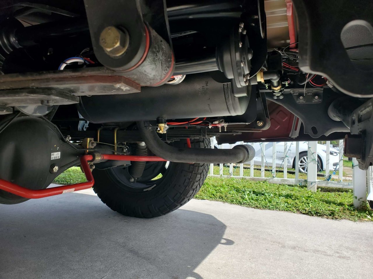

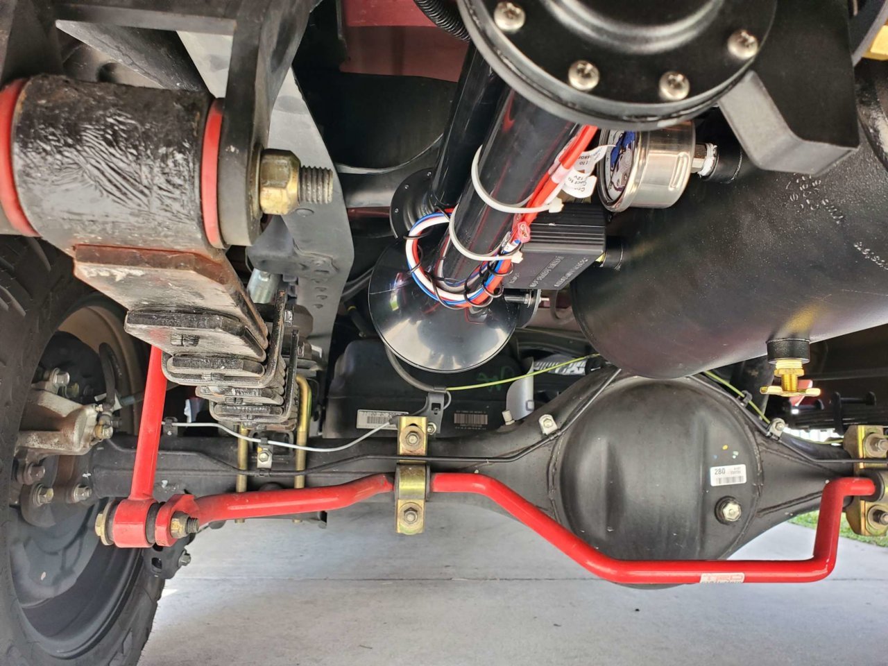

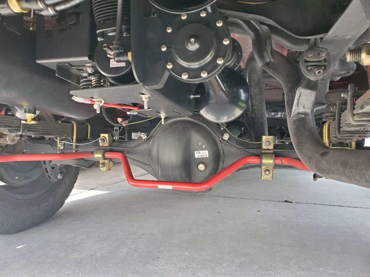

    I installed the Hornblasters Stealth tire delete kit. I still have to do the electrical but everything else is done. As you can see it does not hang below the leaf springs. You can't see it from the rear and you can only see a little bit of the horns from the wheel well. Two key notes if you install one of these.
    1) Install the side with the 2 longer horns on the driver's side. This will keep from having interference with the tire guide on the passenger side.
    2) There is a tab on the hoist that sticks through one of the lug holes allowing you to put a lock on it. That tab will need to be cut off. I installed a lock through the chain once the kit was mounted.
