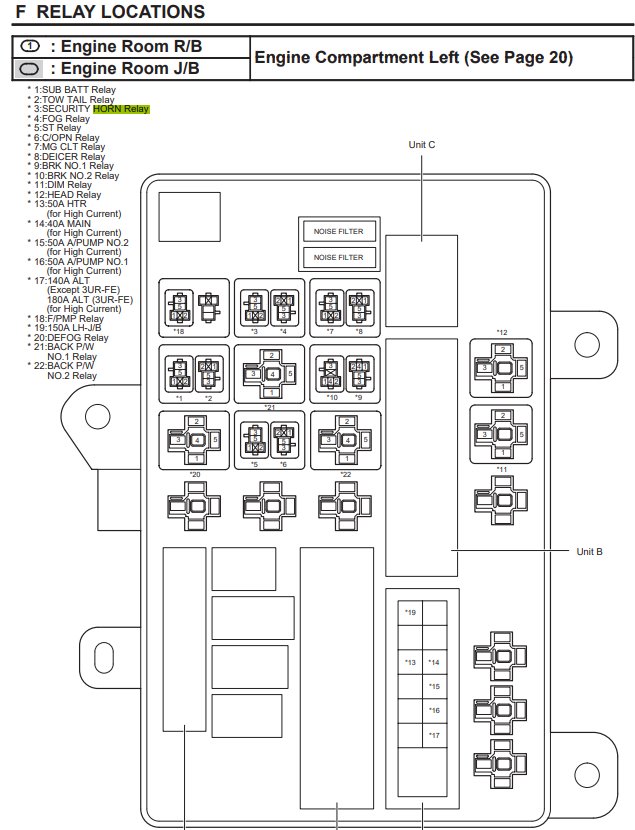

    Where is the horn relay at on a 2007 tundra sr5 crewmax
    I have looked but I can not find it

    Should be in the engine compartment fuse box.

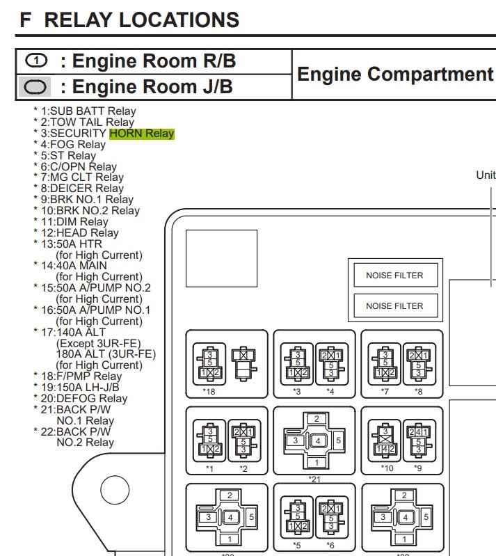

    I found the security horn relay but I can't find the horn relay..:confused:
