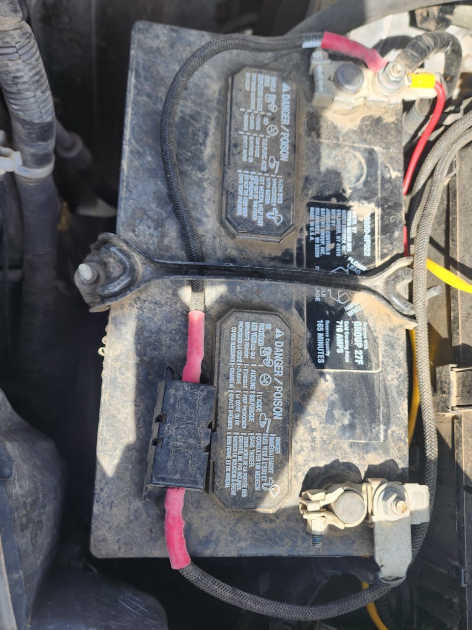

    Life's been crazy last few weeks. Finally getting more time to diagnose. I have not had the battery tested. I actually don't see any indicating markings on the battery of manufacturer or brand, unless it's on the bottom and I have to remove. Never had a battery like this before. Here's a pic. But the fact it happened randomly could be a possibility. That or corroded wire or something. I'll be pulling my panels tomorrow and Saturday to trace all wiring, possibly redo some connections to cover my base. I'm not really sure what multimeter settings would help me narrow down if wires are bad or good. I've done wiring on computers, building 3d printers, but nothing too extreme with multimeters. Gonna have to look more into what options I have for diagnosing

    That looks like just the factory battery to me. I'm not sure the brand that is used though. You could take it in and have it tested with a full load to see if there's a bad cell in it. I'd be hard pressed to think there would be corroded wires though with the truck being a 2020. But you never know!
