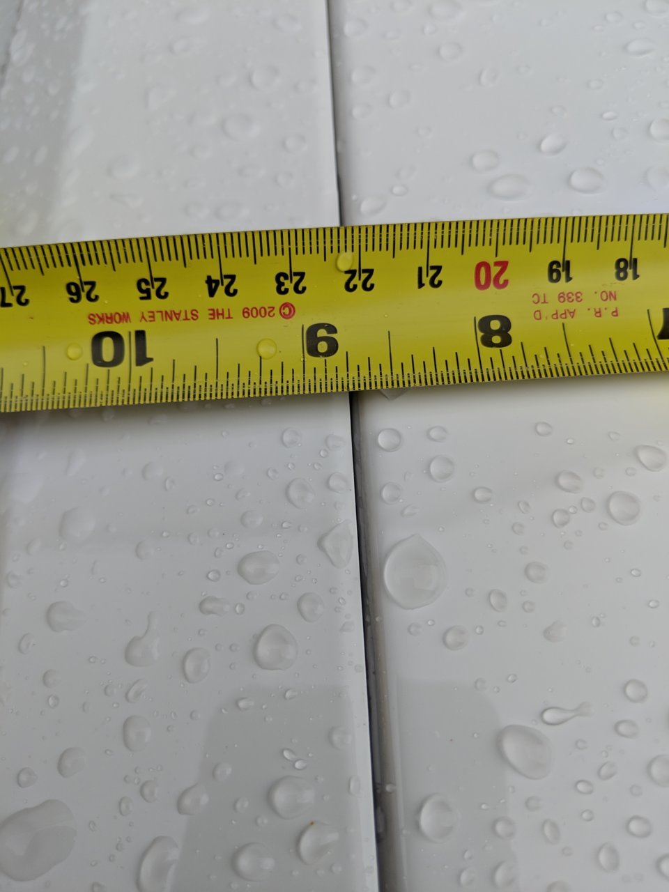

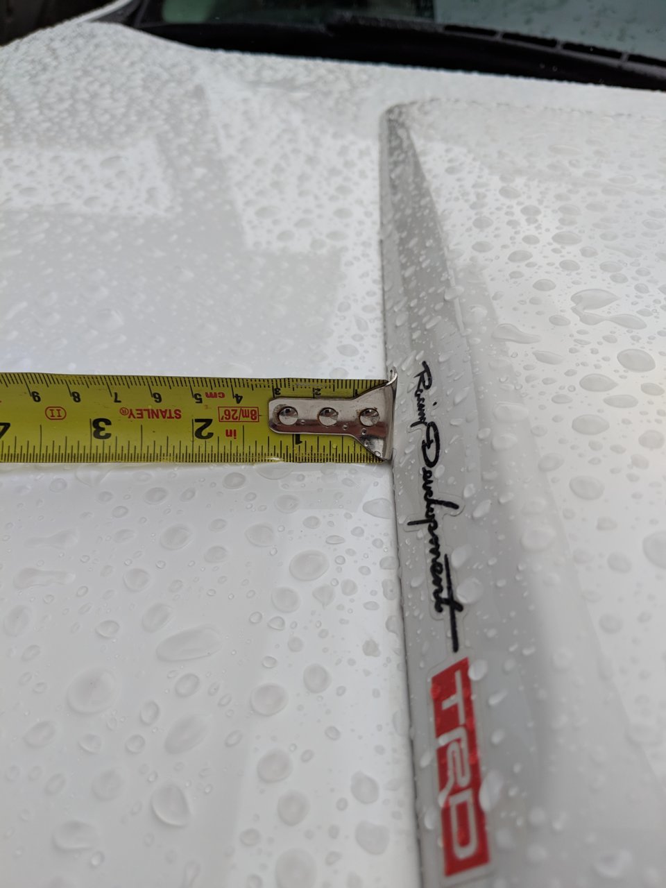

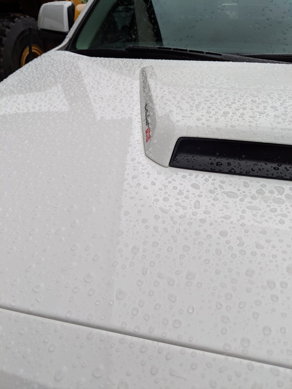

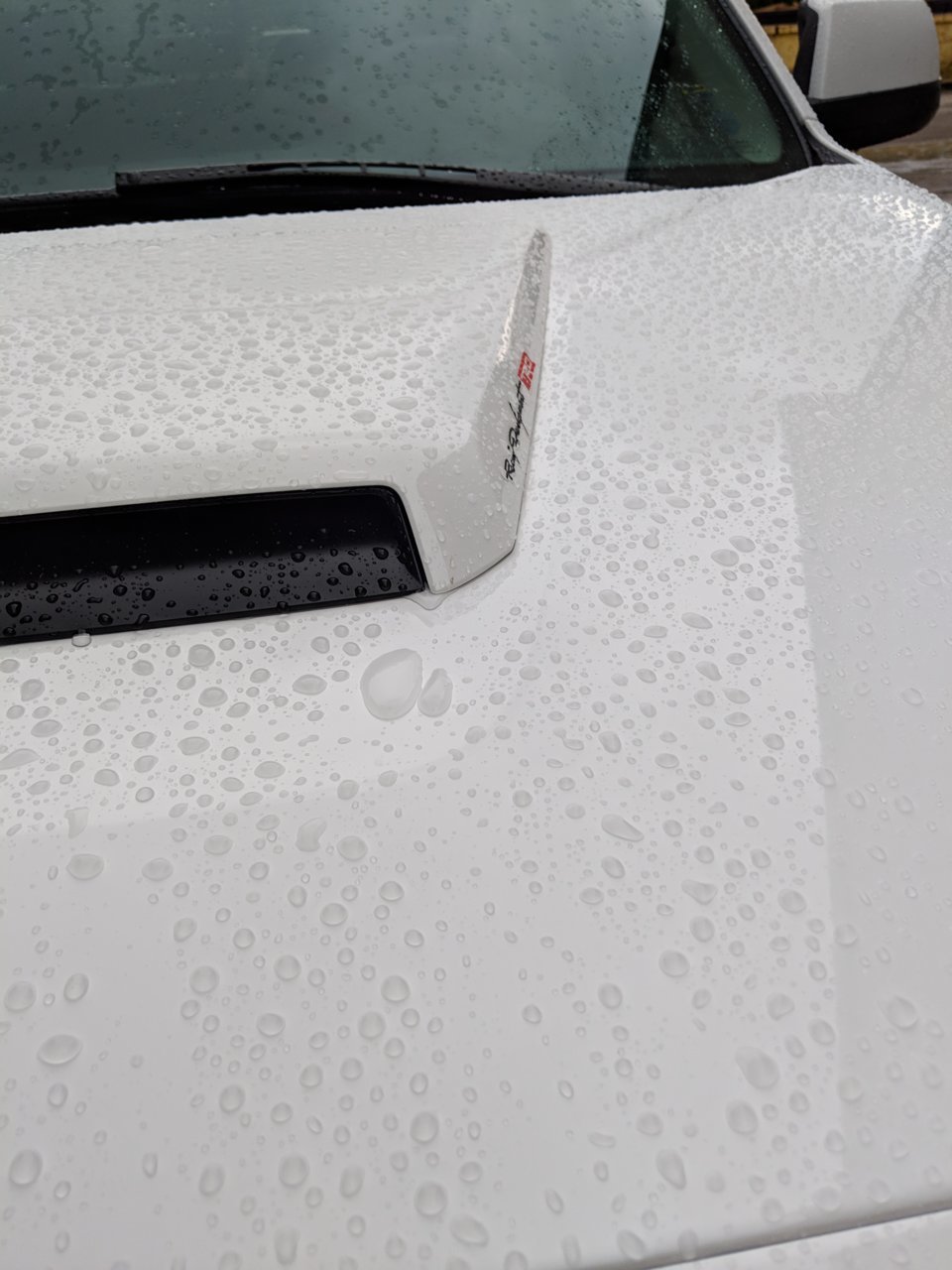

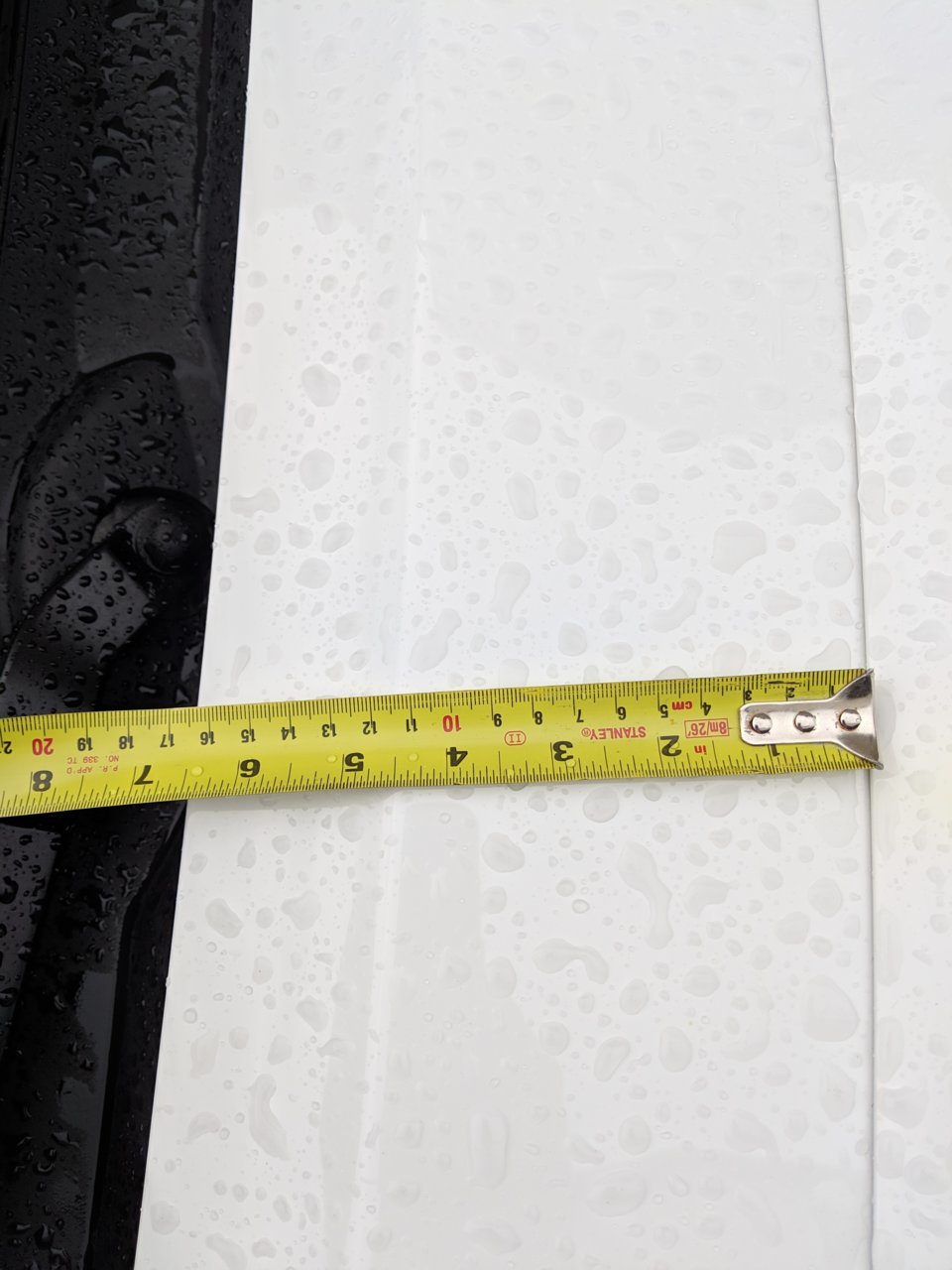

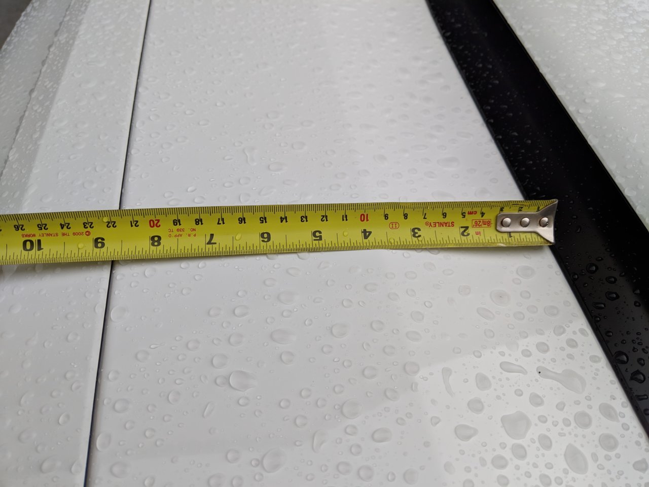

    I happened to see these pictures on my computer yesterday; I took them for someone who asked about the scoop placement some time ago. Hopefully someone has an actual template that might be more accurate, but since I have these I can just as well share...
    8-3/4" from hood bulge to front of scoop, about 6-1/2" from back of hood, and obviously just centered left to right.
