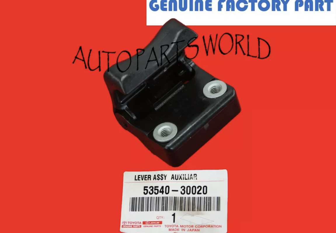

    Has anybody made a makeshift rod for the hood latch release,I have not been able to find a decently priced replacement one and my old one is long gone.
  13. Jul 19, 2023 at 6:21 PM
    bfunke
    bfunke Tundra Curmudgeon
    Oct 13, 2019

    The clips from Dorman are part #75450

    The rod comes with the latch as an assembly.

    Yeah but 40 bucks is a lot for just a metal rod,I’m sure i can make something work just wanted to know if anybody else has thanks for helping though

    Haven't seen anyone posting about making one but a few have posted getting one from junk yard. If you're near one or Pik-A-Part place, anything from 03-06 Tundra will fit.
