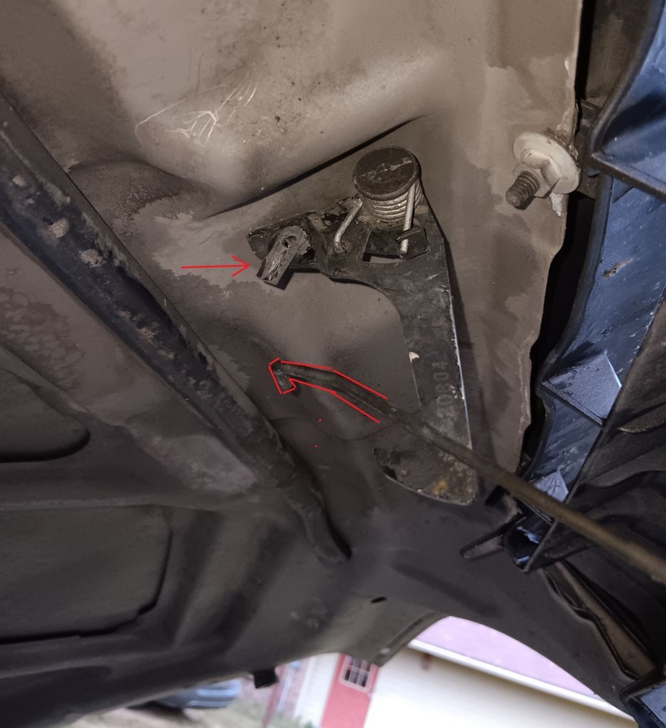

    I'm getting ready to sell my "no compression in Cyl 4" 2004 Tundra, and suddenly the hood won't open. I was able to compare against the 05 I just got and reach through the grill to pull the hood-mounted latch arm back to open it.
    The connecting rod from the hand-operated lever to the latch arm mounted on the hood appears to have broken free, and I believe it's a plastic piece that's missing. I cannot locate this part on Rock Auto. What's it called, and is there some other place I should be looking for parts?
    I've highlighted the loose rod, and put an arrow pointing towards the area it's supposed to go.

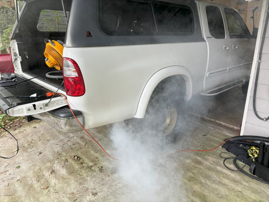

    And just to reiterate this is a safe product, one which I use as routine maintenance to avoid stuck valves and other issues, here is proof from when I treated my truck this spring. I probably shouldn't have done this right after shampooing out the carpet on my camper shell roof :rofl:

    I followed his method to the letter, that's the proper way to do it.
    Seafoam (on their FAQ/support page) cautions against sucking fluid into the intake using a vacuum hose. I guess some aggressive people tried sucking up a whole bottle at once and hydrolocked their motor? I thought that was urban legend! They don't directly say it, but they warn against it.
    My truck was smoking heavily for a good 5-10 minutes of idling after hot soak. It dredged loose a TON of deposits to be burnt. And my truck only has just shy of 80k original miles!
