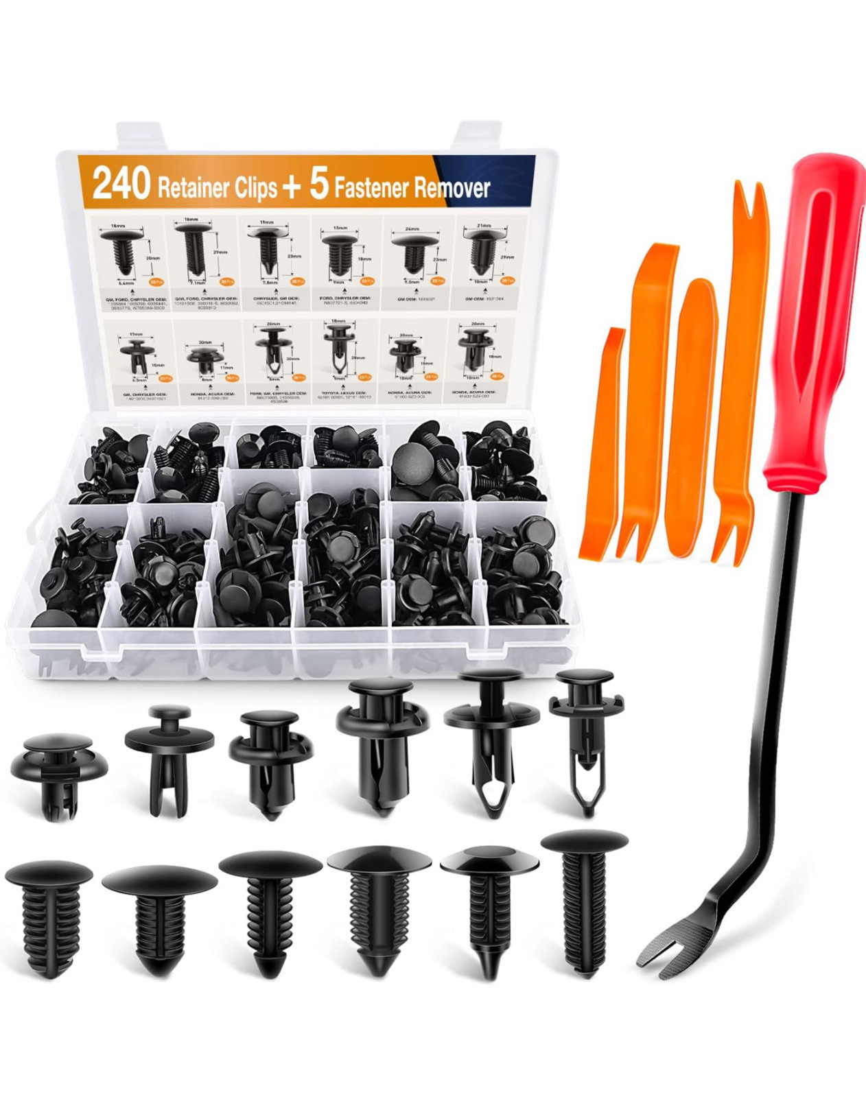

    I got a kit like this on Amazon and usually try out different clips on my cars until one looks the same or fits right.

    I bought the Amazon kit Thursday and my bulge popped out on the way to work Friday! Ha! Annoying as my bracket os 100% broken as why it popped out...I with try some epoxy first by may just replace it for a newer chrome one...yowza!
