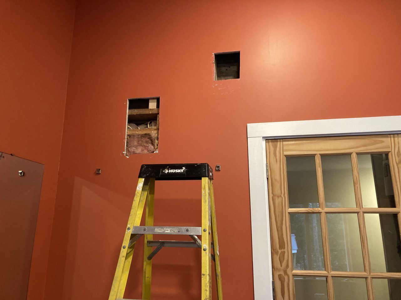

    I just spent a week tracing and unfucking everything the prior owner of my home touched (an ongoing theme the last several years). Tapped into whatever he happened upon and the entire upstairs loft was tied in with the back porch on the other side of the house, then fed a handful of random outlets in the gym. Grounds all cut off and 14/2 mixed with 12/2 on a 20A.
    I fished a new feed and put the loft on its own 15A (3 LED can lights and four outlets). It involved tiny hands, demoing the wall in two spots to access the panel then over one bay to the first outlet.
    This place is from the 70s though, yours ‘should’ be straightforward but to run a new feed will either involve some sheetrock demo or being a magician with a fish tape depending where you need to go and whether theres holes in the studs you can sneak through. You’ll have to trace and separate the outlets if you want to split the branch but shouldnt be too bad. Whatever you do, label your breakers and dont suck. :rofl:
