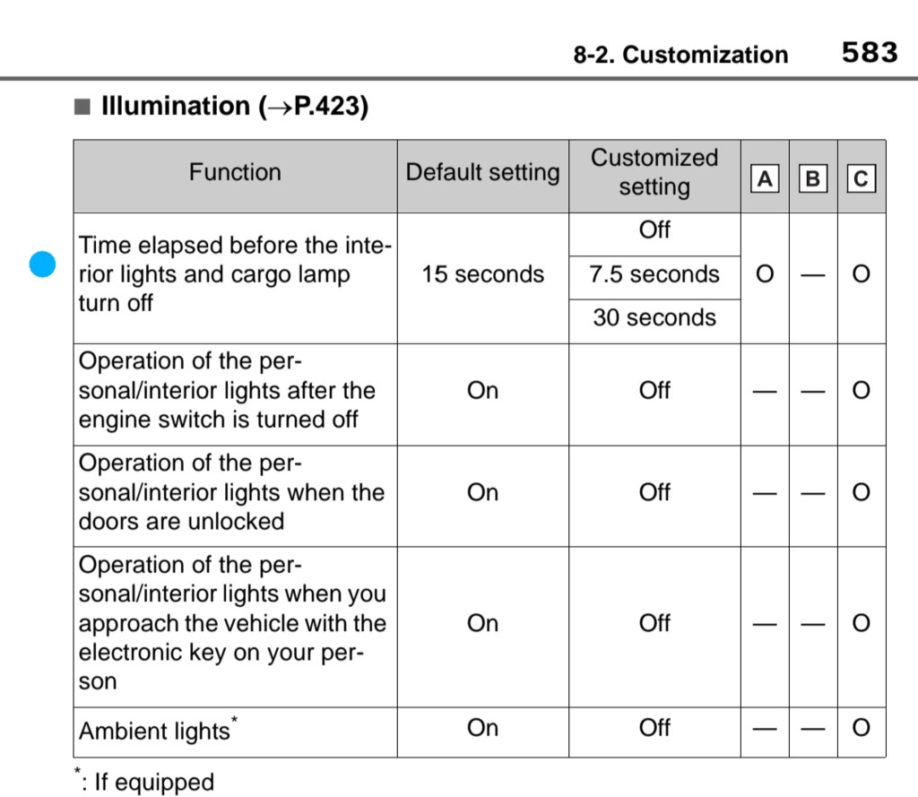

    Okay, I could have sworn I saw an option for a timer, or maybe an on/off option, for something called a Home Light..Get Home Light…or something along those lines. I either saw it in the infotainment settings or in the Carista app. But, I cannot for the life of me find it again.
    2 questions:
    1. Am I going crazy and have dreamt about that?
    2. If I am not going crazy, where is that setting and what exactly does it do?

    Your not crazy. It is real. I think you get to it in the multimedia display. Try digging down through the settings.

    I don't have my truck here, but I think it may be under doors.
    I also think it is in Carista if you have one.

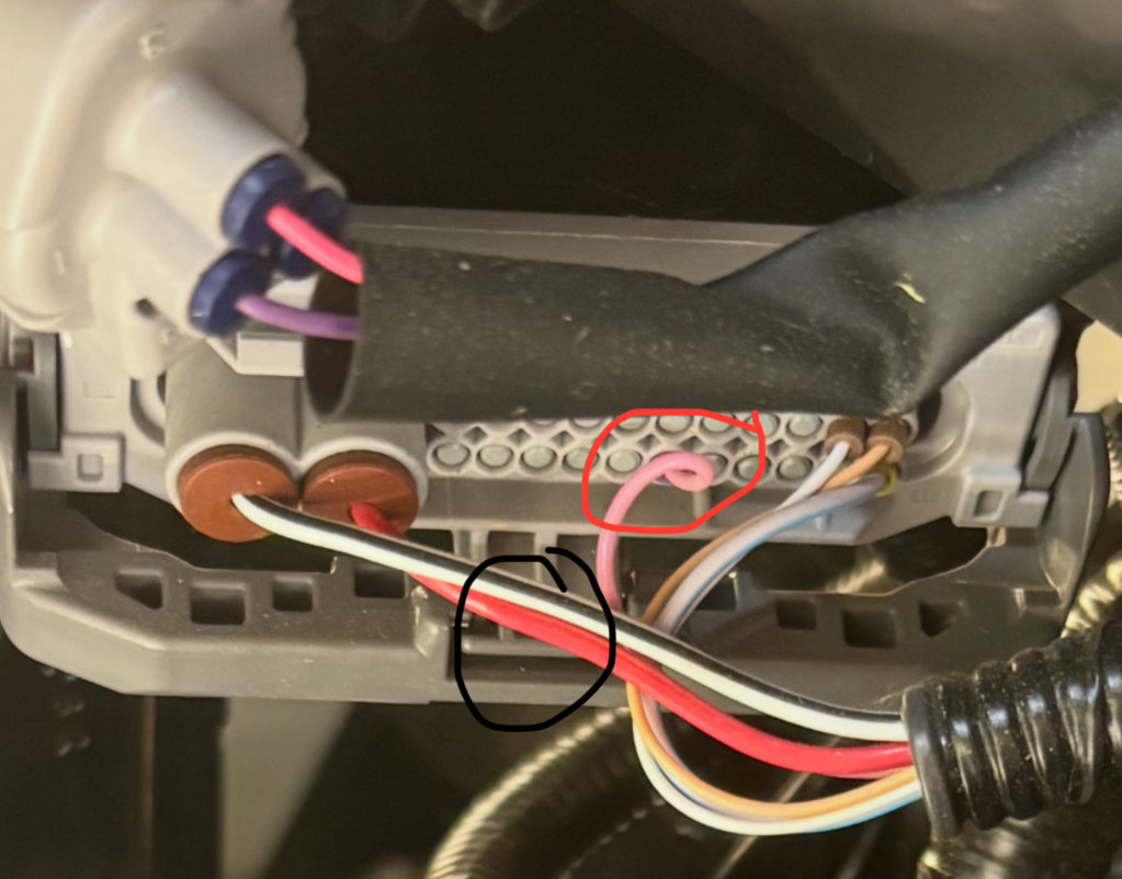

    I installed vent lights and grill lights and have them powered with the thick red wire from the passenger headlight (premium headlight). When I turn my truck off and lock my truck the vent lights and grill lights stay on for about 10-15 seconds (all other exterior and interior vehicle lights are off).
    I was wanting to look more into the “follow me home” settings to see if that setting could be why the lights are staying on and, if possible, adjust that setting.
    However, I cannot find the “follow me home” settings

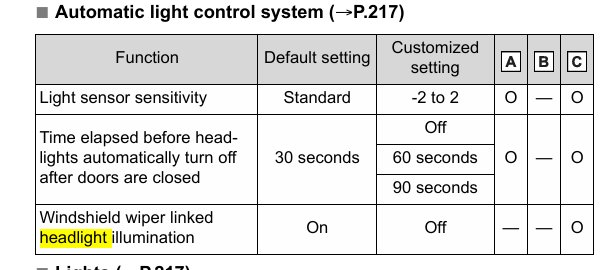

    The headlight delay? It has auto off timer for 30, 60, or 90 sec. It’s in the infotainment setting. Vehicle customize and Lights. Auto off timer.

    My factory headlights are not having any issues at all. What I am describing is happening to the vent lights and grill lights I installed.
    I connected the red wire from them (12v switched wire) to the this red wire in the passenger headlight. I’m not sure of the pin # though.

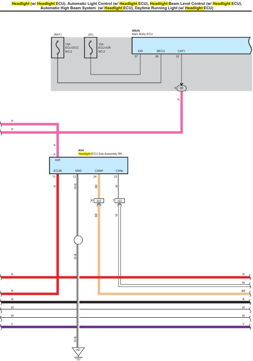

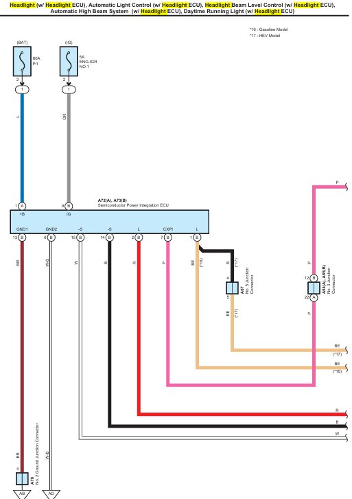

    THE SHORT VERSION: RED WIRE IS ENERGIZED AND YOUR VENT LIGHTS ARE GROUNDING THE CIRCUIT TO MAKE THEM STAY ON, THEN THEY TIME OUT.
    Why do they stay on?
    Because they have power and ground..
    The trucks combination of ECUs, that work together, don't like change.
    Maybe someone else that did this mod can tell you how they did it and if they had the same experience.
    I don't know enough about the Gen 3 'premium' headlights to understand exactly how they work.
    THE LONG VERSION:

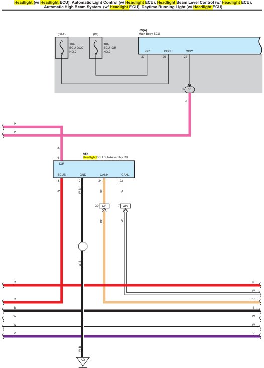

    Follow the red wire from the first page to the third.
    It's the red wire from the Semiconductor Power Integration ECU to your right-hand/passenger headlight ECU.
    Not sure what exactly it triggers, but it sends power to your RH headlight ECU.
    The beige wire from the Semiconductor Power Integration ECU is the same feed for you driver's/left headlight.
    Since your vent lights have their own ground, whenever they are powered, they come on.
    Whatever ECU signal then times out when you shut the truck down.

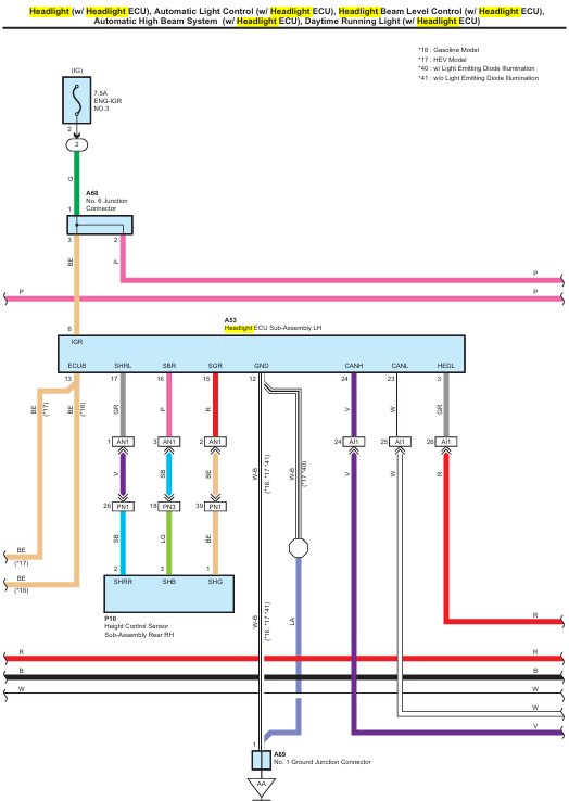

    upload_2025-5-17_17-43-1.pngupload_2025-5-17_17-43-17.pngupload_2025-5-17_17-43-36.png

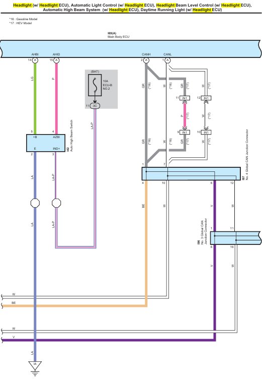

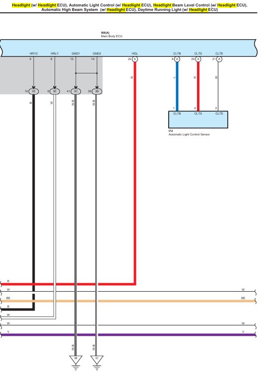

    There are other factors that tell the headlight ECUs if the low or high beams should be on, which is controlled by the main body ECU.
    Follow the beige and white wires from the RH headlight ECU to the main body ECU.
    Those wires are violet and white for the LH headlight ECU.
    CANH and CANL, high and low beams.
    upload_2025-5-17_17-53-30.pngupload_2025-5-17_17-53-46.pngupload_2025-5-17_17-54-2.png
    Good luck...
