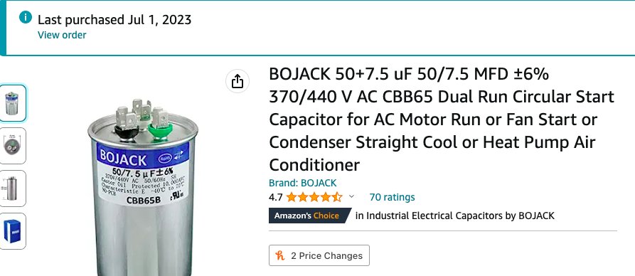

    From the parking lot I ordered this, same day delivery.

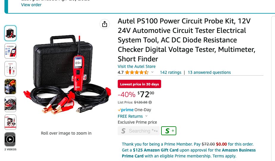

    I have this but it's a bit of an ordeal to use, will it give me what I need?
    About this item
    • 【ALL-IN-ONE POWER CIRCUIT PROBE TESTER】Autel PowerScan PS100 is goal to reduce circuit diagnostic time in all 6-30v vehicle electrical systems. This automotive power circuit probe supports voltage & polarity test, continuity test, signal circuit test, components activate, check bad ground contact, locate short circuits etc. This is a wonderful Christmas present for man/dad.
    • 【FOUR MODES】The circuit probe kit’s 4 modes : DC voltage: read the DC voltage with a resolution of 0.1 volts. AC voltage: read the Max/Min voltage, frequency, and duty cycle. Resistance: read the resistance between the tip and auxiliary ground lead. Tone On/Off: technicians use the tone in a dark environment to distinguish the test results.
    • 【QUICK SELF-TEST】With the power circuit probe tester connected, perform a quick self-test.The power switch is a momentary rocker switch located on the tool's body. Flanking the switch are positive and negative markings.
    • 【CIRCUIT BREAKER】Autel PS100 electrical tester is short-circuit protected. Its internal circuit breaker will trip if it becomes overloaded. The circuit breaker is a valuable test tool as well as a safety measure to protect the tool from overload.
    • 【QUICKLY IDENTIFY POLARITY】Autel PS100 instantly checks component continuity and identifies positive, negative and open circuits. When the positive terminal is connected, the red LED light is on, accompanied by a beep. When the negative terminal is connected, the green LED lights up, along with low pitched tone. If it is an open circuit, the LED light will not light.
    • 【20FT EXTENSION CABLE】This circuit tester comes with 20ft extension cable, 20ft+20ft allowing you to access any position of the vehicle and test it. The built-in flashlight is convenient for detection, PS100 fuse tester automotive kit can give you a good view in the dark.
  10. Jul 1, 2023 at 10:05 AM
    FrenchToasty
    Sep 15, 2019
    #36156
    18,350
    Mo
    The SoAz….. big surprise
    Bone stock
    No, I doesn’t look like it reads microfarads(MFD)
