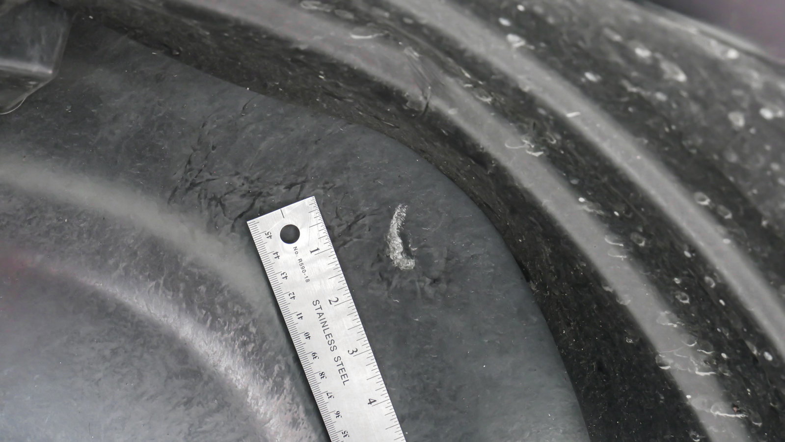

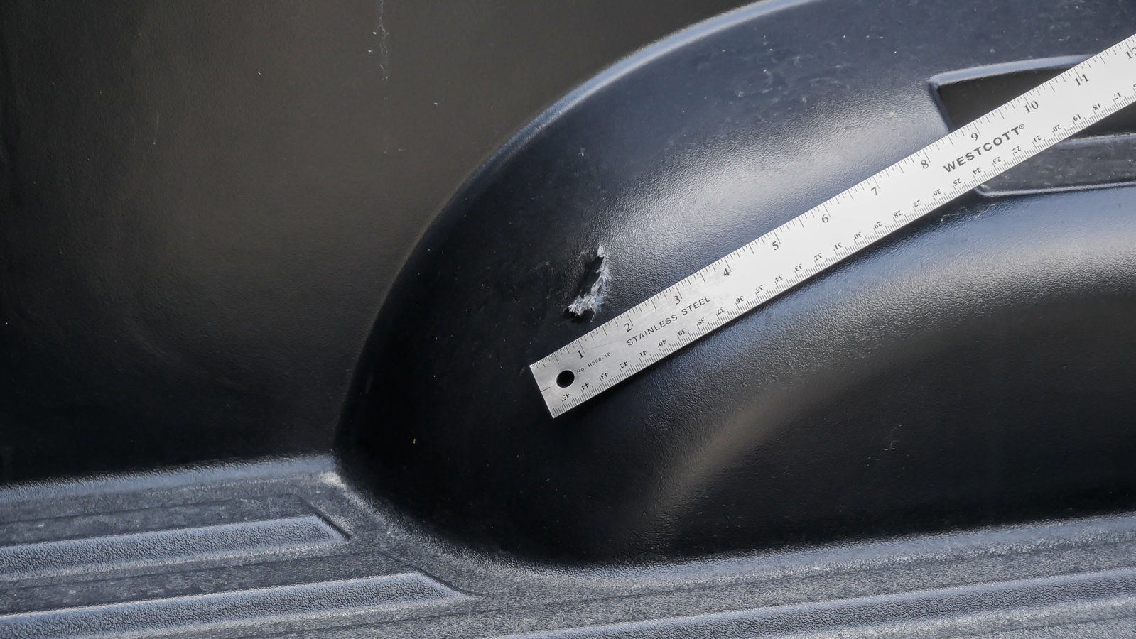

    A rock flung up from our shop's 2022 Tundra and pierced a hole through the composite bed. We all think this is ridiculous. This truck is completely stock suspension & tire wise - what would happen if we put larger AT or MT tires on? Fling up a larger rock and puncture a larger hole in the bed?
    Repairing the bed is going to be $$$ and might be tough to even find someone skilled in fiberglass repair. We're thinking that we might have to visit a boat repair shop vs. auto repair.

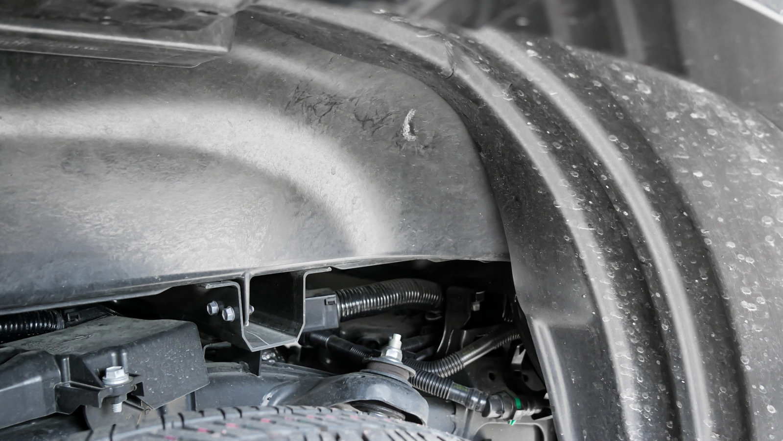

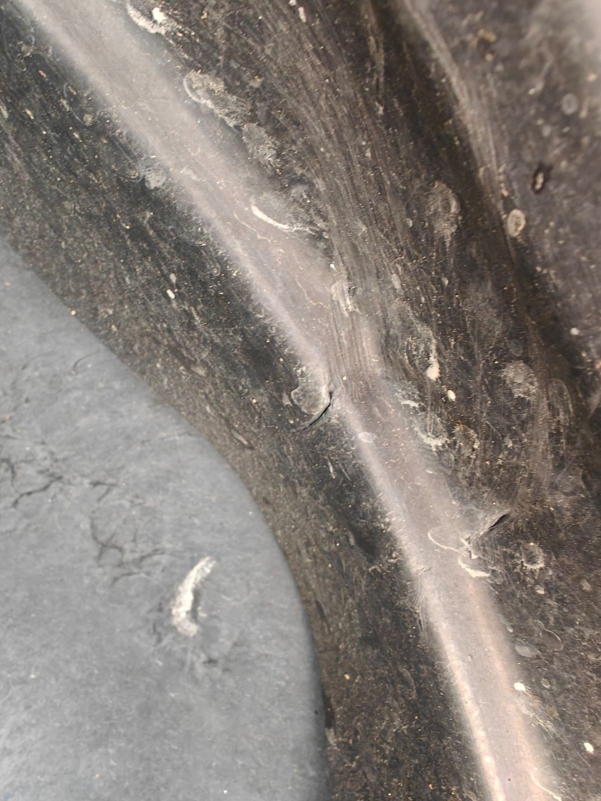

    Interested to hear your guys' feedback on this and if this has happened to you. You can also see in the pictures that something else hit the upper wheel well liner just to the right side of the bed hole but didn't pierce through. We're thinking of developing a form of liner extension to cover the rest of the bed. Would anyone be interested?

    Yes, looking underneath, there seems to be way too much open space compared to the 2nd gen. Also heard of rocks taking out the tails from underneath ...no bueno.

    Yeah, or you're on a trail out in the middle of nowhere and a rock takes out one of these important wiring harnesses? No thanks.

    From that image, the damage is in front of the tire? If so, the object followed the tire around? Considering the large damage area in the image, much have made a heck of a noise and heavy.

    I wasn't driving it so I can't vouch for the sound, but a rock probably got trapped in the tire tread and flung up.

    Or the damage happened while in reverse-

    Definitely sucks, but this seems to be the first report of a hole being created in the wheel well of a 3rd gen. Could just be bad luck but there could be a market to add some additional protection

    There is other damage in that wheel well that looks to line up well with the hole. Like there are holes in the plastic fender liner as well.
    To me that seems like it was something really big (not just a rock) or more likely based on how they line up, someone jammed something in from the outside and just happened to get lucky and stab it into the fender.
    Those beds are SMC. Anything that would poke a hole like that would have badly dented a steel bed. I don't think that it was a rock.

    Seems to me it might have been something lodged in the tread and released at a high rate of speed.

    We just spoke with a top guy at Caliber Collision and he said Toyota doesn't allow for repairs on the SMC beds, and if you go to a body shop that follows manufacturers' guidelines, you have to replace the whole bed. :eek:

    dont think that was a rock

    looks like something you would see happen if you were driving with chains on and it broke loose. Agree - not a rock. Wheel weight maybe. Use some JB Weld to patch it and move along.

    Could have been a lug nut or something else, but something on the road
