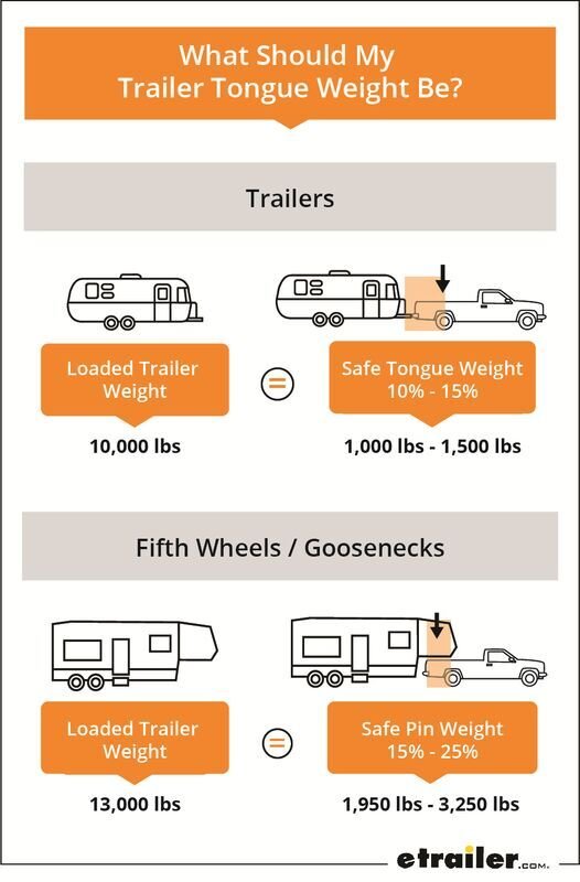

    Tongue weight should be 10-15 percent of total trailer weight.
    Max towing for my 2wd crewmax is 10k. ymmv
