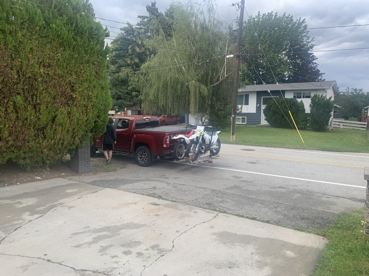

    I know I am over working my hitch on my 2019 Double Cab. But I want to know by how much with a reasonable degree of mathematical accuracy.
    Here’s the facts.
    I welded an aluminum double motorcycle carrier that weighs around 150lbs. It takes 2 bikes, one in front of the other. Each bike is 240 lbs. The weight of the first bike is placed 15” from the end of the receiver and the second bike is 35” away. See a picture of the configuration when my son and his buddy borrowed my carrier.

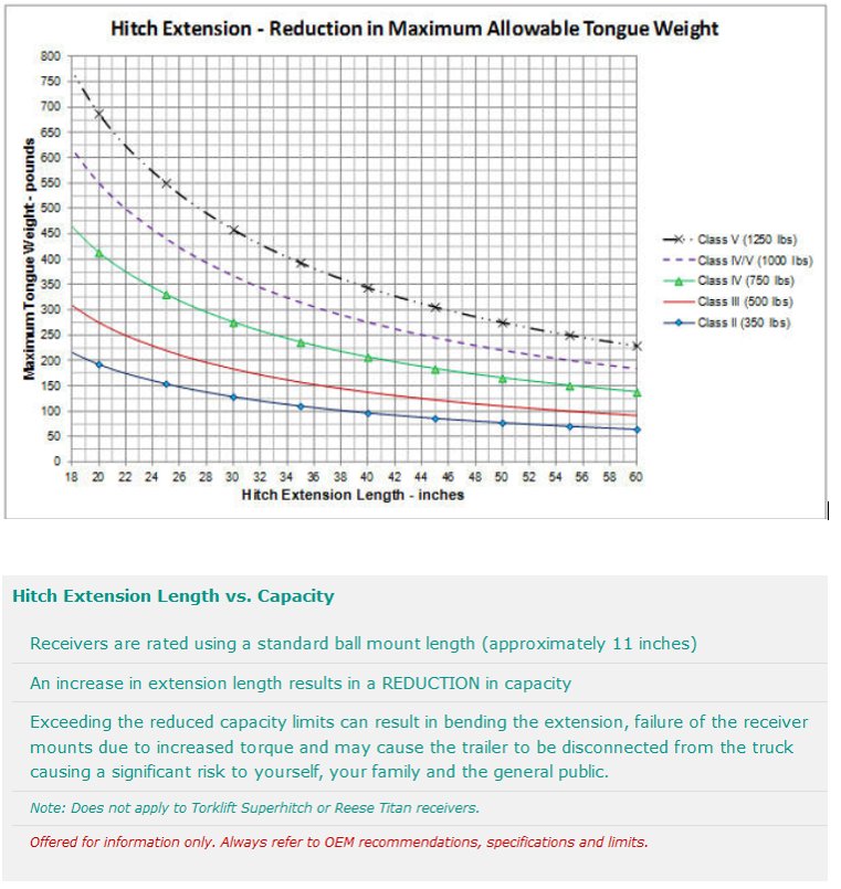

    I think it might be @Sundog that has information that may be helpful on his signature. If using a phone you may need to rotate it.
    Thanks Sundog!

    This is a great graph and it supports what I thought was happening. I’ve got around 650 lbs of static payload but it extends up to 35” past the receiver. The dynamic aspect of it is the surprise as you hit dips etc on the road. Thanks for the chats, gents.

    The 2018-2021 Tundra is rated for up to 10,200 pounds on the factory hitch setup. With the 10% rule that gets up to 1020lbs of tongue weight, so I'd follow the purple dashed line in the graph, then on the physics of the thing, the torque that the hitch experiences is the *average* distance of all the weight.
    In other words, if you replace the two 240lb bikes with a 480lb block of lead, you would put it half way between where the bikes would have been. So, use the distance half way between the bikes as your lever arm length.
    25" on the purple line is 450lbs, so yeah you're over by a bit. Is it enough to worry about? probably not... but I like the idea of throwing a couple straps over the bed to distribute some of that weight off the hitch and bring it further forward.
