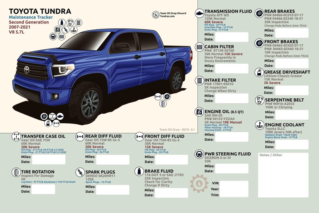

    Not sure it goes that high but here's this :monocle:

    Why front diff OCI is 1/2 of rear diff? "Normal" is 2WD, front diff is not loaded at all.

    I'm not too sure I agree with this chart on the diffs. Seems backward to me on the front and rear intervals. I didn't change my diff fluids until 60k. When I drained it was obvious the rear diff needed it and I'm going to do 30k from now on on it. The front diff fluid looked almost as good as what I refilled with and smelled like fresh gear oil. Wasn't hardly anything on the magnet, unlike the rear. I don't drive hard, I tow very little and not heavy (there might have been 1500 miles of towing no more than 4000lbs on it in that 60k) and I use my 4WD on occasion. I have no problem going to 60 on the front diff after what I saw in mine; maybe I'll regret that at some point, who knows.
