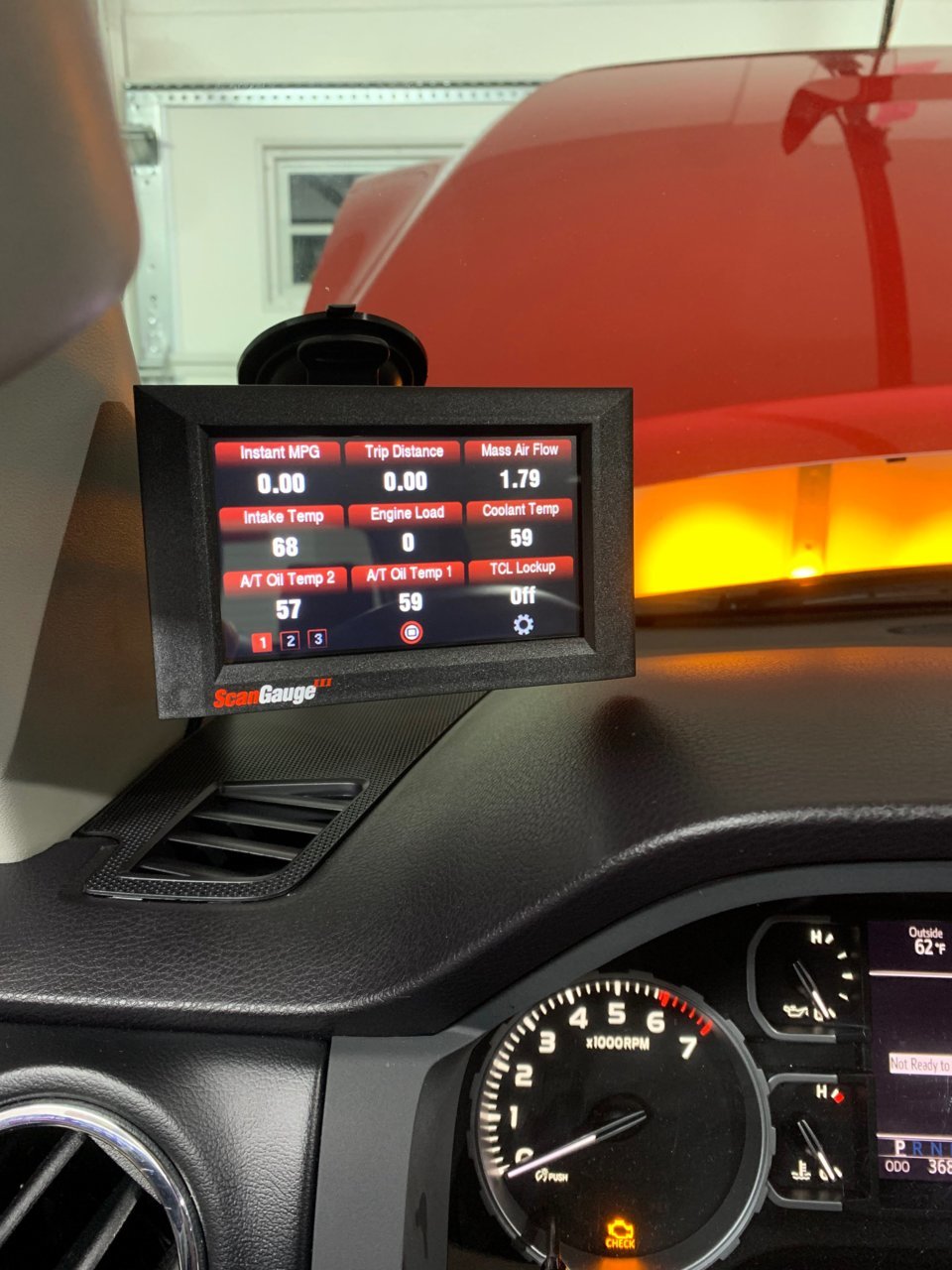

    Also looking for an updated gauge system that will help me monitor transmission temp, etc.

    I’ve got the Scan Gauge III and really like it. Can monitor a lot of items all at once.

    I use the OBD fusion app and an OBD reader purchased off Amazon. Gives the pan and converter temp readings.

    Are you able to get engine oil temp with the III?

    I can’t remember, I will check today and up this thread.
    *Update does not appear Toyota offers an engine oil temp to display.
