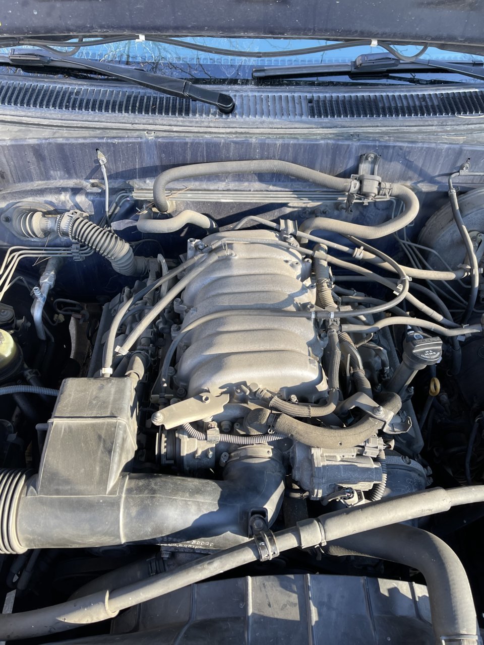

    Anyone know if there is a EGR valve on this engine? All the pics I can find don’t have what my engine bay look like444B5710-818E-435C-853C-874E4E5836BC.jpg
  10. Feb 7, 2022 at 10:43 AM

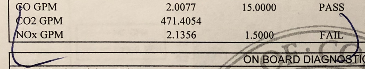

    Barely a point. Last time the limit was 2.0, this year it went down to 1.6 and the truck is coming in at 2.3

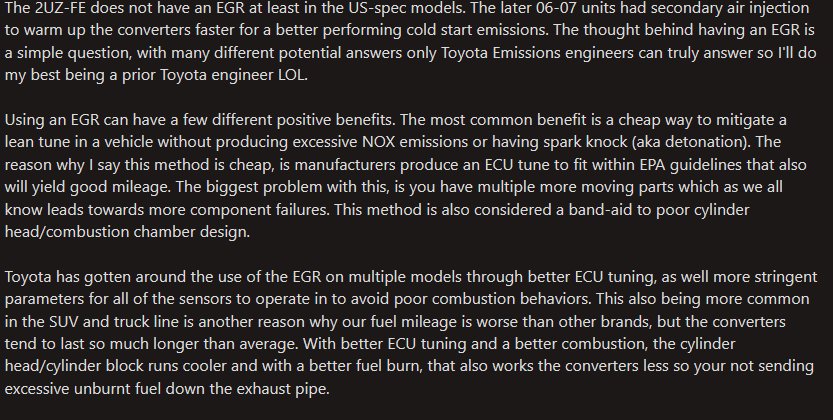

    From over at ih8mud forum.
