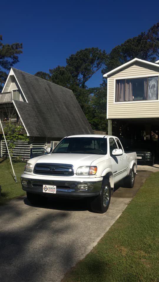

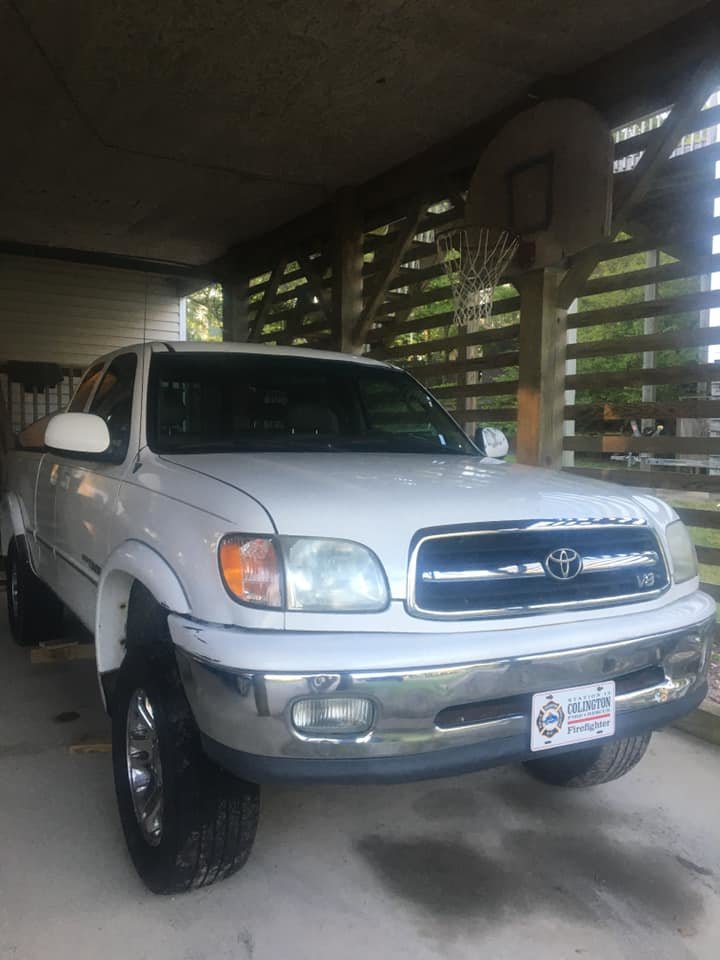

    Hey guys,
    So theres a 00 Tundra Limited (4.7) for sale near me, and I'm interested in it. Just wanted to get your guys thoughts. It's got 320k on the body, but a little under 100k on motor and tranny. It's got new ball joints, rear wheel bearings, tail lights, blower motor, PS pump, and a bunch of other stuff. It isn't perfect cosmetically but it's not terrible. They're only asking 3000 for it (needs rear brake work and 4x4 work think it's just the actuator).
    Now mind you, I live in the Outer Banks, NC. Vehicles rust away down here to the point that they will no longer pass inspection or frames will break etc. So that's why I'm looking at a cheap truck. As long as the frame looks ok, I don't care what the body looks like.
    Just wondering...would you guys run away due to the amount of miles on the chassis? If I go look at it, and the frame isn't rusted beyond belief, and everything else looks ok and it drives ok....go for it?
    Thanks in advance!

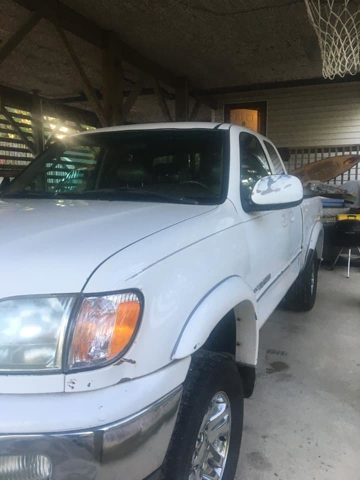

    The body isn't beat up by any means, it's just not flawless. And she said the 4x4 light is blinking and will not engage. So I'm guessing sensor or actuator.
