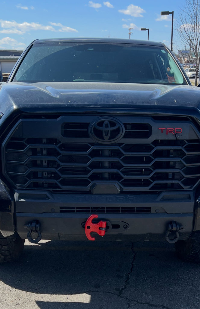

    Installed a rough country hidden winch mount and winch today. Seems pretty rigid. Steel cradle bolts to the frame. Didn’t have to move sensors.etc IMG_9183.jpg

    What winch did you use?
    I have the SDHQ hidden winch with the fully remote control and a wire rope cable.

    I bought it with the 12,000lb rough country winch. It’ll be for occasional use. Not full time heavy off roading.

    How do you access the clutch and attach the controller?

    Top right of grill by red trd is remote plug - can power in and power out. You’d have to reach underneath bumper to release- free spool
