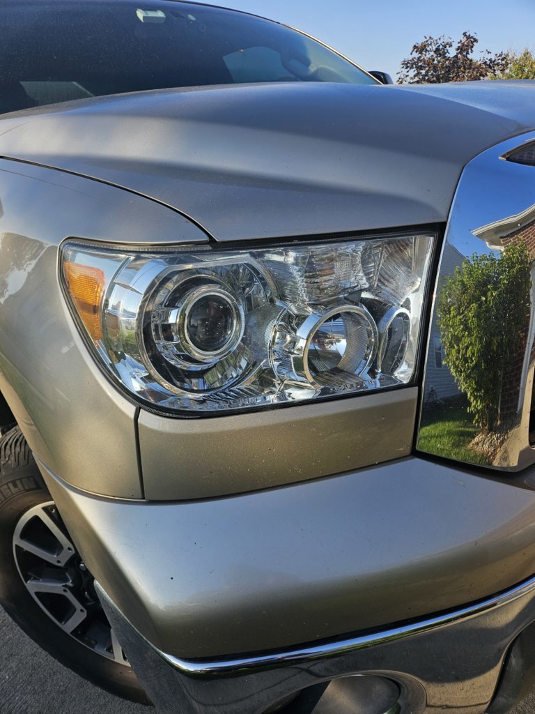

    I've got Mini D2S 5.0's with Apollo 1.0 shrouds. Also mini Gatling Gun on the LED highs.

    Definitely do a lens off alignment before sealing them up. The highs seem to need a little extra vertical adjustment vs level with the reflector housing.

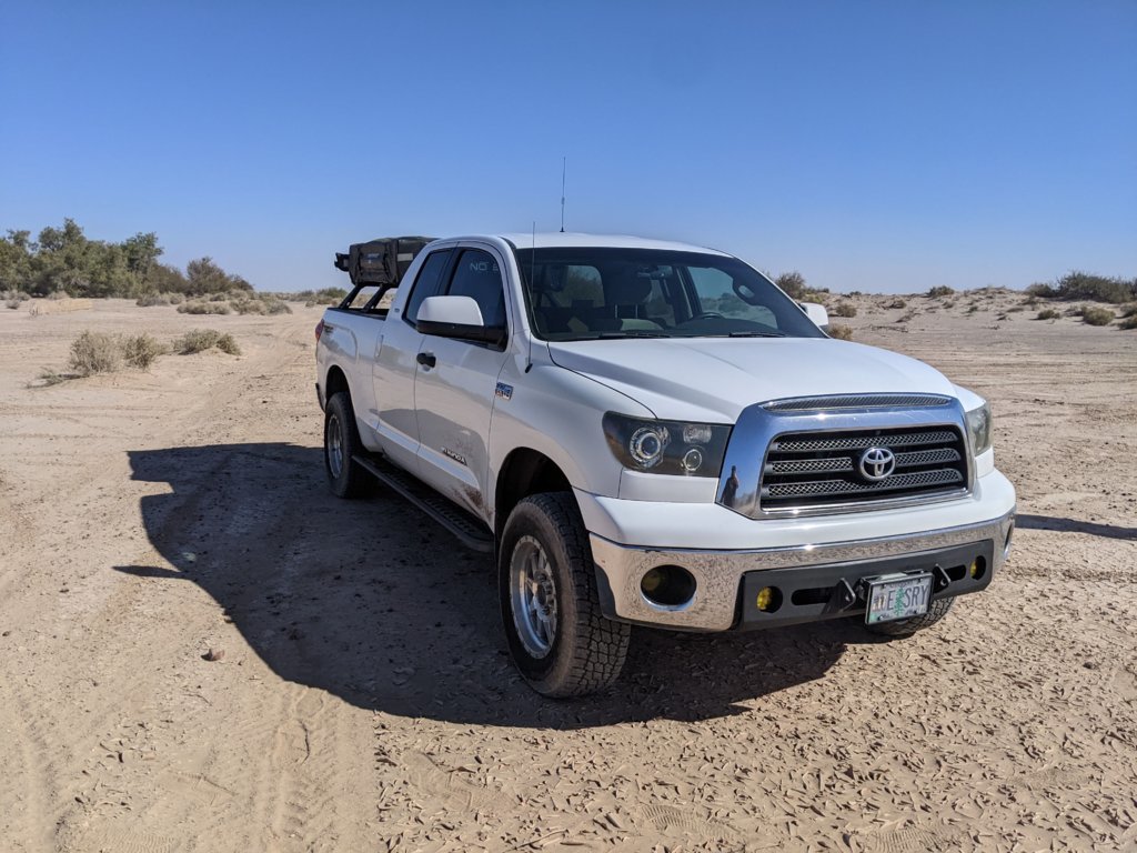

    It's been 5 rock solid years on my OEM-ish looking bi-xenon budget build. G5-R and I don't know what the shroud is called. I did have to reseal one lense but I reused original butyl so that's a risk you take. Still the best upgrade I ever did on my old 4runner and this truck.

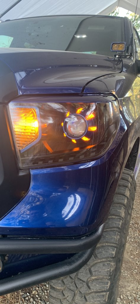

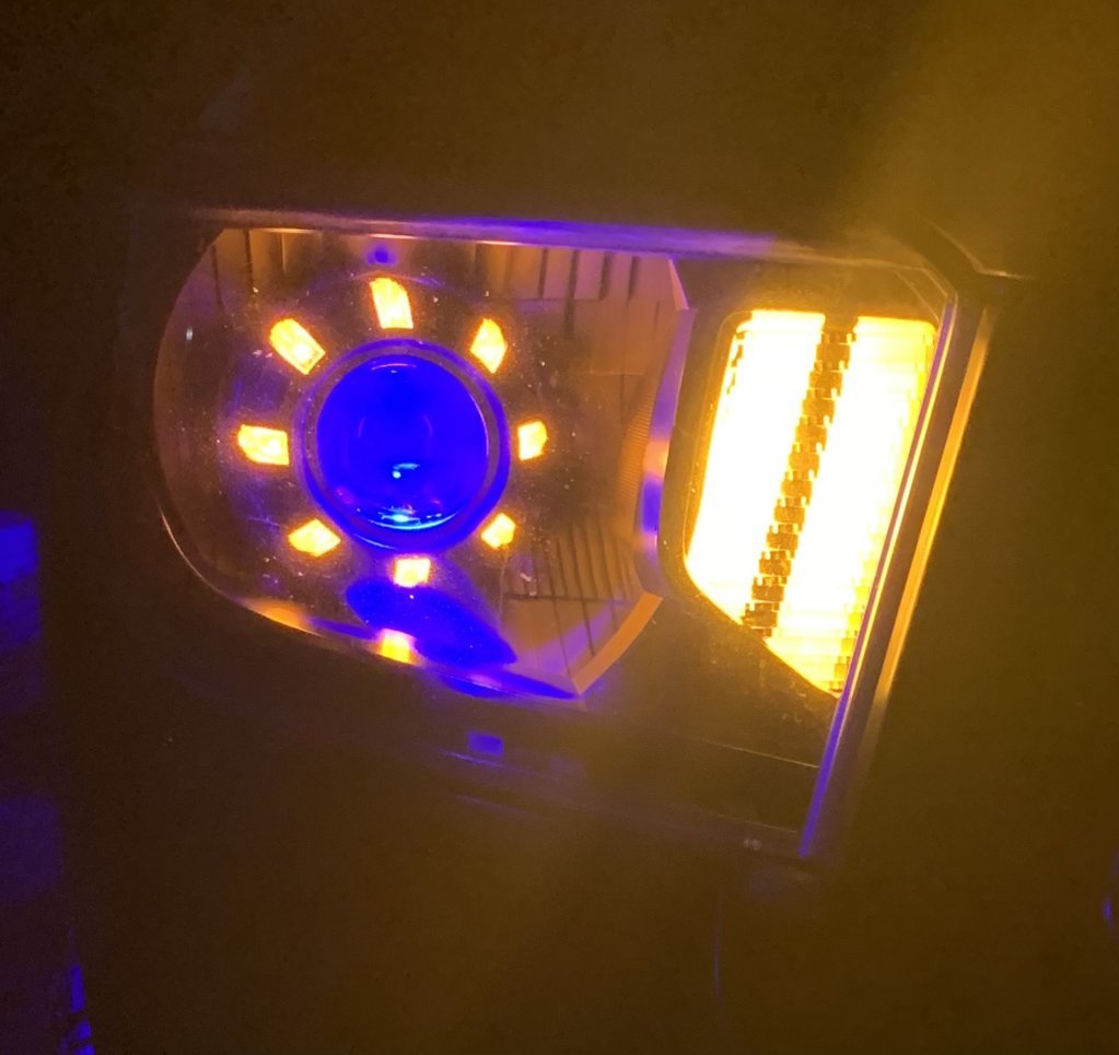

    In my opinion, any of the round shrouds look good in the 2nd gen, especially if they’re backlit. Angel eyes are old enough to make a comeback, too. I stayed classy, but kept just a little flare when needed. I have a 2.5 gen, but pics are always cool for reference.
    Cr500taco[OP] likes this.

    Do you have the in cab headlight adjusters?
  19. Dec 30, 2024 at 6:27 PM
    Cr500taco
    Cr500taco [OP] New Member
    Jun 26, 2016
    #3700
    48
    What shrouds are those?
  20. Dec 30, 2024 at 6:40 PM
    VWTim
    VWTim Mid-Travel Crew
    Mar 1, 2021
    #59814
    764
    Corvallis, OR
    Nope, truck is an '07. I've almost retrofitted an adjustable set on accident, they are similar internally but not exactly the same.
  21. Dec 30, 2024 at 7:28 PM
    BlueRibbon4x4
    BlueRibbon4x4 Let’s color match it
    Aug 16, 2018
    #18204
    3,319
    Geno
    2015 Blue Ribbon 4x4
    Bullet 2.0
