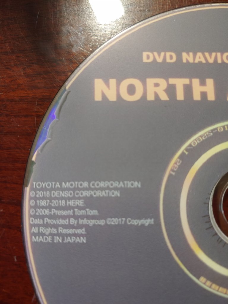

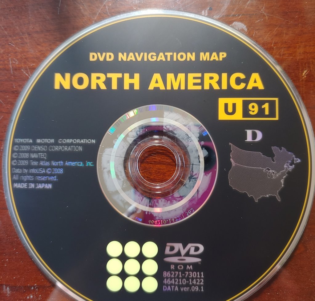

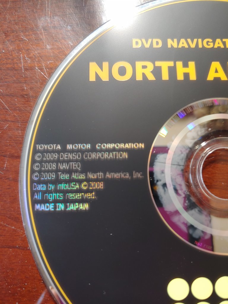

    I have owned my 2010 Toyota Tundra platinum CrewMax for 5 yrs. and am the 2nd owner. For the first 2 yrs. everything worked fine but about 3 yrs. ago I started having small intermediate problems with the map, GPS navigation system, not enough for me to bother with it at first. But over time it has been getting a lot worse. So I then about a year ago I bought a new updated DVD on Ebay or Amazon, can't remember where and replaced the old with new DVD, now but it is doing the same thing maybe even worse because now when I Start the truck it is taking a while for it to upload and about within every 5 to 10 minutes of travel it starts going in & out and acts like it is re-booting. It will say on the screen " No DVD Please insert map DVD" and then it will load and do it all over aging with the new DVD in it. So’ it is not even acknowledging it or if the radio is on that will also go out at the same time. When the truck is cold it is even worse. I don't know if I did not do it all right or bought a bad DVD. Even wondering if I may have a loose connection in there somewhere. I have included copies of the original DVD disc & the new one, the 1st two is the original & the 2nd is the new. Please any advice could help! This is driving me crazy! LOL

    Sounds like your Data drive is failing.
    I am sure this is not what you want to hear, but that system is wildly outdated. I replaced mine with a Carplay unit almost immediately when I got it in '22.
    Cel data based nav is much better than anything that system can offer plus you get all the other Carplay/Android Auto connected features.
