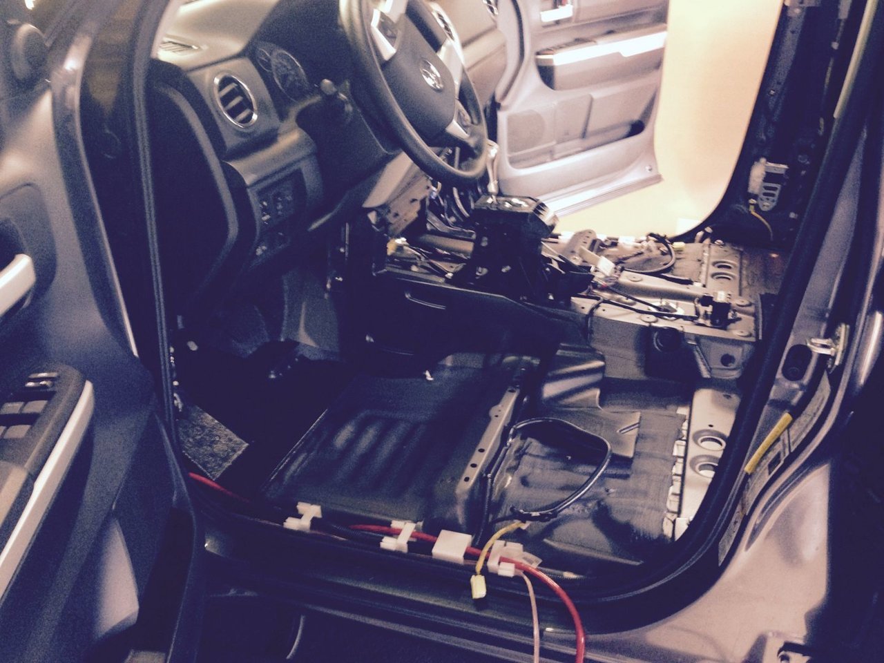

    Pop the door threshold off, remove the kickplate (one plastic screw) and the carpet will lift back enough to see under it.
    Pull the seat bolts out and lean it back to get more access to the floor.
    The carpet is tucked up under the console so it should just lift back.
    Or just go balls out and remove everything like I did...:cool:
    E60642F3-1540-4DF7-B2BD-509CFFFF85EA_zps_72050eee92000de975081d9a884a524e5f660677.jpg

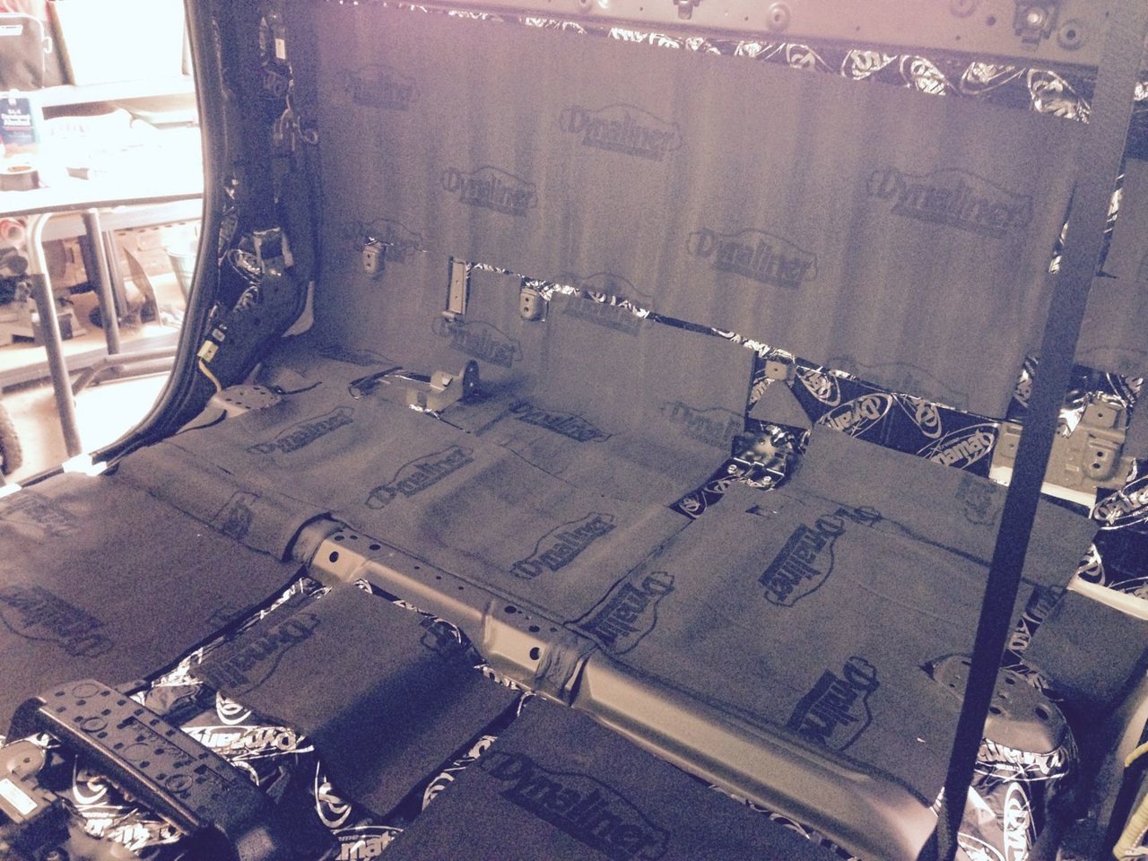

    That was for my sound deadening install..:D
    47332915-4D32-4748-BED7-CDC3C5B5250B_zps_f54b398b86967077b8372d89614168e9901b0646.jpg
