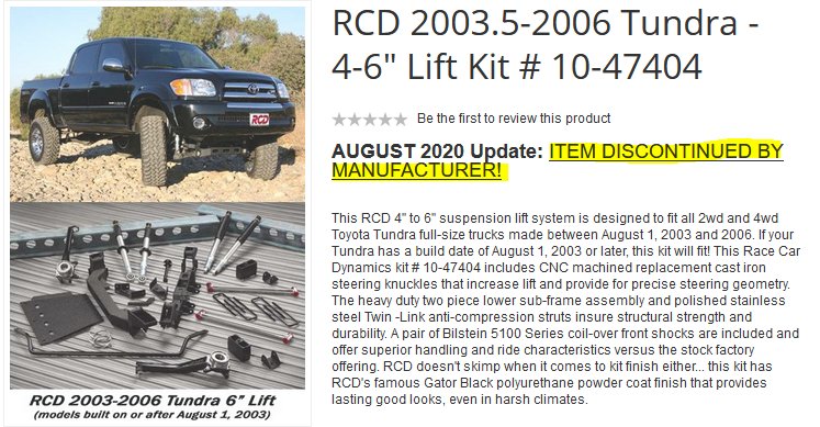

    This should put you in the right direction for research, OP.
    Just a heads up, very few 1st gens on here run drop bracket lifts so you may be pressed to find someone with first-hand knowledge. A lot of us "lift" by having adjustable suspension/ shocks as TRDgen said.
    I looked around and found this about the RCD kit. Maybe there's a few vendors with leftover inventory?
    I think the other brand that offers drop bracket lifts is Tuff Country, and they have two options: a lift with longer spindles and one with a spacer that goes between the spindle and upper ball joint. If you get a Tuff Country lift, get the one with longer spindles.
