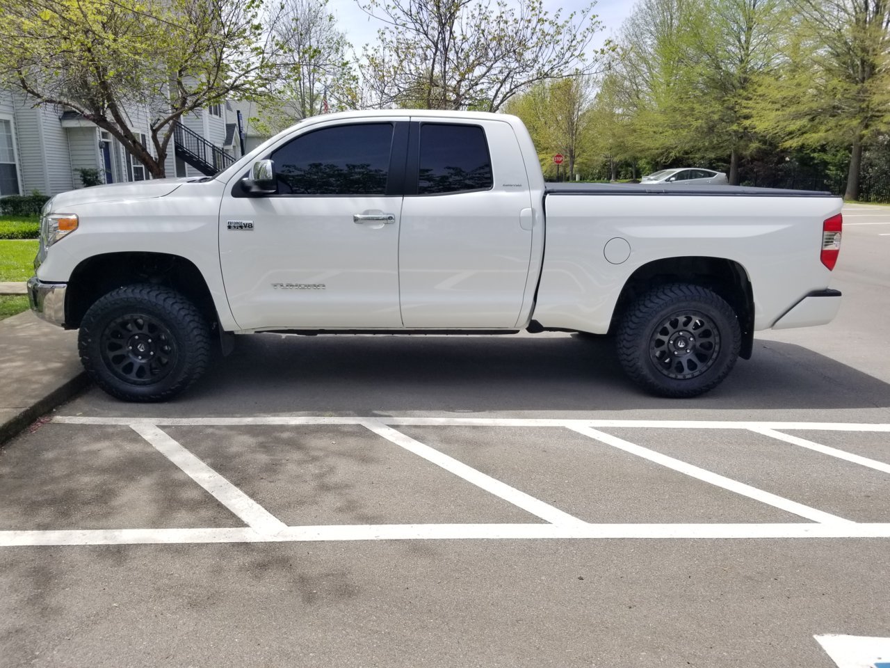

    Just picked her back up this morning. And I'll be honest I was a little nervous about the tire size, as I haven't found too many trucks with this size.
    Rough country 3/1 leveling kit
    Fuel vector wheels 18x9 +20mm
    Amp all terrain tires 305/60 18
    No cutting. Only had to remove front well mud flaps. Zero rubbing. I couldn't be more pleased with how it turned out. Hope this helps someone out!

    Looks good! That’s my next tire size for sure.

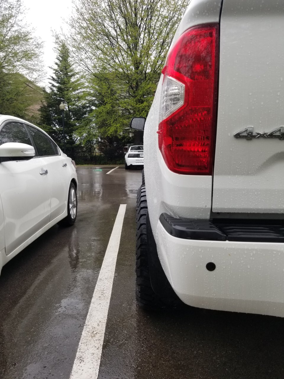

    Welcome. Looks good!! Do you have any side shots to show the width of the tires? Thank you

    Looks great. I’ve been looking at those wheels. Did the truck have 18’s or 20’s stock?

    Hot damn that's a fast ass looking truck!

    It had the factory 20's @teedubbya which are for sale lol

    @seniramsu here you go man. No flares no spacers.

    That is the perfect stance IMO!!!! Looks great and thank you again.
