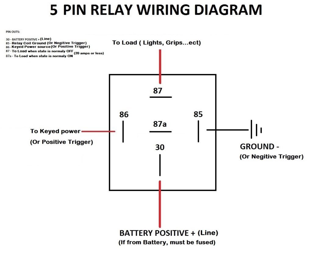

    Do you have a relay? You will need one if you are trying to go off an existing switched circuit. That acts as a trigger rather than the main power source. power goes from your tapped fuse and battery through the relay.
    If you are not going to use a relay, then it is straight to the battery rather than off a switched circuit. The switch though needs to be rated for the draw, and that’s outside my wheelhouse.

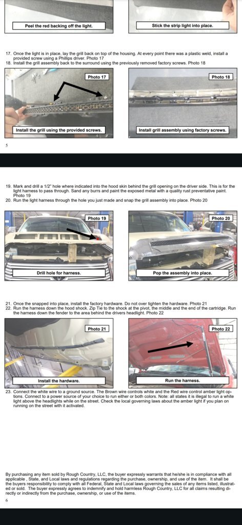

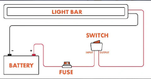

    I actually bought a 30 amp relay, 10 gauge wire, and a 30 amp inline fuse yesterday. Unfortunately I've searched for any and all information about specs for these lights and have found nothing. I bought the relay but do not have a plug for it. Can I just wire straight into it or do I need to go buy a plug? If just wiring I assume the relay needs to be covered somehow, what would be the best way to do that? Here is the manual so you can see what I'm dealing with. The second photo is the last page of the manual and the last section is the only thing it says about wiring. Thanks for all your help!

    I just looked these up, and since they are an LED strip and not a light bar I’m guessing you would be fine without a relay for higher power. One review said he put the Amber wire to the low beam headlights, and the white leds to the high beam headlights using fuse extenders for each.
    do they work touching the red wire to the battery positive right now? If not your ground might be bad. I would then check red and white direct to battery and make sure the light strip isn’t defective.
    doesn’t look like you have to use both, so I can’t imagine capping one is the issue.

    I looked at them also. No spec given for amperage draw. The relay you can direct wire them with spade connectors or a universal relay plug.. Test the light first as you mentioned nothing happened, the ground to a clean connection or to the battery neg and the red or the white to the positive terminal..

    No need to cover relay. I have mine mounted near the battery on fender wall. 10 gauge wire is rated for 30 amps. Overkill for that light but will work. If you have a switch that is rated for the amp draw of the light then no need for a relay. That said I would always use 1.
