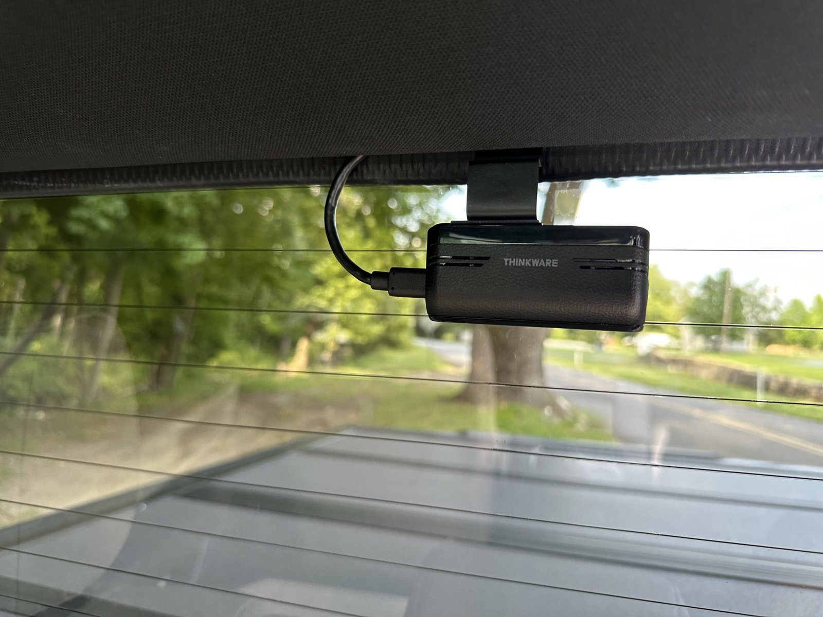

    Also keep in mind that normal tint does zero for heat rejection, u need ceramic tint to reject heat transfer.

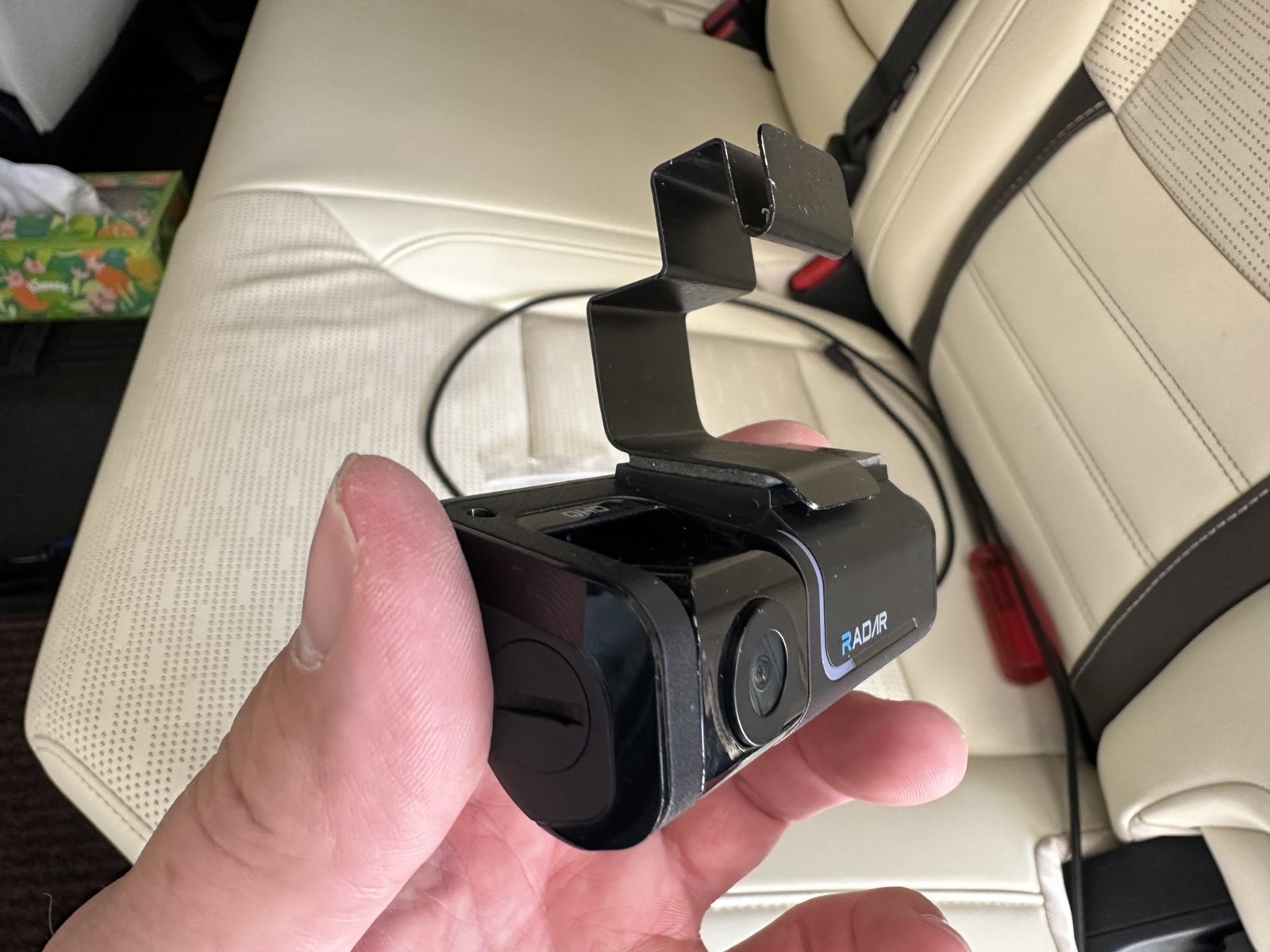

    i bought the 2” version and added two bends to it
