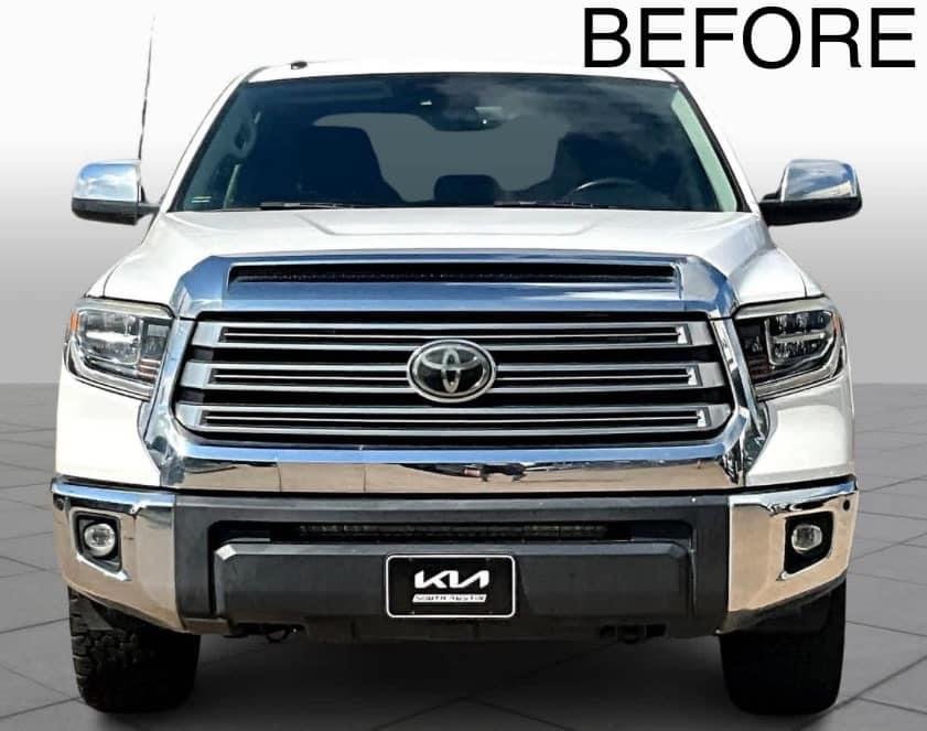

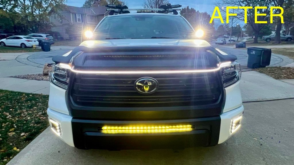

    I made several mods and upgrades to my 2019 Crewmax last week. In doing, so I removed both Front L&R Bumper Sensors for a few days while I painted the Bumper Caps.
    After putting everything together I noticed a Dash Alert flashing ALL six sensor positions. Of course, I came here first to see what others had done and/or recommended. So far nothing has cleared this issue.
