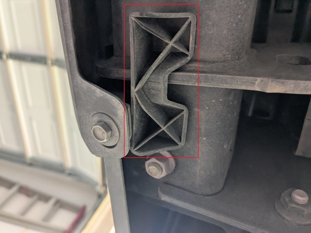

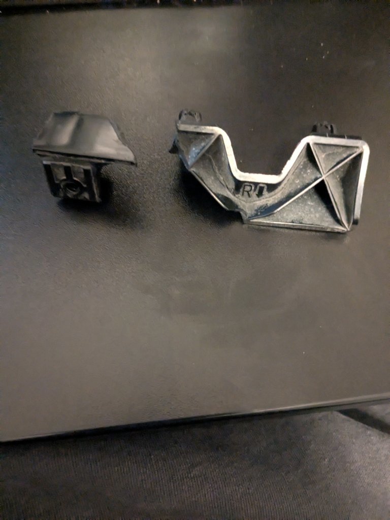

    Anyone know how to find the part# for this thing? Stupid me backed over a concrete embankment and cracked/broke this this piece. It appears to snap into the frame and give the bumper trim a screw hole to attach.
    Good one and broken one below
    Any help greatly appreciated

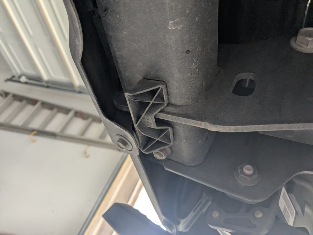

    Couple more pics for clarity.
    Good part:
    Gives this trim an attachment to frame.

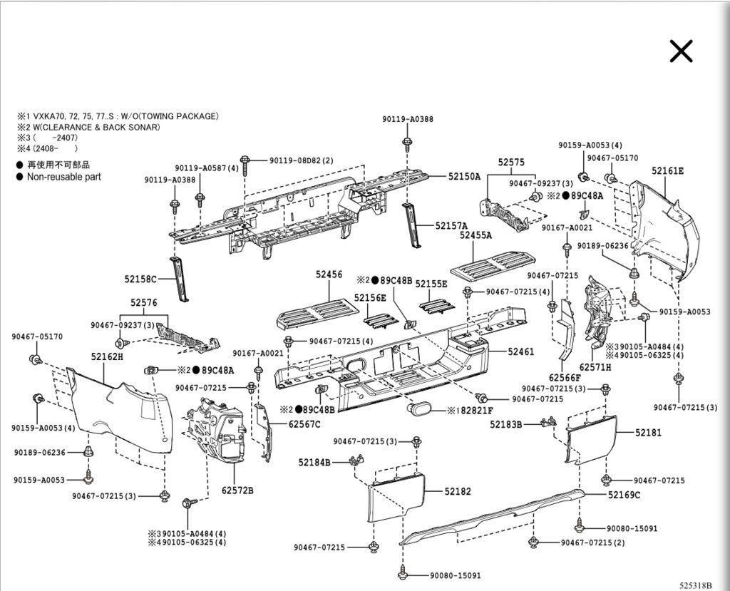

    Please confirm with other comments.
    From this drawing looks like
    52183B and comes up as
    52183-0C020

    Thank you so much @Siblue
