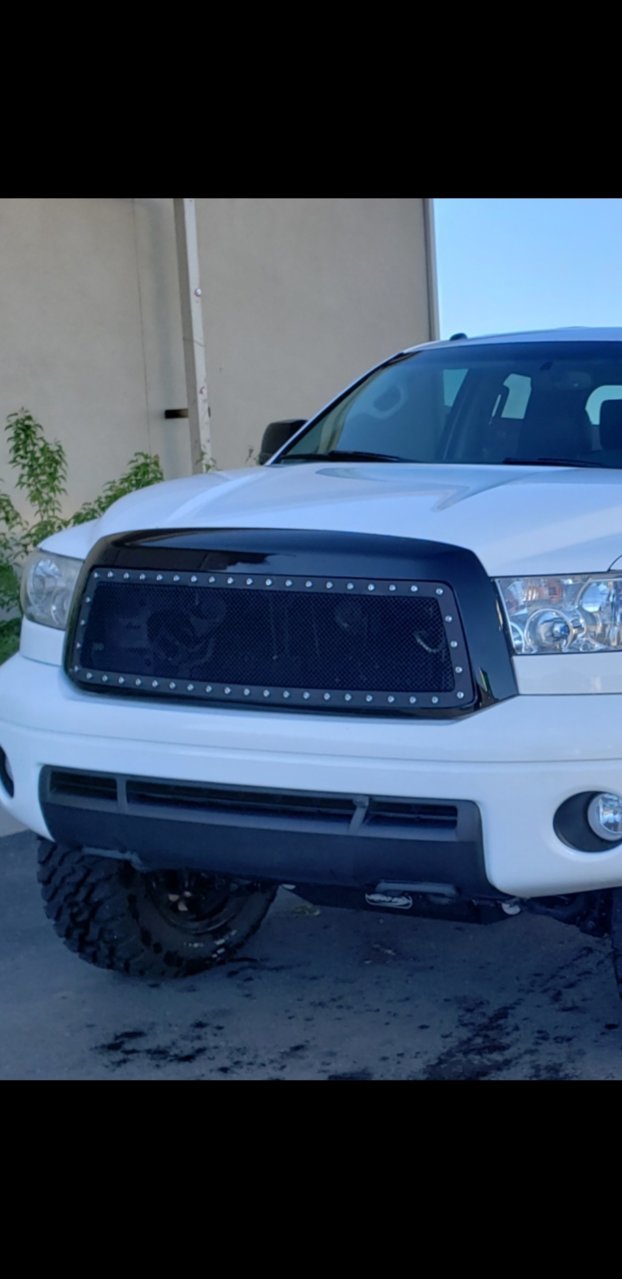

    I'm wanting to paint the black surround on my grille white. Can someone help me with the proper steps. I was going to get 2000 sand paper, etching primer (grey or white), and then a gloss white top coat. I was thinking dupli for primer and paint. But if anyone as any advice, I'd really appreciate it!
