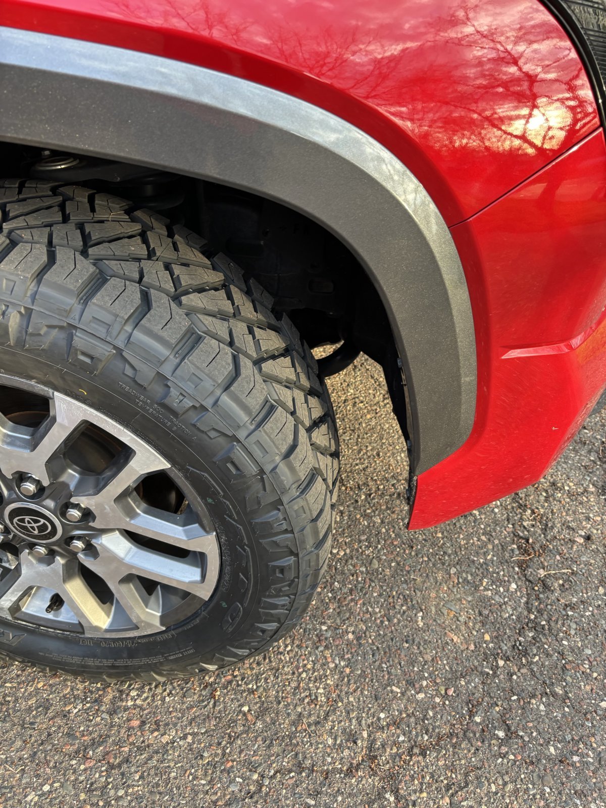

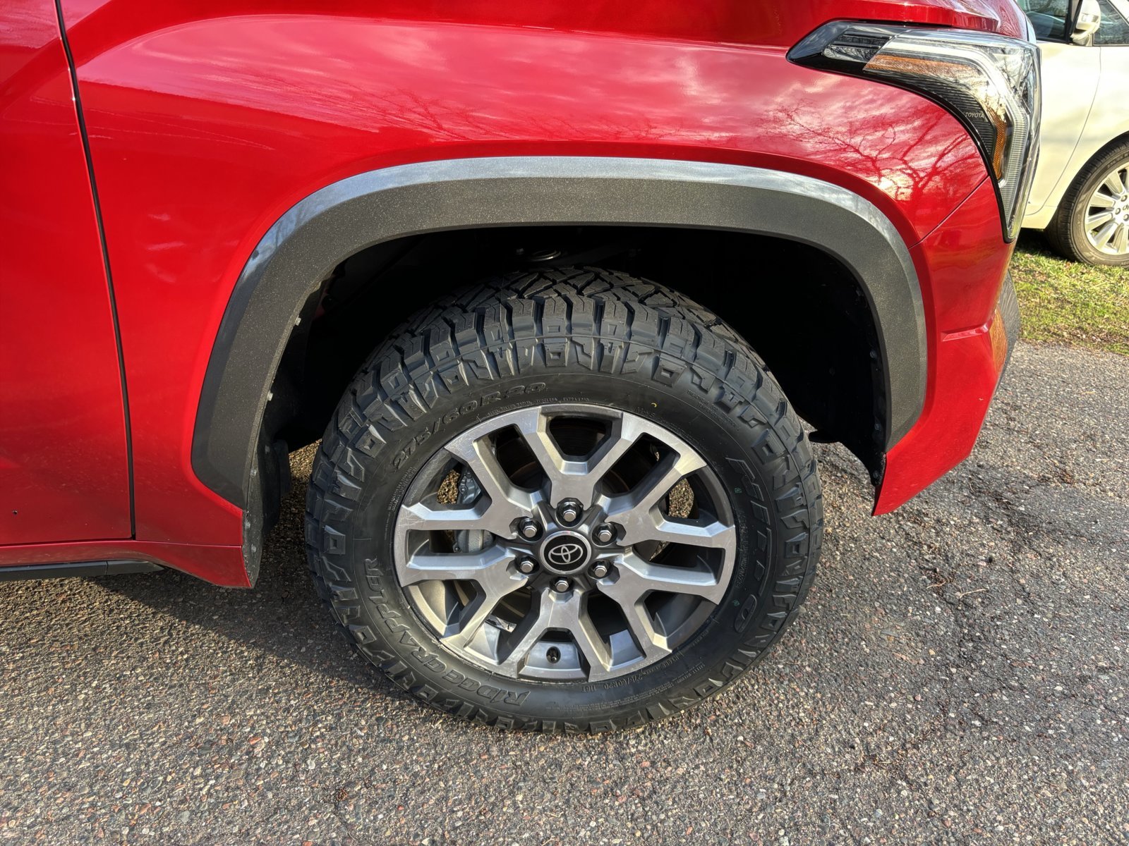

    Went to Discount Tire and bought Ridge Grapplers XL series not E. 275/60/20 . One size larger than stock 265 that were on there since new 16K ago. Now the drivers side is rubbing in the front plastic carpet stuff. Passenger side is not? Do I just stick a 2x4 in that space and bend it in? Thanks for any help. Peace. DIMG_9584.jpgIMG_9585.jpgIMG_9586.jpgIMG_9587.jpgIMG_9588.jpgIMG_9584.jpg IMG_9585.jpg IMG_9586.jpg IMG_9587.jpg IMG_9588.jpg

    We're the old tire wearing out evenly? No alignment expert but both side should be about the same. Tundra and probably a lot of other vehicles are aligned that great at the factory. Mine was off and I had to have it redone when it was brand new. Either get the alignment looked at of bend the plastic with a heat gun.

    i read somewhere that there is a bracket behind that trim and that you can bend the bracket back to give more clearance. I am not sure what you have to remove to get to that bracket.

    Yeah heat gun.
